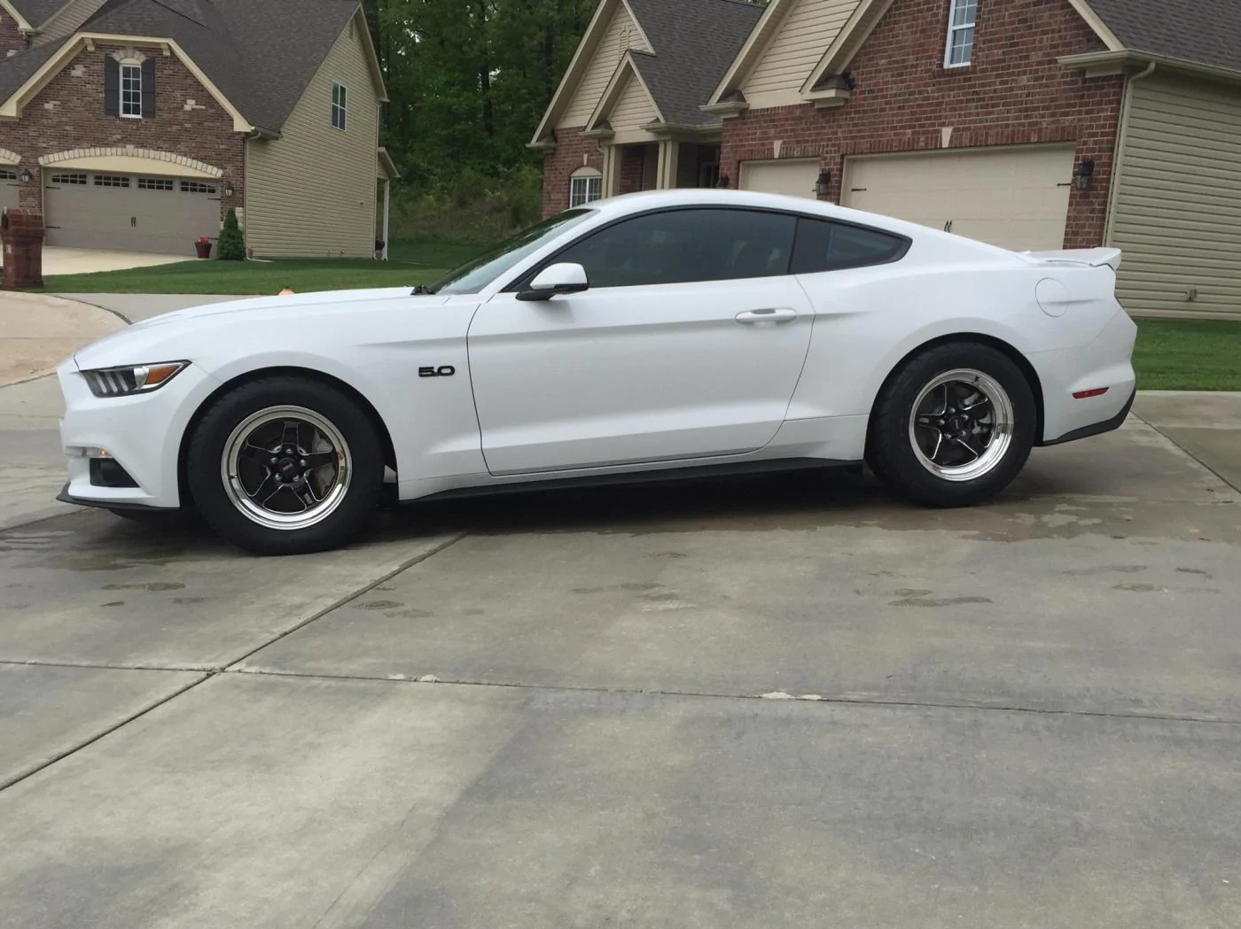

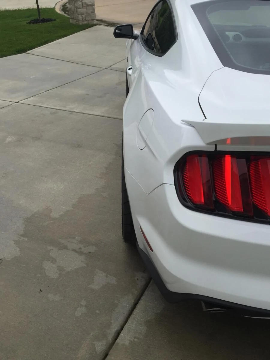

I run F19x10 R19x11 MMR 350s with a rear 320/30/19. Huge tire, lots of patch and traction.

Everyone says you have to have slicks, well no one likes driving on the street on slicks. You can get away fine with a DR, just slip the clutch a bit and don't dump it, that's how all these guys break stuff. I've been fine for ever with mine, granted its a 12 but still. Used pros, SS's, and M&H. M&H are the best for the street imo, hook great and have a decent bit of tread, I've been in the rain a few times no issues, granted I go slow and am safe..but still
