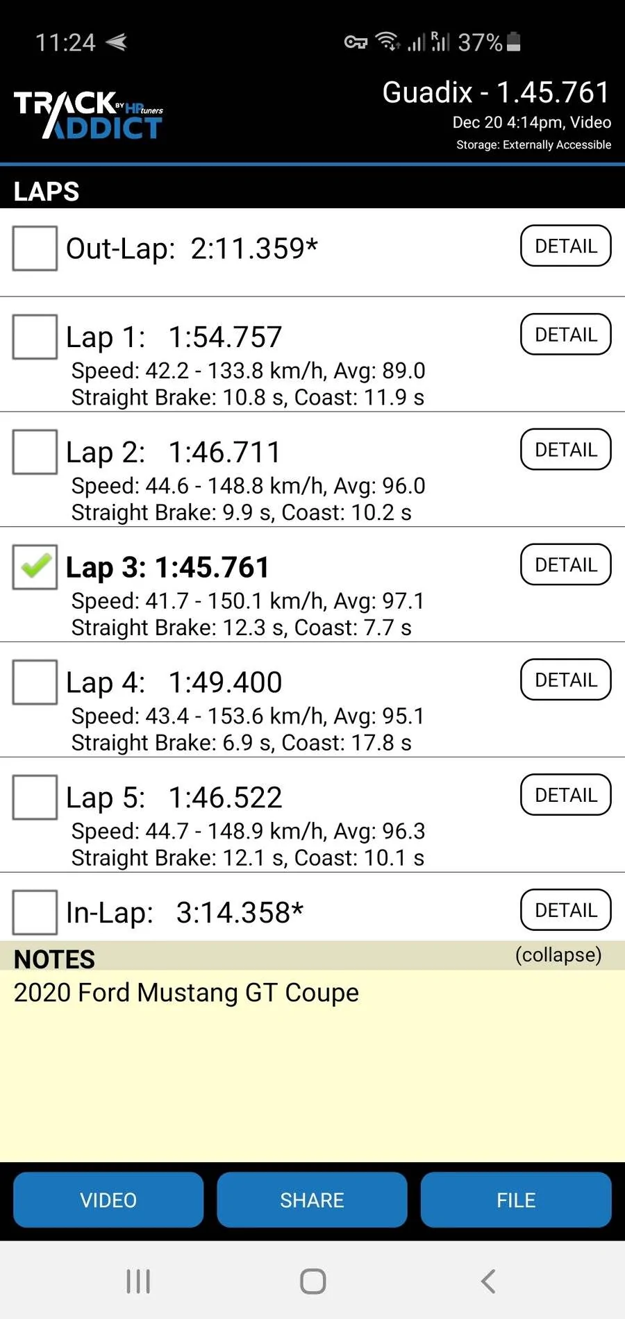

The track video referenced is what is my best lap according to the app. Not sure if it's possible to suggest any improvements based on how poorly I had mounted my camera/phone?

Your data indicates that the amount of time spent coasting is a fairly strong indicator of lap time. Note also that your fastest lap did not include your highest speed.
