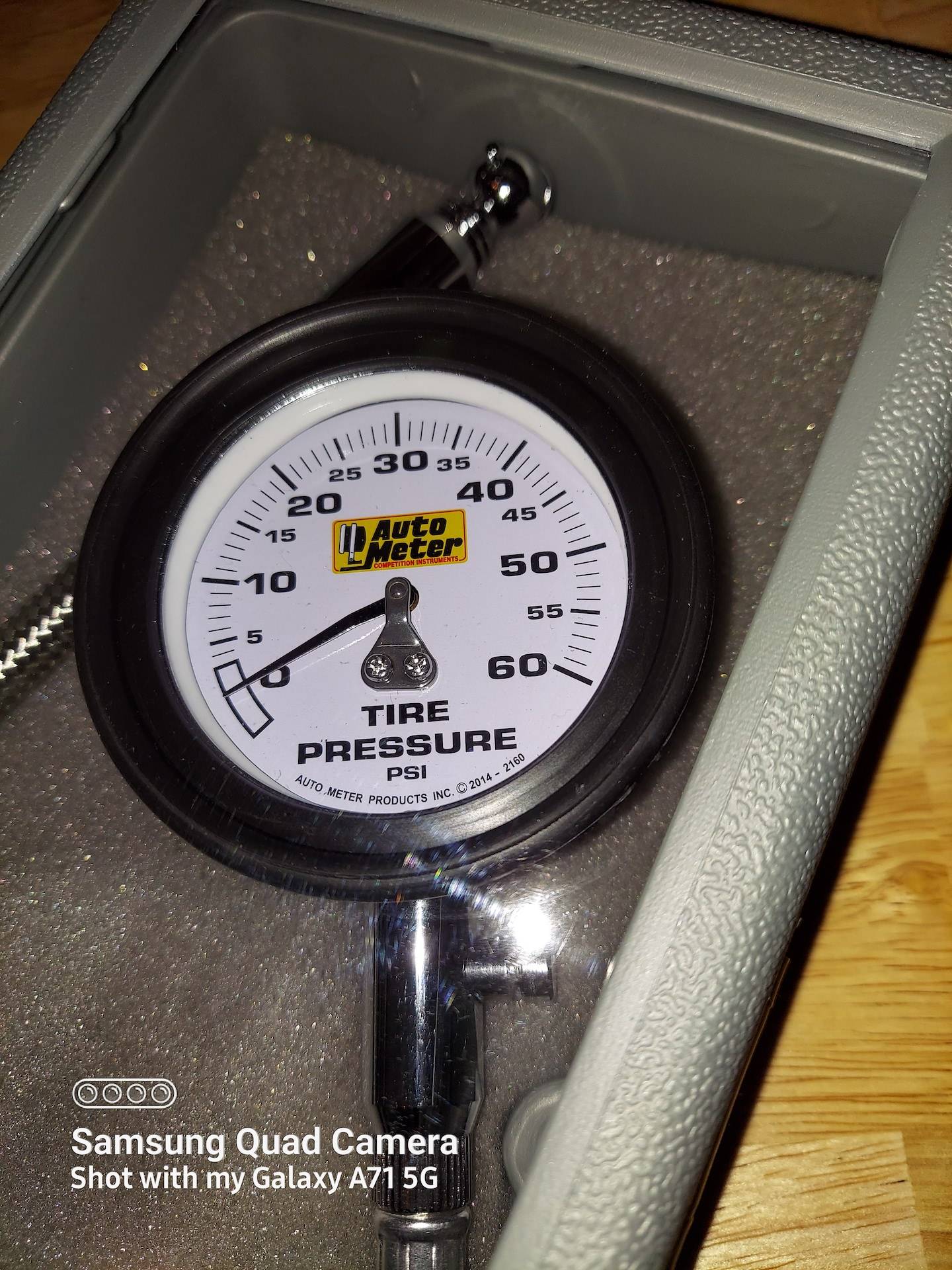

They don't correlate at all to the readings I get with my cheap pressure gauge,
Before Skye, I'd used a like gauge for many years.
With the new car and readings I was getting, I began to question the old gauge.
I splurged, buying an Autometer 2160. The result? TPMS and Autometer mirrored one another.
The 2160 is a great gauge; there are several other like gauges in the same class.
Treat yourself and the car to something nice. :sunglasses:
If tires are checked, I do so in the AM, before driving. Once driving, TPMS then mirrors the Autometer readings within the first 100 yards of movement. I have seen Ford references that, once in motion, it can take up to two minutes for all TPMS sensors to wake up and report readings to the car.
The Ford Pass app does not necessarily report real time info. The app will often display a time as to when those readings were last drawn from the car. Even swiping to update the app, I often see results that say, "information ## minutes old.", or something to that effect.
In my readings, I have confirmed TPMS, the car and the pass app round up/dn, by 1/2 psi. For example, setting the tires at 33.5 with the gauge will display 34 in the car. The car and apps only report in whole psi increments.
