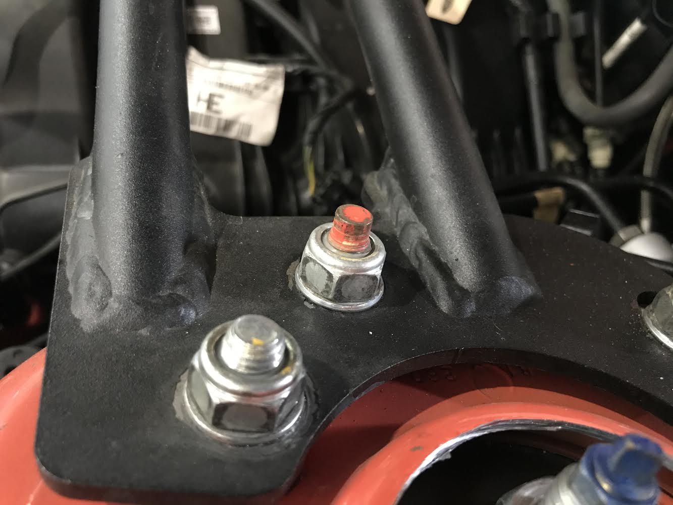

I am still having issues with these things staying torqued down. I applied blue loctite the other day and after driving a couple days, had to retorque again today all but the original factory nuts with no nylon. I got fed up so went to ace hardware and picked up some new nuts and washers to replace the nylon insert nuts. I put them on and torqued them down and will see how it does. It it comes loose again I think it more than likely has something to do with both the Steeda spacers and my Pedder's strut mount studs in combination, which will lead me to remove the Steeda strut tower brace unfortunately

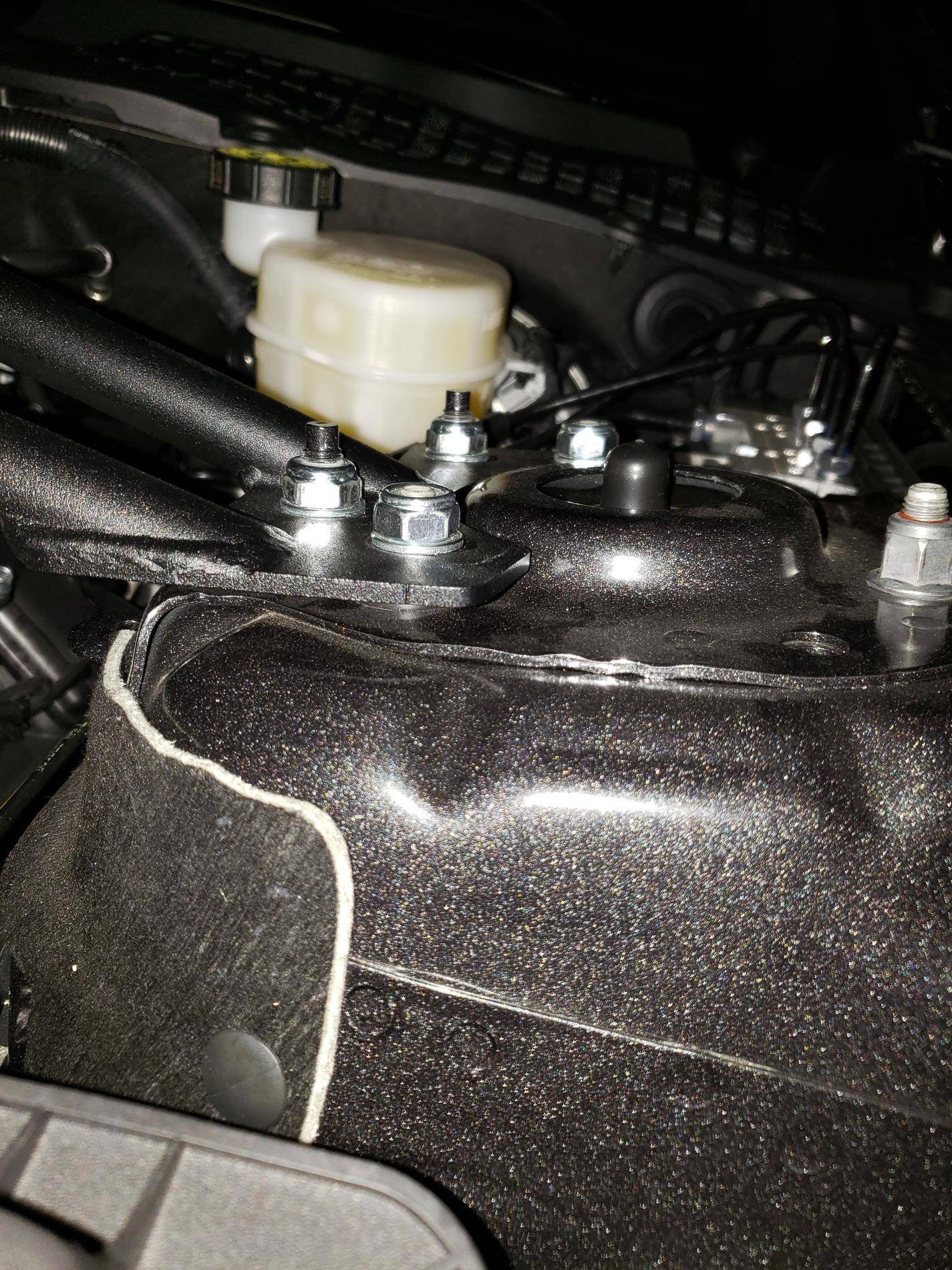

Same here. The nuts on the strut bolts won't stay tight no matter what. I literally have to go in and re-torque them each time the car is driven. I've sent a PM to TJ, an email to my sales person and left a not so great review for the bar on Steeda's website. I have received ZERO responses on all fronts. There are numerous users having the same exact issue.

Here is the Steeda unit on one of our spec cars - As you can see with the attached Steeda Camber plates and the STB there is plenty of engagement.
If there is a combo of parts being used and the studs are not long enough for a strut tower brace then there is the potential issue.
Send me your contact info - I am having our sales professionals address each issue.
We are able to send both of you custom spacers and nuts in billet machined aluminum - our engineering team is confident that will eliminate the issues that are being experience.
TJ
PM sent, thanks. I believe the billet spacers will solve the issue

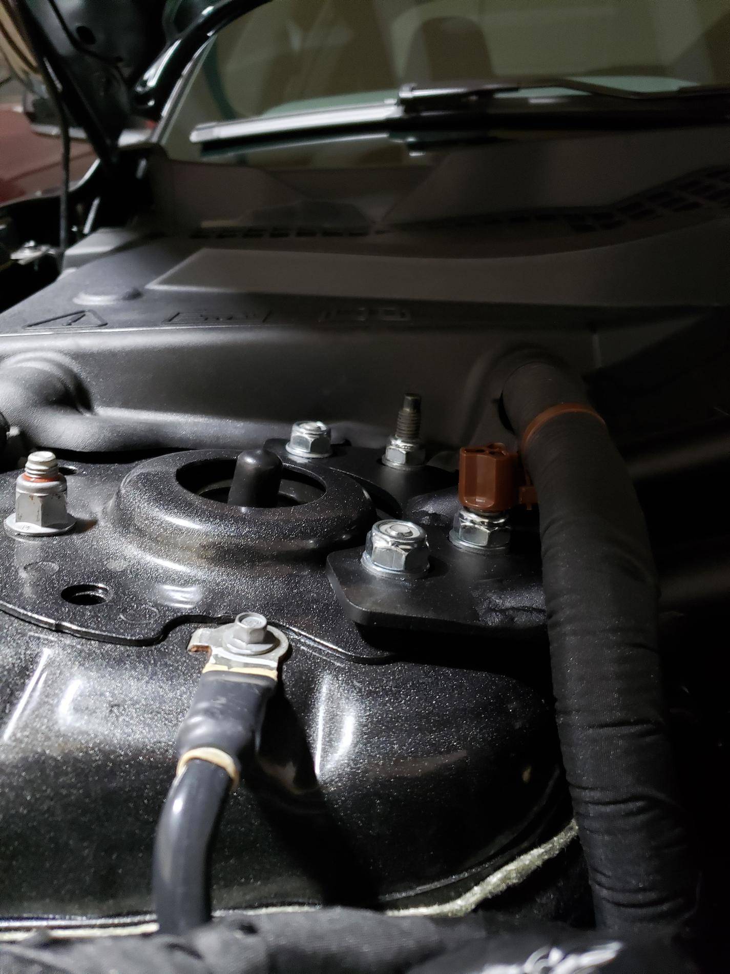

I believe that is the issue. There is not enough thread engagement on the strut bolts which is why the nuts kept stripping. I am not using any aftermarket strut mounts but do have Steeda springs and dampers installed using the OEM strut mounts.

After speaking with Mike@Steeda they seem to think that replacing the delrin spacers with aluminum units will correct the issue. They are sending me a set. I also forwarded him pictures showing all the mounting. I am using OEM strut mounts with Steeda springs and dampers. That was one of the questions he asked.

steeda just called me and is shipping out the new spacers and nuts tomorrow morning, and i will be sending the old ones back so they can evaluate. i think the new hardware will fix the problem. awesome customer service!
