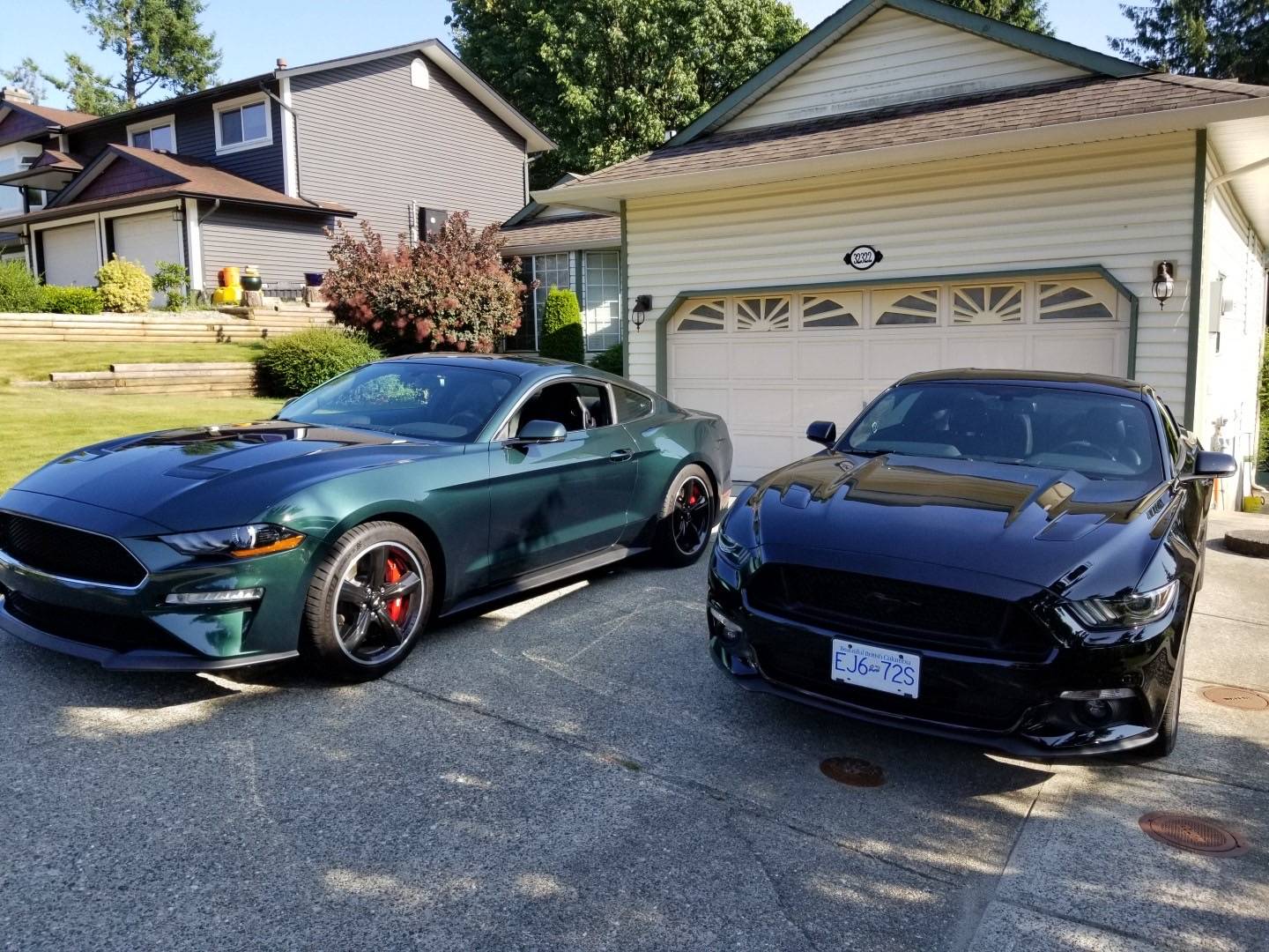

I would like to know who uses what to get that deep glossy glassy slick beautiful look on their cars. Mine are ceramic pro covered and I use ceramic pro sport occasionally.

I look at cars that have had the ceramic coat applied, i.e. Opti-coat, CarPro, etc. and IMO they look like someone applied a sheet of Saran Wrap on them. Doesn't look natural, shiney? Yes, but not like cars that have had the paint corrected, polished, waxed, glazed and sealed. But that is just me.
