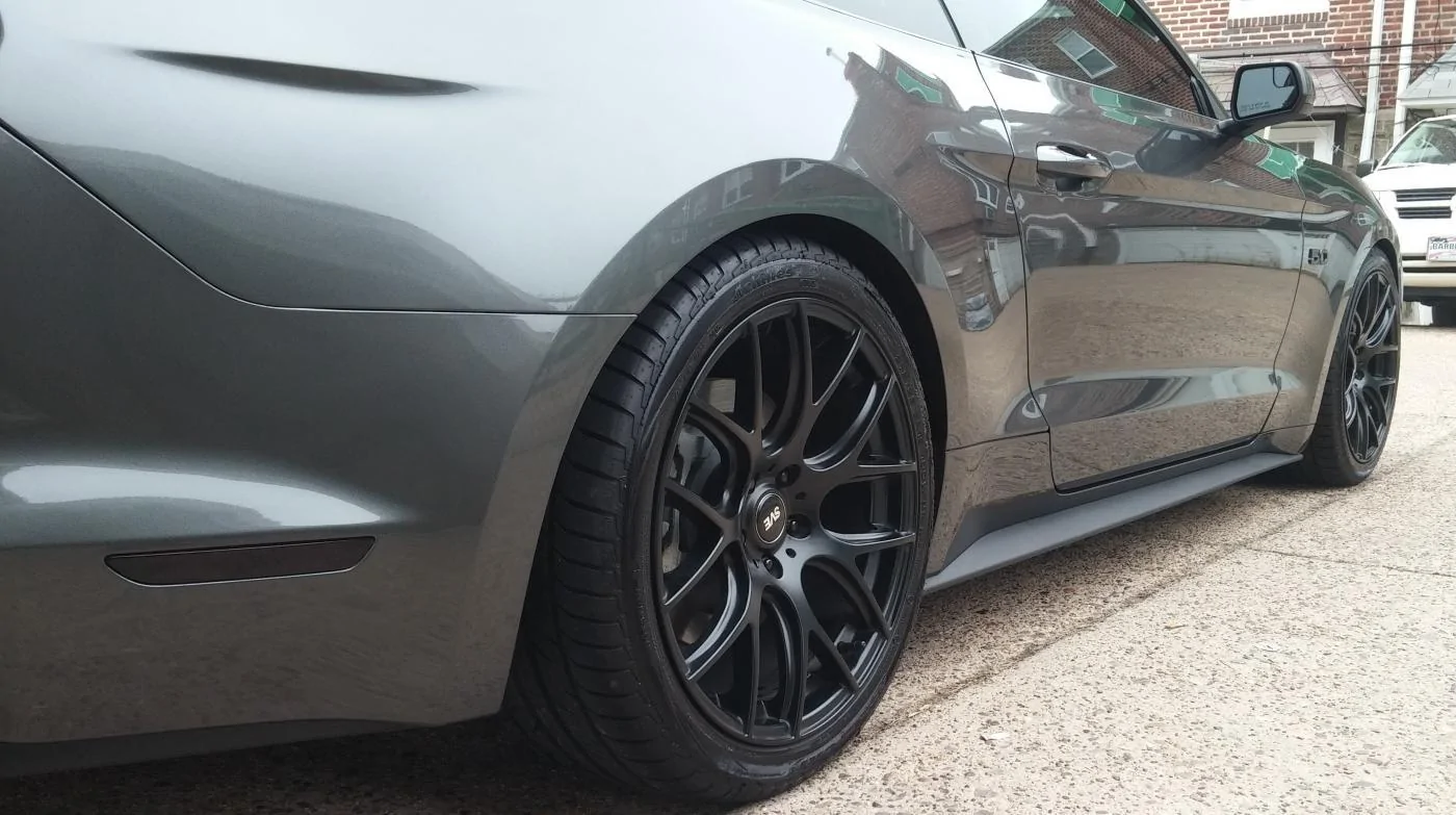

if its your daily and you like rotating your rubber id go square.. im squared 19x9.5 all around with 275/35 tires. and i love the way it handles, ive had many cars with staggered set ups and squared will handle better every time .. think im gunna bump my tires up a notch when these go .. maybe a 285.
just my opinion

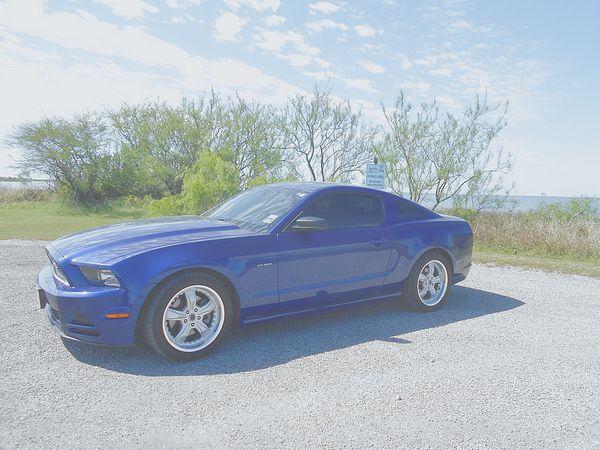

I run a square setup for the twisty's an track. I also fit 18x9+ as my Cyclone was limited to 275/40/18 so I'll buy 18x10 or 9 1/2" so I can fit 285/40/18" and I use 18" wheels to get the most out of my 3.55:1 gear. If I was looking for a sexy ride i'd run a "Staggerd" setup. Also for 1/4 mile racing as stated before. Here's my Cyclone on 275/40/18's. Vossen and other's need to continue to build 18" wheels!!!!!

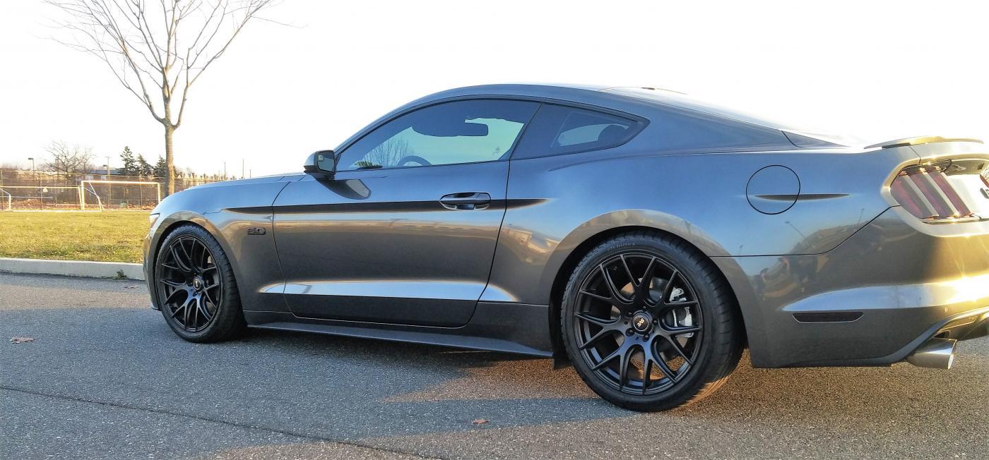

my set up and im lowered on cjpp springs
