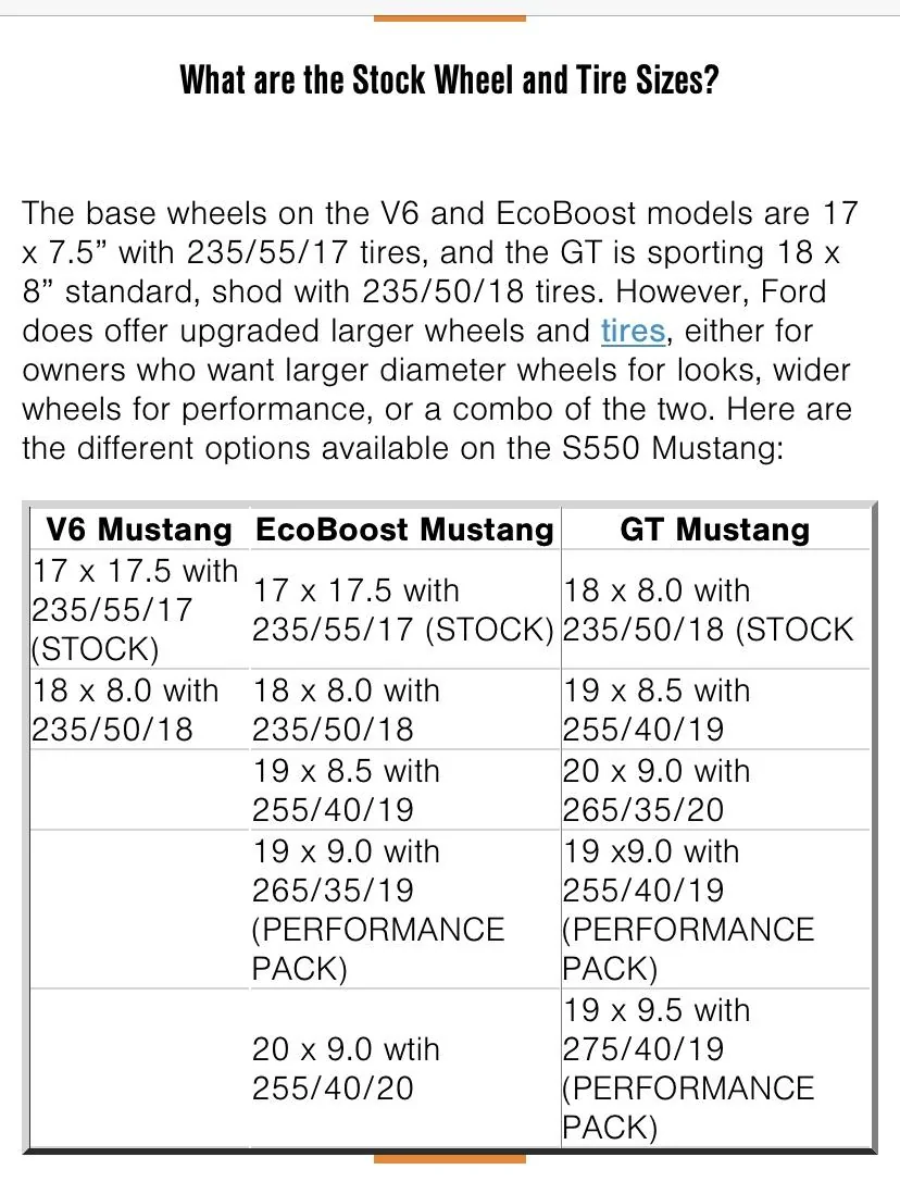

EDIT: correcting info
Here’s stock tire sizes for reference
From AM’s website:

If you take the time to open the drivers side door and look at the tag for tire sizes and pressure it will tell you what came on that car factory. The only Mustang setup to come with a staggered setup to my knowledge in recent years is the 13/14 GT500. 07-09 had a staggered setup but on the size sizes rims. I am not familiar with 10-12 GT500 as I do not like those years in any model of Mustang.

She didn't do anything wrong or make any mistake, the dealership did. She has just been driving a little slower than she thought she was for a while. Tell her you noticed the dealership put on the wrong tires. Go back to the dealership and tell them you want them to move those tires to the 9" front rims and give you a matching pair of the correct size 275/40R19 tires to go on the 9.5" rear rims at a substantial discount.

The 255/40/19 have a diam. Of 27” and a side wall of 4”......the 275/40/19 have a diam. Of 27.7 and a side wall of 4.3”.
Is it dangerous-no
Will it have an impact on the speedo- probably not enough to even notice.
The only thing she might notice is the ride will be slightly rougher because of the smaller side wall.
Personally I’d take it back and raise hell until they replaced the tires with the proper size.
