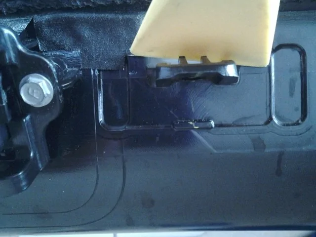

  • Yes, use 2-3 plastic body panel tools. Use 1 or 2 to pry and keep the upper edge of the panel away from the trunk while using another tool to pop the clip loose.
  • BUT - you cannot simply use the twisting motion shown by CJ Bill. Instead center the tool directly on the clip, and then simply push it straight into the clip. The tool will depress the spring tabs to get the clip to release from the trunk. This is especially important for the two inner tabs, i.e. the ones closest to the backup camera.

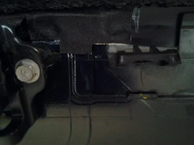

The first photo shows distortion of the clip slots in the body that arise from using the CJ video “twist” or other prying techniques. Notice how the prying technique has caused the spring tabs to bend the thin body metal outward in the center of the slots. The second photo shows the clip with two spring tabs. The next photo shows the proper location of the body tool. In summary, do not pry out with the tool; push it straight into the clip.

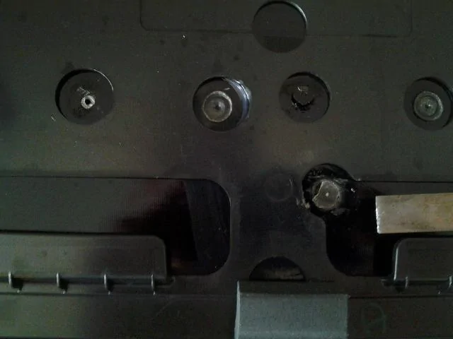

The GT badge aligns to the panel with 4 indexing pins. To remove the badge from the panel, I simply used a 1/2" chisel flipped over backwards (to get a high-angle access to the pins). Then I gently tapped the chisel with a lightweight hammer so as to chisel off the plastic flared ends. See the chisel in the lower right working on one of the pins. The upper left pin is complete – notice its diameter is only 4mm.
If I return to stock with the original badge, I will drill into the center of each pin, and use a small self-tapping screw with oversized washer to hold it back on.
