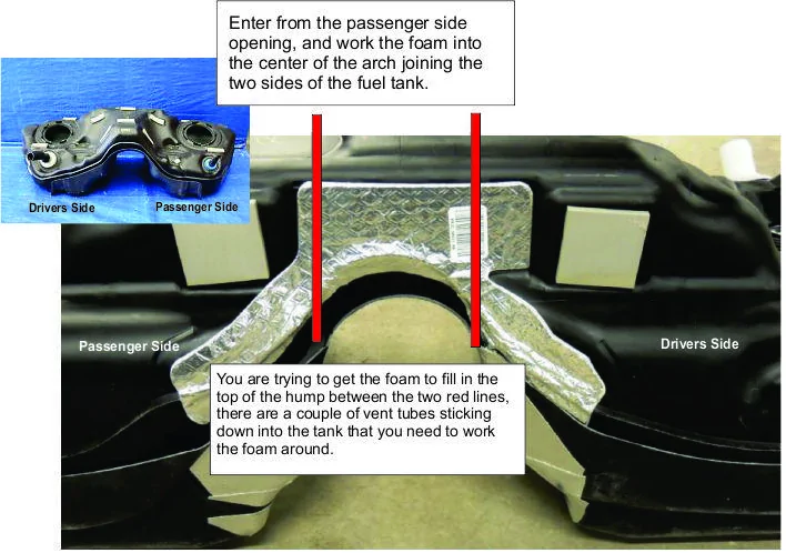

Maybe a picture will help, I only had pics on the web to work with but maybe this will give you guys a better idea of what you are trying to do.
I will warn you, fuel cell foam can degrade over time and depending on the type of fuel used may need to be replaced sooner. Most foam is rated to last 5 years or so but many run it longer without issue. when it starts to degrade it will clog the fuel pickup filter at the pump and require a thorough cleaning to remove all the little pieces and a new piece of foam.

Thank you, Dave! Any decrease in fuel capacity with adding the block of foam? Also, have you had and experience using the foam with E85?
I have not used the foam with E85, capacity will not really change much maybe a 1/8 or 1/16th of a gallon. In Fuel cells they are usually completely full of the foam material top to bottom.
