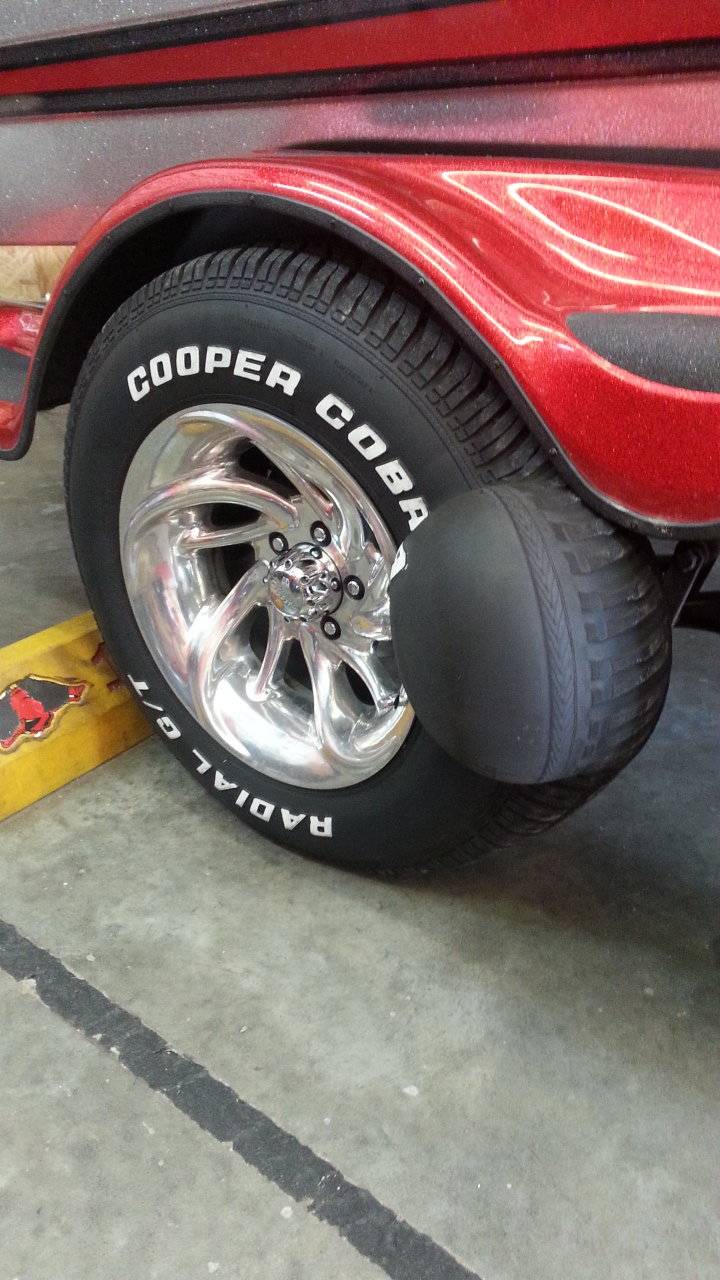

Like others have said, and you, its no good and will only get worse. Been there with my boat trailer.
