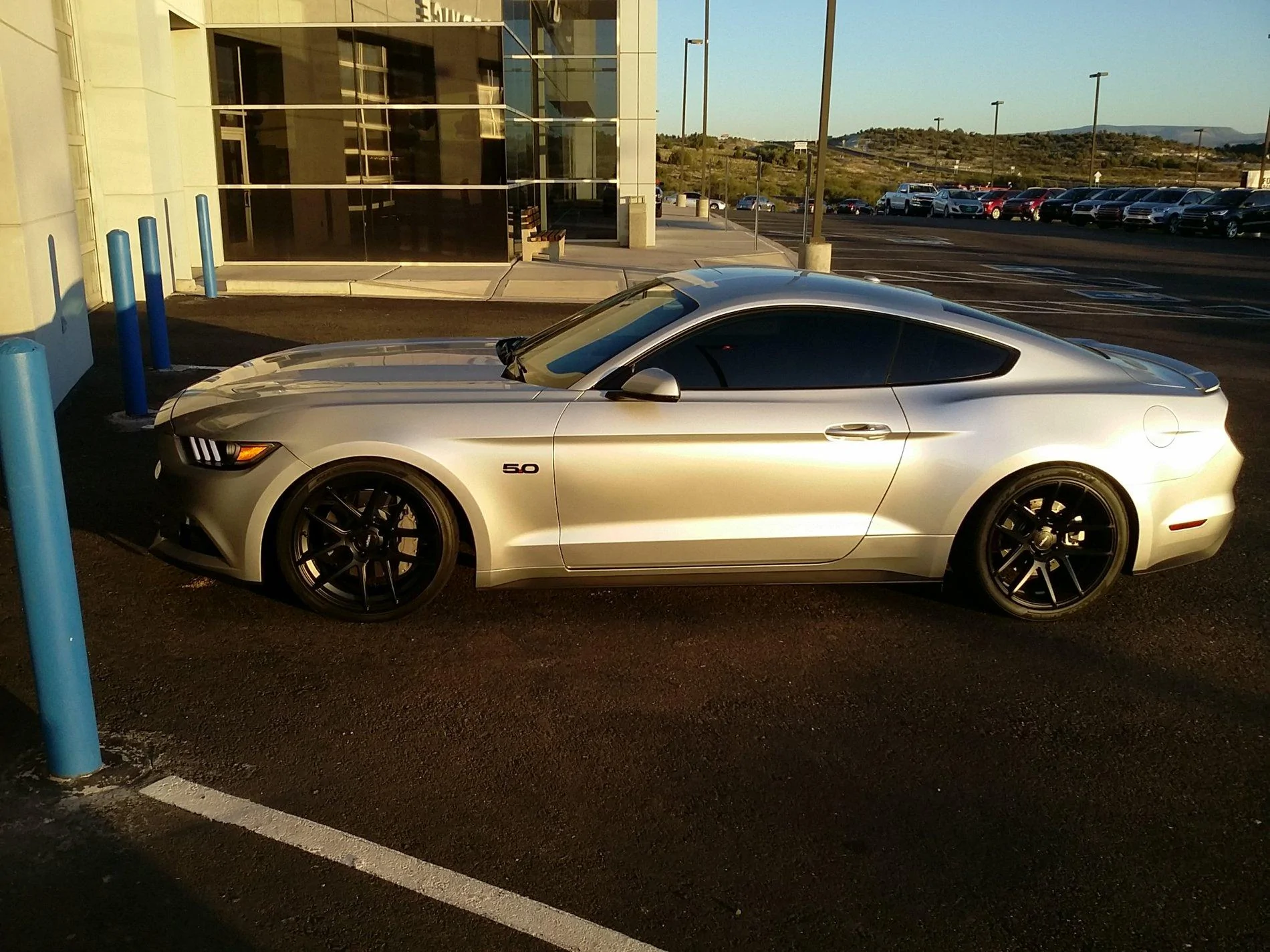

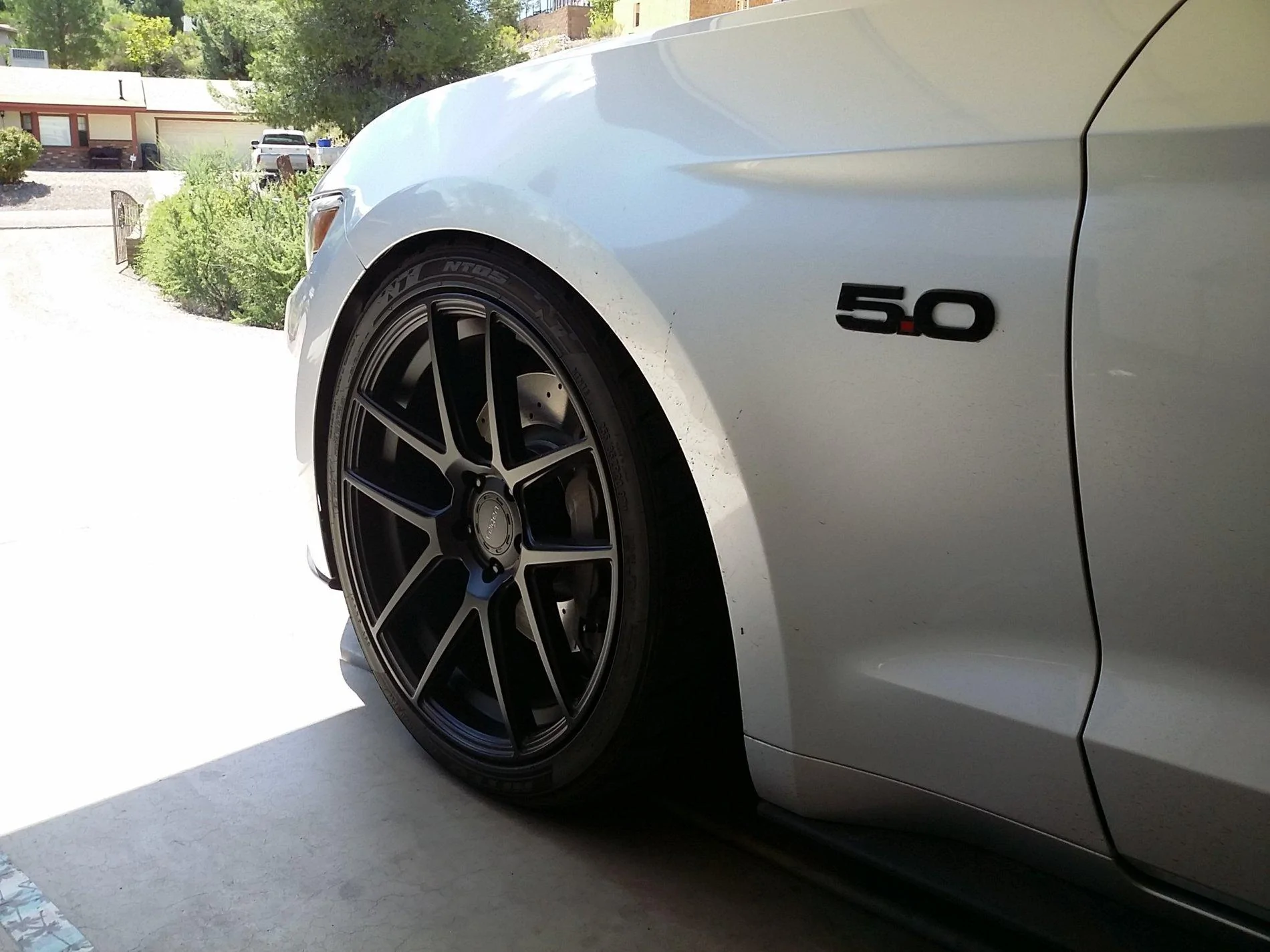

Similar set up , just have to watch the off set . My set up front 20x9 35 et 255/35/20 rears 20x10.5 et 45 305/30/20 . Lowered on eibach sport lines about 1.5 inch . Front camber/caster plates with alignment set to spec , no rubs

Should get you where you want to be , I'm just not a fan of wheel spacers . Post a pic when you get it done

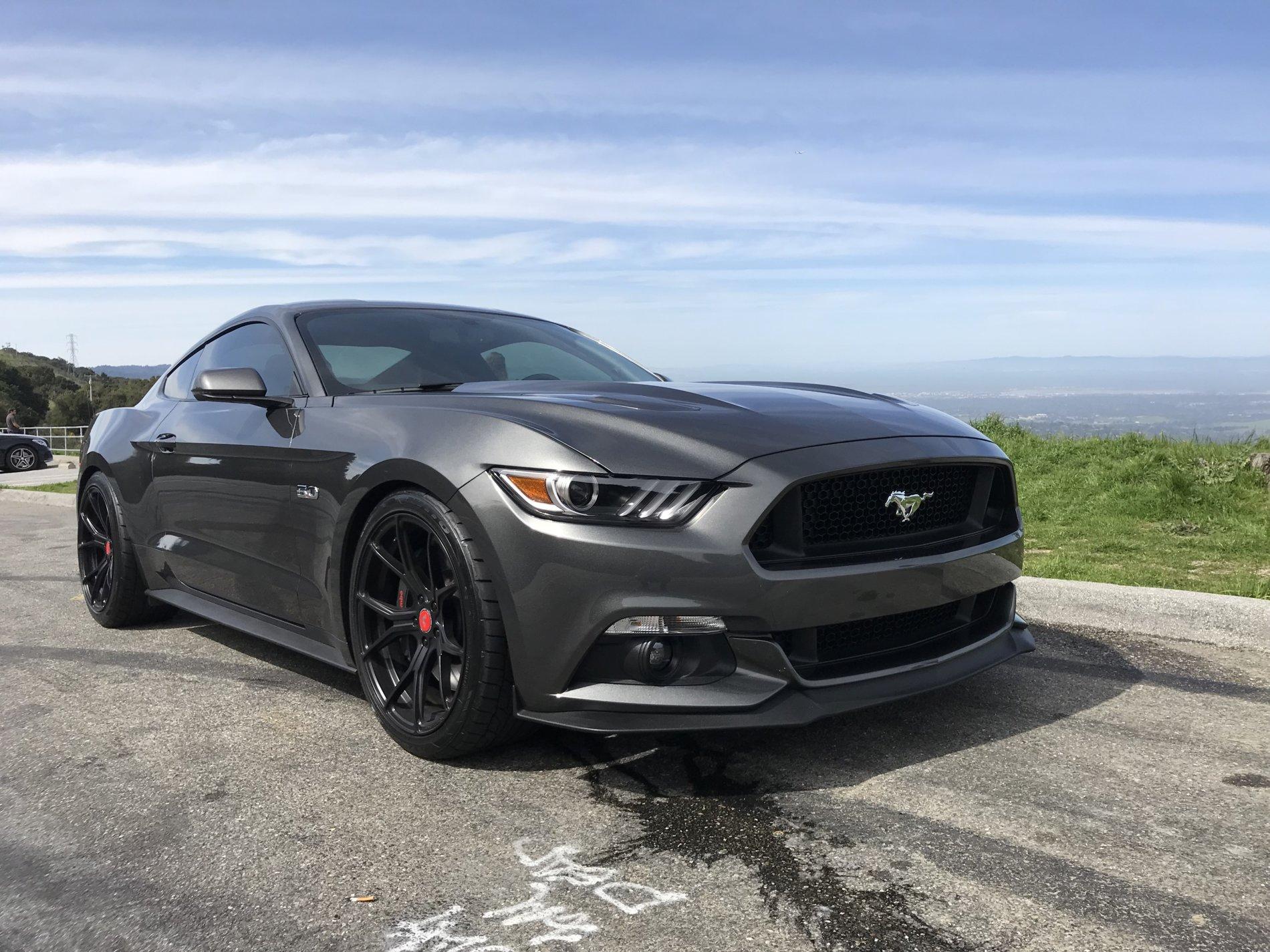

Those are my exact tire sizes but I am running 20x10 up front and 20x11 in the rear. I am on an Eibach Pro-Kit. 1" drop. No Spacers. No Camber plates, atleast not yet. After getting the initial alignment done, I have had it checked twice since and still where Eibach recommended.

I just got my 20x10 F and 20x11 R Project 6GR's and ordered some Continental DWS06 in 315/35 for the Rear and 275/35. I did a lot of looking at tire sizes on Fitment Inc. You should have zero issues running a 305 in the rear.
