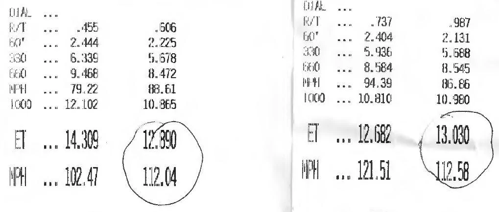

I decided to take the car to the drag strip a couple of months ago (a first for me and the car) for a torture test. I figured if it can't handle 1/4 mile runs on a warm day, then it won't last a track day. Ambient temperature was in the upper 90's, ran 8 runs back to back (except for a break in the middle to get food from a food truck), and the charge temp was almost 150 degrees at the starting line because I was running the A/C between runs (I even forgot to turn it off for a run, didn't really feel any difference). I think the DA was over 4K.
I was on street tires (285/40/19 Cont ExtremeContact Sport) and it was spinning until the middle of the 3rd gear on launch before it got traction. Below shows two runs, one with the best ET and the other with the best trap speed. I haven't weighed the car, but there's about 200 lbs worth of weight reduction mods and I weigh about 200lbs, so I'll call that even. So using the weight of 3600 and trap speed of 112.58 MPH, the HP estimator shows 400.9 HP. Does it sound about right?
I dynoed the car once over a year ago on a Mustang dyno and it showed 357.6 WHP WCF. I only semi-major mods since the dyno run were swapping to catless DP (from catted 3" DP) and balance shift delete.

IDK about the ho but she has some more in her. Better launch and less spin and you should be able to hit mid 12's. You going back anytime soon? I'm hoping to make it out next month

Pretty good runs for a stupid hot day. Get that sixty down. And run it on a nice cool fall day. And you'll be on to something.

Thanks! What kind of sixty I should be looking for on the street tires?
Prob a 1.9xx. That should be doable, you have a manual though right? Gonna be a little harder for you. Don't worry I still haven't been able to do that and I have an auto. There is definite art to launching a car properly

A 1.9 riding the clutch out should be doable. (Try a 1000-1, 1000-2, 1000-3) count in your head. As you ride out the clutch. Dont just mat the throttle either. Feed the throttle in at the same rate. For a solid stick shift launch.
That and a Decent drop in DA. That a cool fall day would provide. Should be worth another 2-3 10ths.
