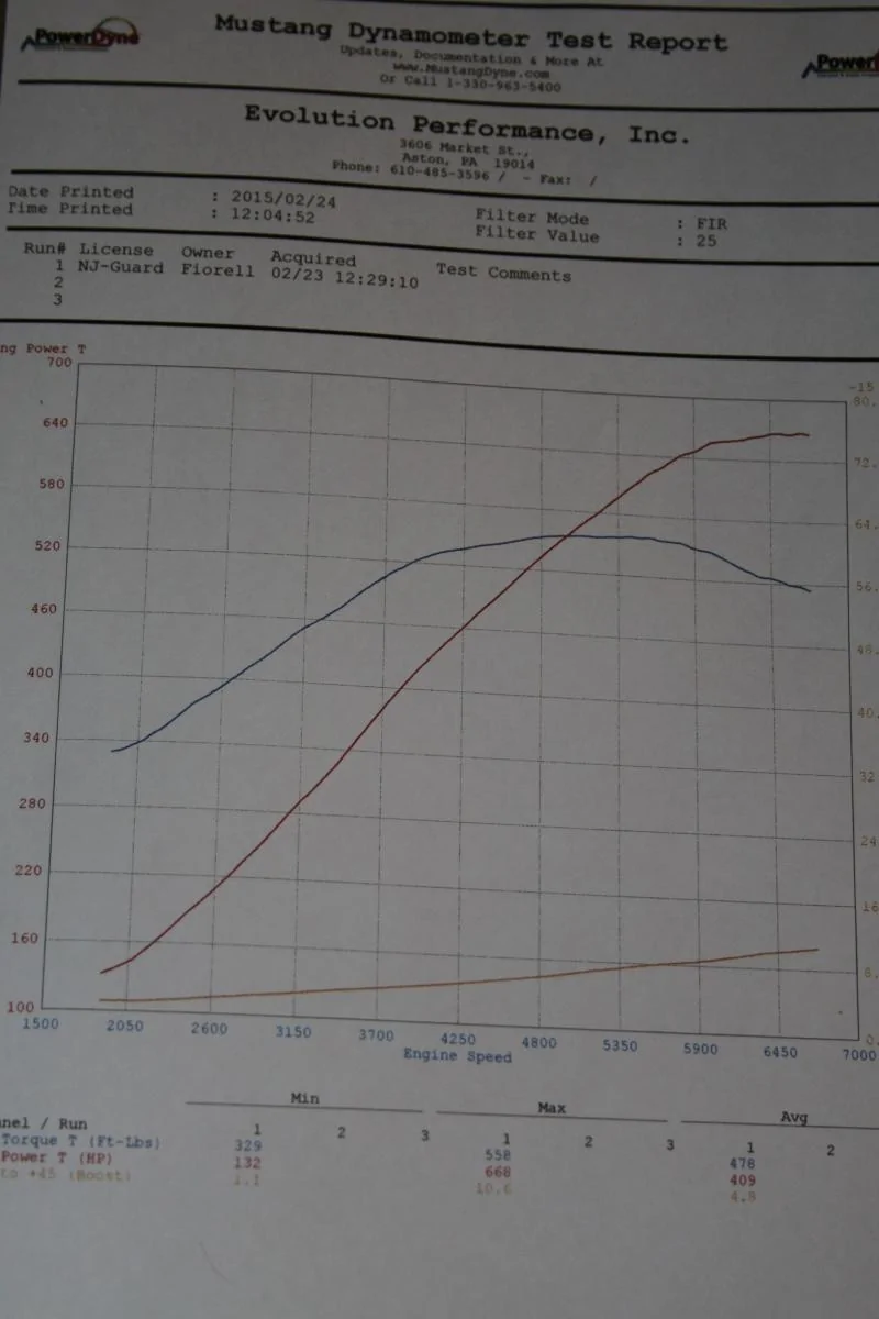

I picked up the car from Fred at Evolution Performance today. What a great job they did. Quality work done by professional technicians. The Mustang Dyno gave us 668 RWHP & 558 RWTQ. Following is all the work done by Evolution:
Baseline: The car made 379 RWHP and 357 RWTQ Stock on 93 Octane.
-Procharger HO Intercooled Tuner Kit - D 1SC -1 Black Head Unit and
Bracket,- Helical Cut Gears - 2015 Mustang GT
-LTR7IX -11- One Heat Range Colder Spark Plugs
-Injector Dynamics 1000 cc (100 lb/hr) Fuel Injectors
-PowerMaxV2 - FuelMax - Plug and Play (Single) Fuel Pump Voltage Booster
-Flash Power Program er
-170 Degree Thermostat
-Stainless Steel T-Bolt Clamps (Pack of 2 ) - Clamp Ran e: 3 .2 8 "-3 .60”
-Stainless Steel T-Bolt Clamps (Pack of 2 ) - Clamp R an ge: 3 .7 6 "-4.05”
-Stainless Steel T-Bolt Clamps (Pack of 2 ) - Clamp Ran ge: 1 .7 5 "-2 .10”
-Radiator Satin Black Paint - 12 oz C an
-Prep and Paint Air To Air Intercooler
-Voltage Booster, T-Bolt Clamps
-Eibach Spring Pro Kit
-Steeda Braided Stainless Steel Clutch Line with insulthermResin
coated fiberglass braided sleeveing
-Steeda MT-82 Transmission Mount Bushing Insert
-MGW Race Spec Shifter with Composite Pony Race Knob
-Evolution Performance Custom Catch Can for Procharger H O
-Torco Mach Series Accelerator
-John Lund Custom Dyno Tune
-Window Tint - 3 5 %

Those numbers sound great. Given a 15% loss that equates to nearly 775 HP at the crank. Yep, you may want to consider some different tires to hook that thing up. I'm doing the Roush with full ARH exhaust (off-road H pipe) to my Guard. Dropping it off Saturday. I went ahead and moved up two sizes front and rear, 275/295 with Michelin PSS but wont have them for a month which is fine because it wont stop snowing here!
