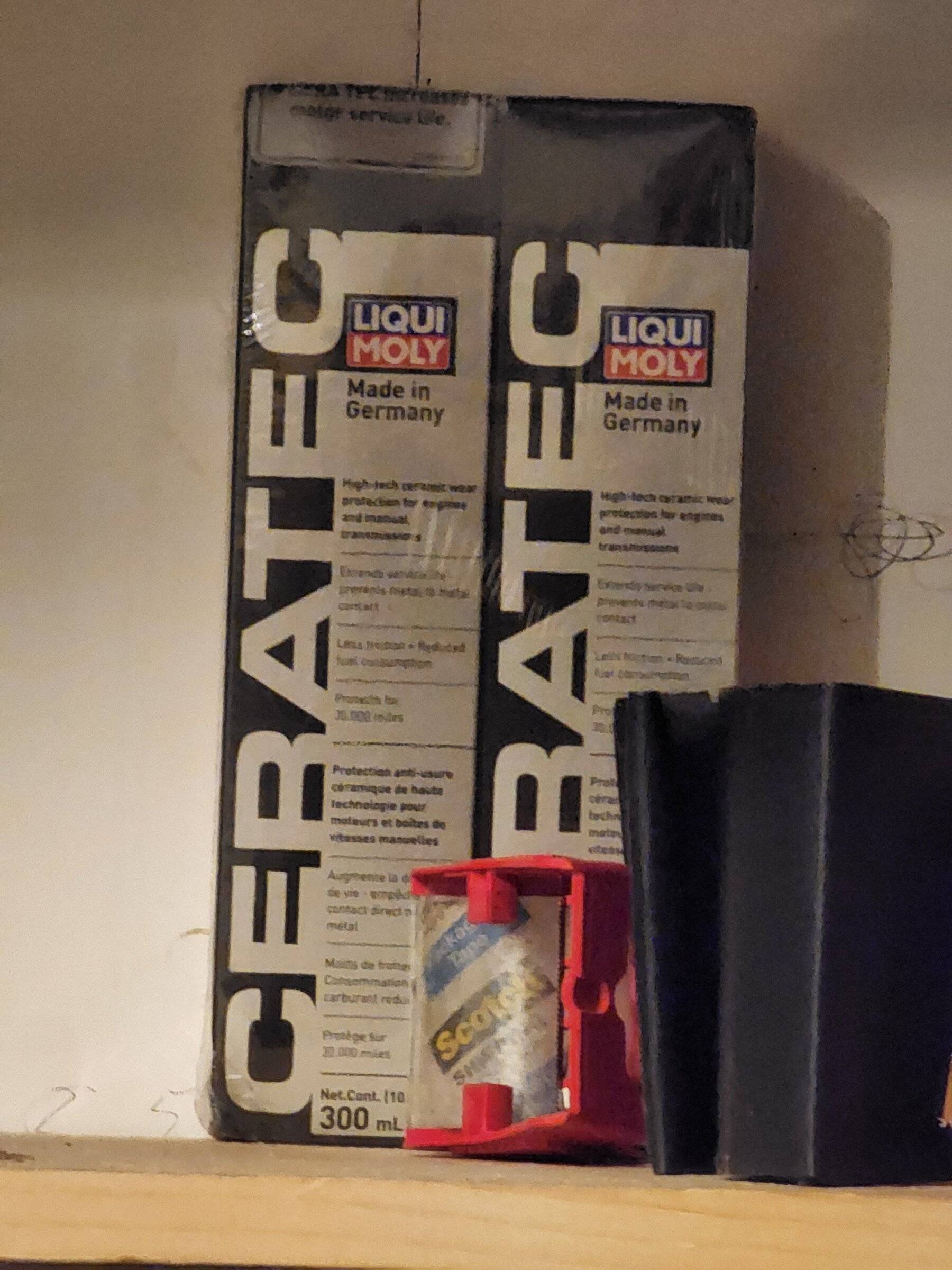

Will definitely try staying in it more and keep the revs up this morning on my way to work. I am thinking I'm going to add a Borla Switchfire to my exhaust notes. 5w 30 makes sense too on my next change.
I have some Ceratec on order and will let you know the result.

Use Pennzoil Platinum 5W30 and Liqui Moly Ceratec on every oil change.

You guys using the Ceratec, are you using one 300ml bottle or 2? The directions say one bottle will treat 5 quarts. I only used one bottle and I could tell an immediate difference, I wonder if the 2nd bottle would make an even bigger difference?

Using 1 per oil change.

I do 2 bottles, but do it every other oil change. Even that is more than needed per the directions. Doing an oil change this weekend even. Have it on the shelf waiting.
