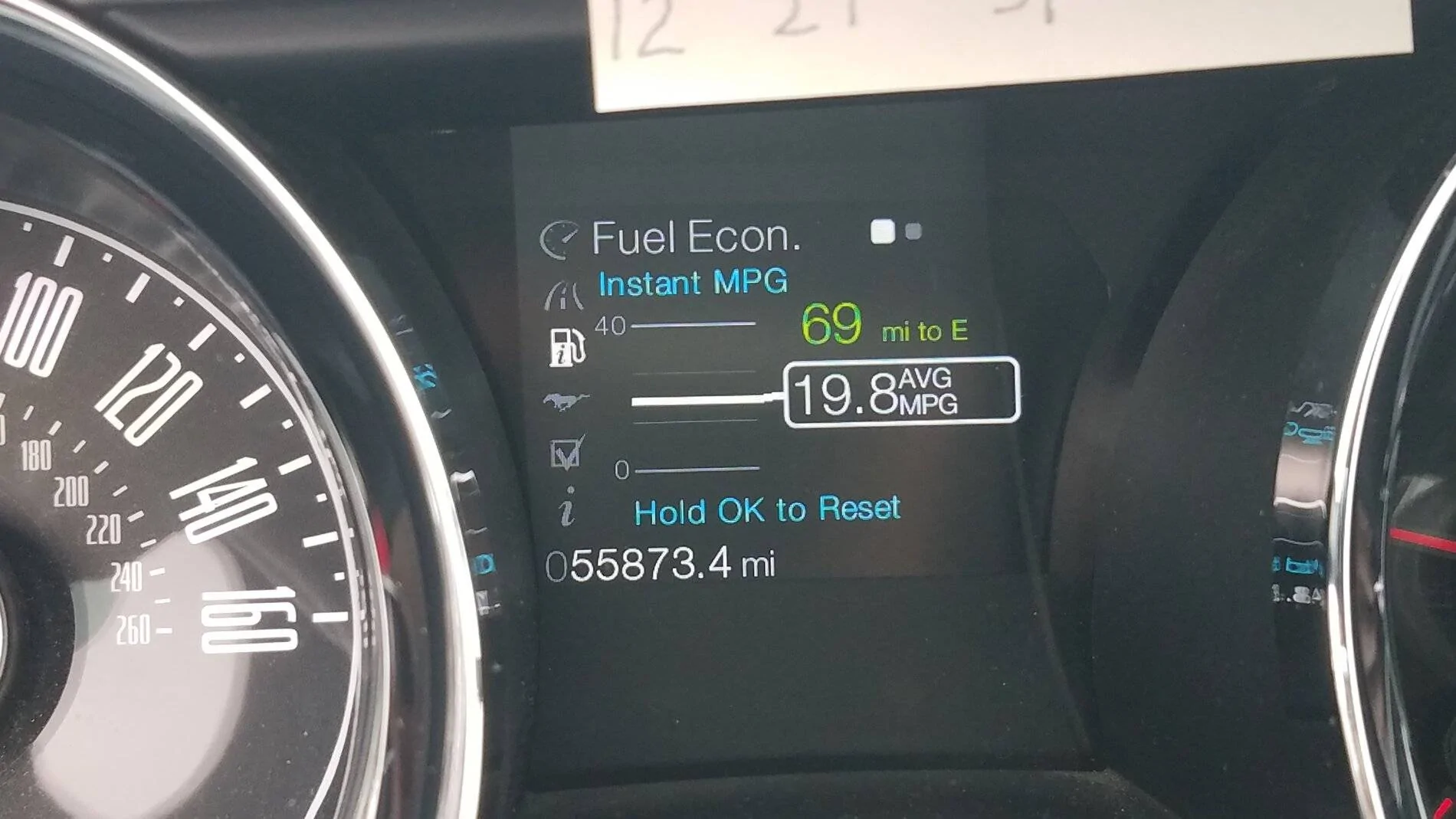

Yes a long post but very accurate, I've owned 2 Mustangs and this has been the case in both.Miles to empty is a 1). variable number the car calculates from what it 2) thinks the MPG is. Think about this for a second it implies a lot.
So lets say you have a full tank, you run the car hard, or in a poor MPG scenario (stop go traffic) for the whole tank, you are going to get shit MPG and therefore not drive a long geographic distance.
When you are near empty and you refill the car with a new full tank, it looks at your existing average MPG based on the tank you just ran down quickly in poor MPG scenario and calcs out expected miles to empty with THAT data. This makes it look like you are getting short range, but this is not reality, remember I said the Miles to empty (MTE) is variable, below is how that is.
Now with the new full tank you jump on the freeway and drive in MPG friendly scenario (flat gradient, no traffic, cruise control). As you highway cruise the MTE number will start to "hang". It will say something like MTE 180mi for a REALLY REALLY long time before it starts ticking down accurately with your burn rate. You burn the entire tank, you just drove a MUCH MUCH geographic distance than the stop go scenario and you far exceeded the MTE expectation (also your instantaneous MPG read out will be high, so will your 30 minute sample). Now you fill the car up again, this is where you will see your MTE go way up from before, because your last tank was from a good MPG scenario. You will now get an MTE readout much closer to reality and max range.

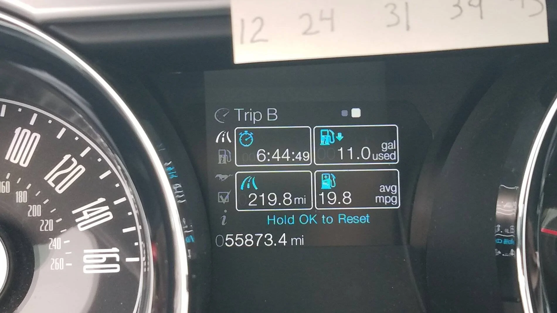

MTE is not a good way to know when you are going to run out of fuel. The trip computer is more accurate in S197s premiums then the MTE readout, it shows mileage, gallons burned, time, and MPG.
On my first S197 (which seemed to get slightly better mileage always) the trip computer would read 15.75 gallons burned when I was at empty and pushed it beyond MTE 0. I go fill up at the pump and yep, the burn amount from the trip computer is dead on! On my second car the burn rate computer is just as accurate. An interesting note. I will get to 0 MTE, and always I will have 1 gallon left to burn (based on burn rate trip computer and verified repeatedly at the refill pump many times).
bottom line you want to known how much gas you have burned use the trip computer, its more accurate than MTE. Burn rate works no matter the amount of gas started in tank. I have done it full tanks, half tanks, quarter. The burn rates are calculated accurately always. That is your best source for consumption data which you can infer expected range left regardless of what the MTE reading is.
Ok this post got long, and perhaps a little complicated but now you have a lot of info to work with and a fun experiment to run. I think Mike Pfeifer and I are trying to express the same thing.
