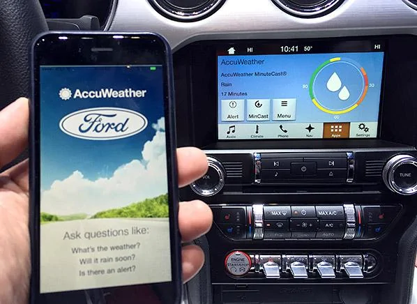

My '17 SYNC3 confuses me. The apps button steers me toward plugging in iOS devices, then promptly CarPlay takes over. Question is, when I press the Apps soft button I am told to connect via USB, but this pic shows otherwise. Of course you cannot see the cable, but when I plug in the apps button is replaced with a CarPlay button. So could this be a <'17 SYNC3 that hasn't been updated with CarPlay yet? Even the FordPass iOS app catches itself in a loop. Says plug into USB and then press apps, but that button is only present until I plug in. So WTF?
I see all these pictures on the web with people having a ton of different apps on screen but I have only a few (Spotify, iHeart, Pandora).

You have car play.. but when you plug your phone in carplay takes over.. if you don't want carplay to take over you have to go into settings and disable carplay.. so it won't jump to car play..

OK, so it's CarPlay enabled that's doing it. If I disable CP then does it just power the phone and leave the BT connection up so I can play Spotify (for ex.)? I assume I lose the CP "nav lite" and all of the other CP functions. I guess I need to play around with CP disabled.

Yes.. but the thing if you have an iPhone.. the apps will NOT populate unless the phone is plugged in.. so if you want to use everything factory and not carplay.. disable carplay.. if you want to use carplay reenable carplay in the settings.. but whatever you do the phone has to be plugged in with the iPhone.. just the way it is for now

Gotcha. I disabled CP in SYNC and messed around with it - ehh. I think I'll stick with CP. I wonder if the guys working on as-built mods will find the option to get CP to work via BT. Impossible until they all get CP updates in their cars. Seems most are waiting for that still to roll out.
