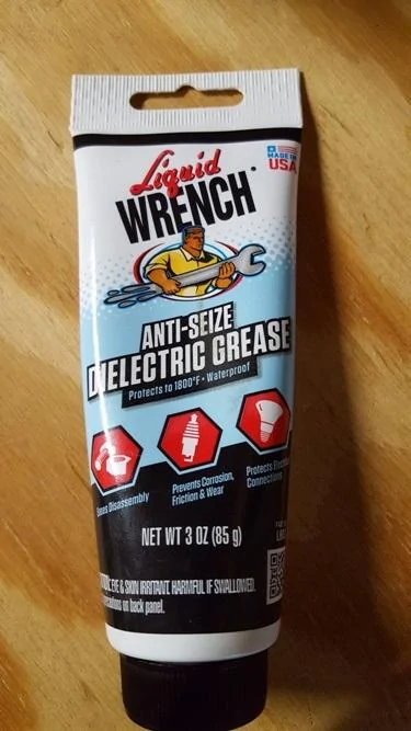

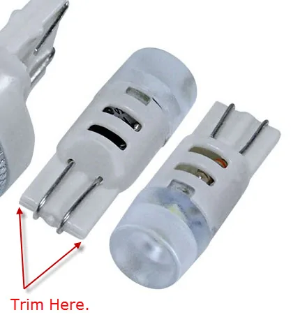

I just installed my Diode Dynamics Switchback LEDs and I like them a lot! I haven't had a chance to drive her yet but I don't expect the double blink to be a problem. My install took longer than I expected (what else is new) so after I beat my head against the wall, yelled a few expletives and then calmed down I was able to get the bulbs to seat. Let me apologize for not getting pictures of the installation but I was a little frustrated and just wanted to get the job done.
I haven't heard of anyone having problems so maybe mine was a unique situation but I had a very hard time getting the smaller bulbs to slide into the connector. The large LEDs went right into the connector and really took no time at all to install. The LED bulb seemed to be a little thicker and the ends were a straight 90* where the incandescent bulb seemed to be thinner and more tapered at the ends.
When I took a closer look at the connector itself, it had two upper "plates", two lower "plates" and a single "plate" one each side vertical to the other "plates" (sorry, no picture). These vertical "plates" are what gave me the most grief so I took a sharp knife and trimmed about 1/16 of an inch off each LED bulbs 90* end. I then covered each end in dielectric grease and it slid right into the connector!
The bulbs themselves emit a nice white light and seem to be of very good quality so I'm sure my issues were the result of my inexperience. I'd definitely buy this vendors products again and as a matter of fact I'll be ordering the interior lighting kit and the backup light bulb from Diode Dynamics. If anyone has any questions please don't hesitate to PM me.

I wouldn't recommend trimming the 194 bulbs for the corner lights though. They were designed to be a tight fit just like the incandescent equivalent. This is to keep them securely fastened in the socket.
It might require a bit of force to fit them in, but it's meant to be a tight fit by design.
