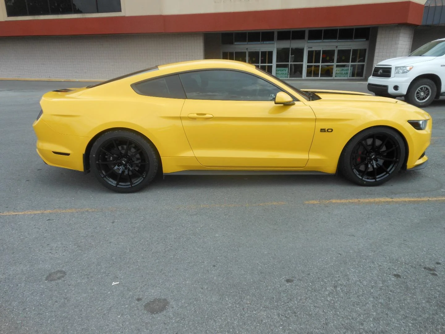

If you're looking between a 275/35/20 and a 285/35/20. It's all going to depend on the model tire you want. Some fit seemingly wider than others in the same size. And a lot of tires skip availability between those sizes. My 275's up front are Nitto NT555 G2's, most people are using those. They fit very neutral. They're not available in 285/35/20.So it seems most people are running 275/35/20s on these wheels. Is anyone finding the tires too stretched? I am running 275 on my 9.5 width wheels and they fit pretty good, would think a 10" wheel would be better of with a 285/35/20 to provide better coverage.
A lot of the stuff I see available in a 285/35/20 seem to fit wider than I can imagine most people want to run squared or in the front at all.
