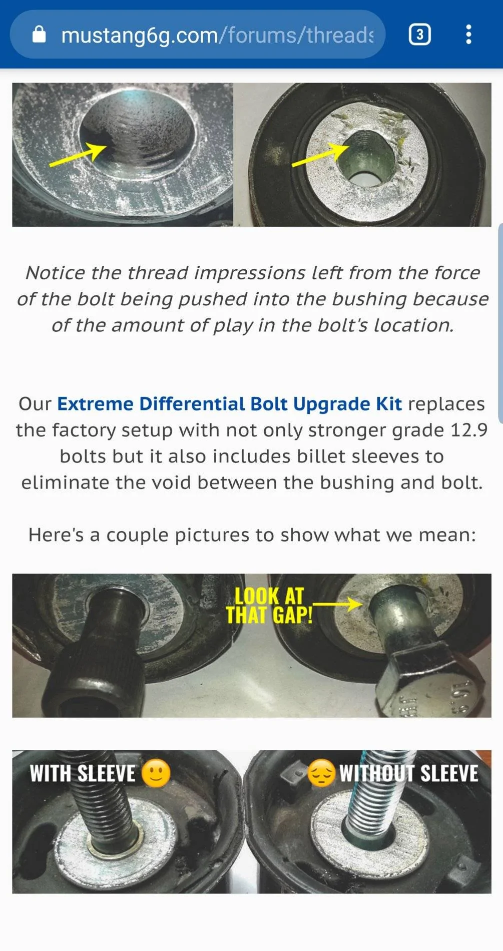

I would use the sleeves for the rear bushing from that kit (or the Lethal Performance kit, which I used), and not use the bolts or put in differential bushing inserts unless you enjoy driveline noise. The sleeves fill the void between the rear bolts and the bushing inserts.
100% agreed. Juice is not worth the squeeze with the stiffening the diff. If you yearn for more, and if you don’t have a performance pack car, you could always swap to the Torsen LSD down the road.

Well the stop the hop is a Xmas present from the wife so I'm going to order BMR diff bolt hardware upgrade to go along with it. I have a friend with a lift and I'll be installing a MGW shifter, Borla Xpipe, oil change and the suspension stuff. Was looking at vertical links also, worth the money?
