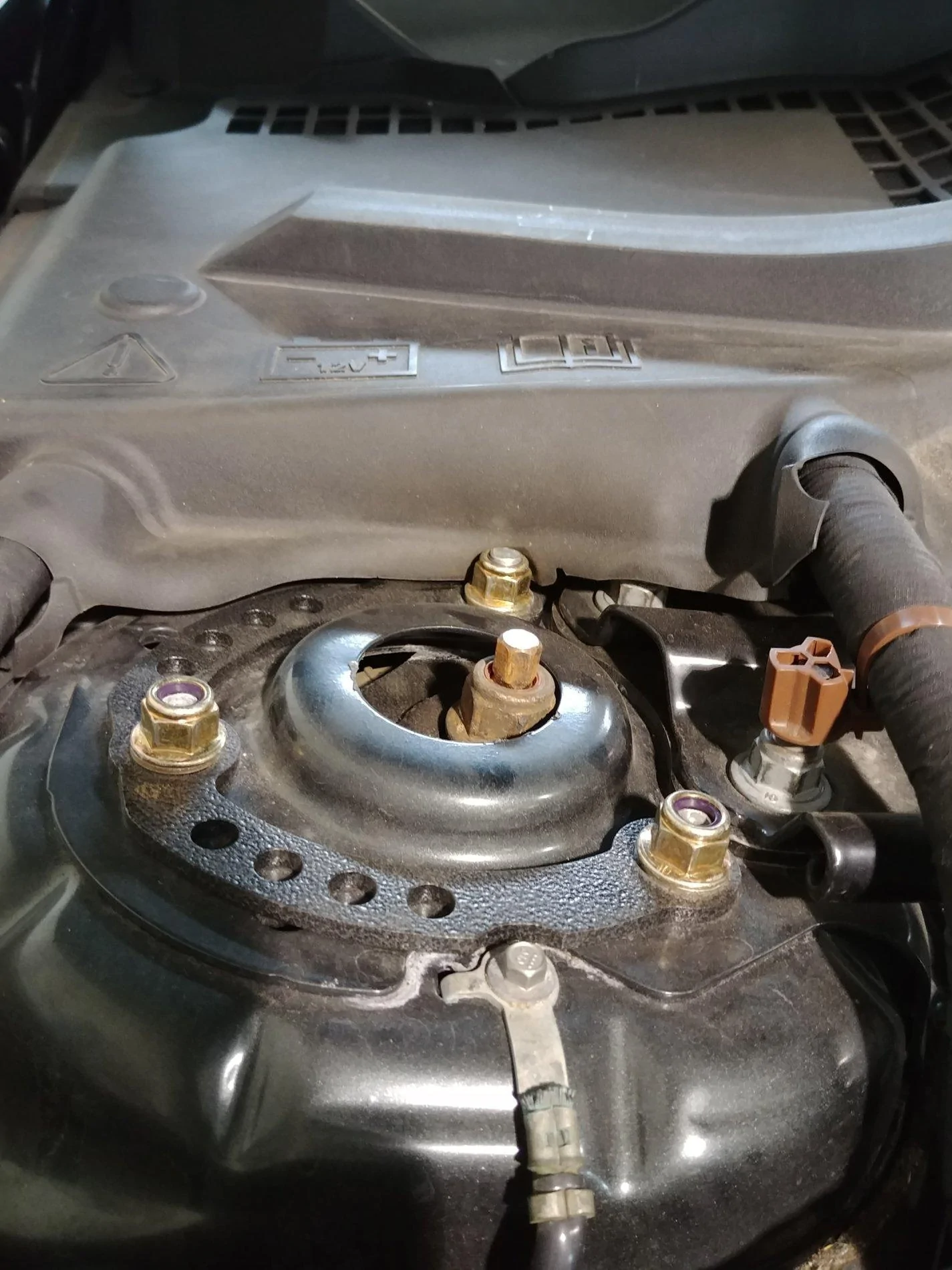

I had the FRTP and Steeda camber plates installed this week. The lowered looks good but that's it.
My target camber was Front -2.7 and rear -1.9. I picked my car up and got the sheet from the alignment shop and they got -2.0 up front and -1.8 in the rear. The installer says he sees the issue. The top part of the camber plates were hitting the top of the strut tower so the alignment guy couldn't get the strut to move over.
Did you all have problems like this?
This is the second set of camber plates I've tried and I have had 4 alignments to date.
Guys, I am seriously disappointed. View attachment 377527

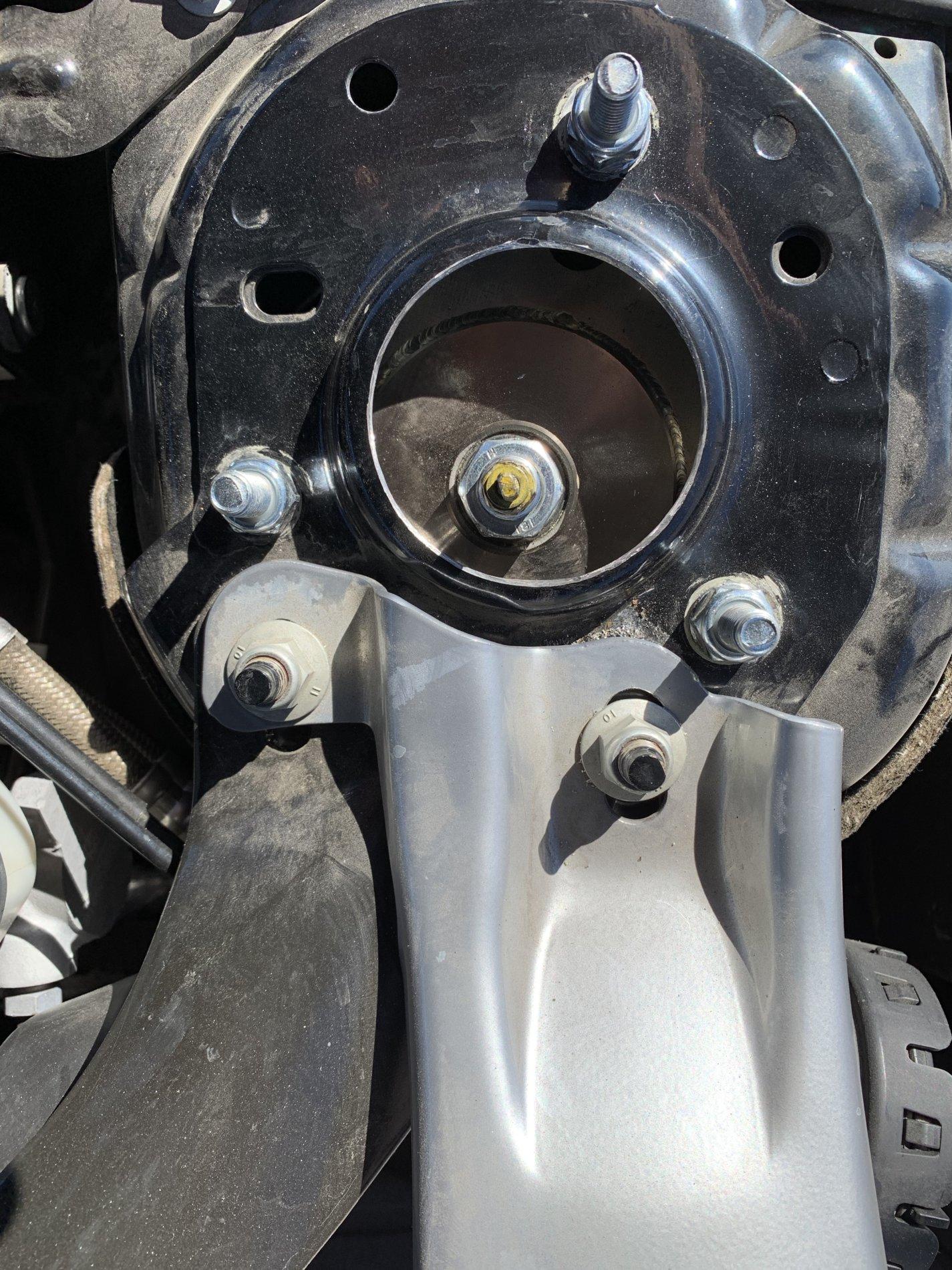

I think your install guy is not right. My Steeda plates do look like they’re contacting the strut tower underneath, but yet they slide right under there with no issue. Do you have any pics?
Everybody else is getting maximum physically allowed camber by the strut tower opening with these plates. I think the installer is broken.

Do yours look like this? (My tower hole has been opened up, but the bracket part goes underneath)

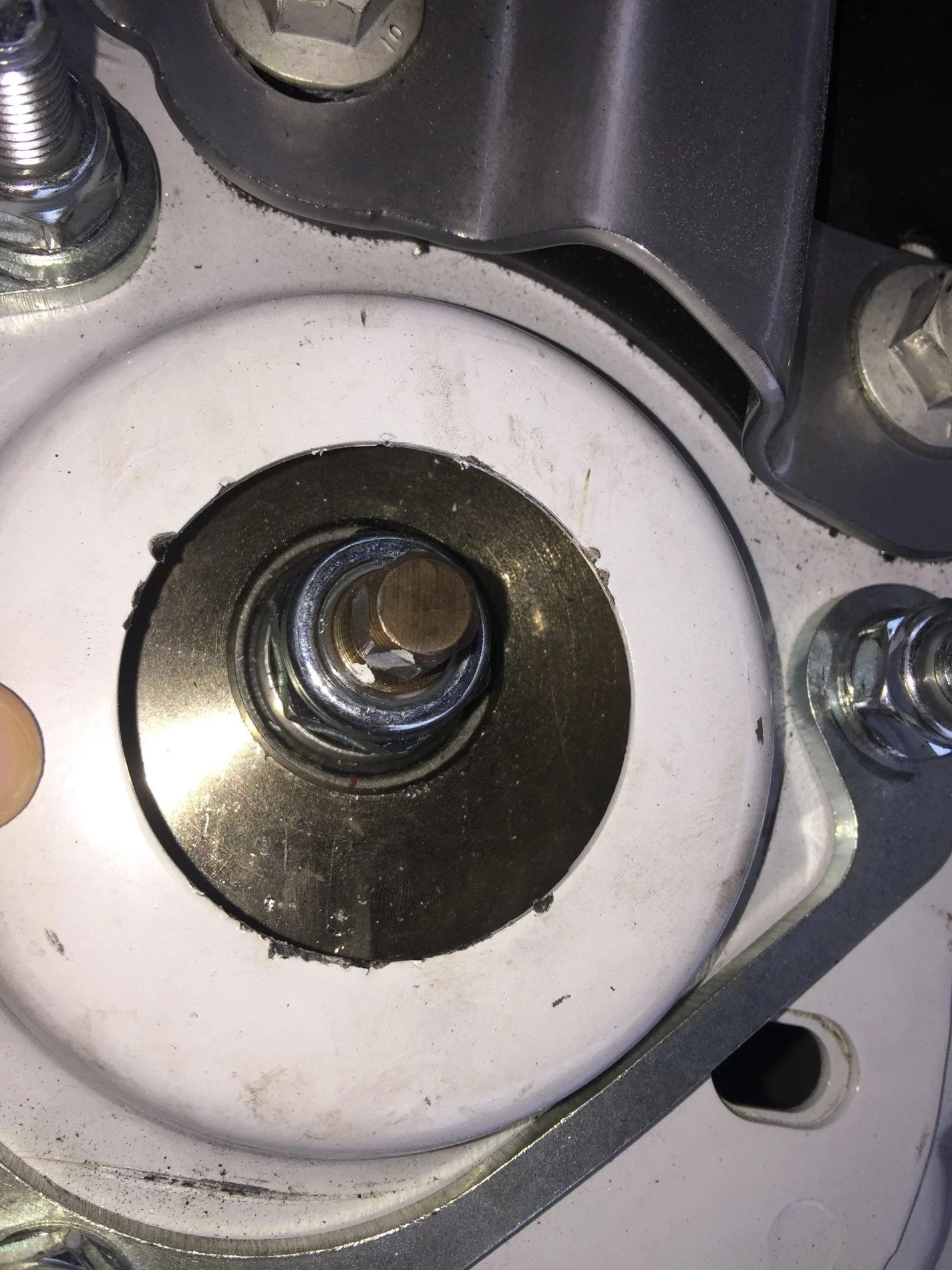

Mine is no wear near that far over. See the pic.

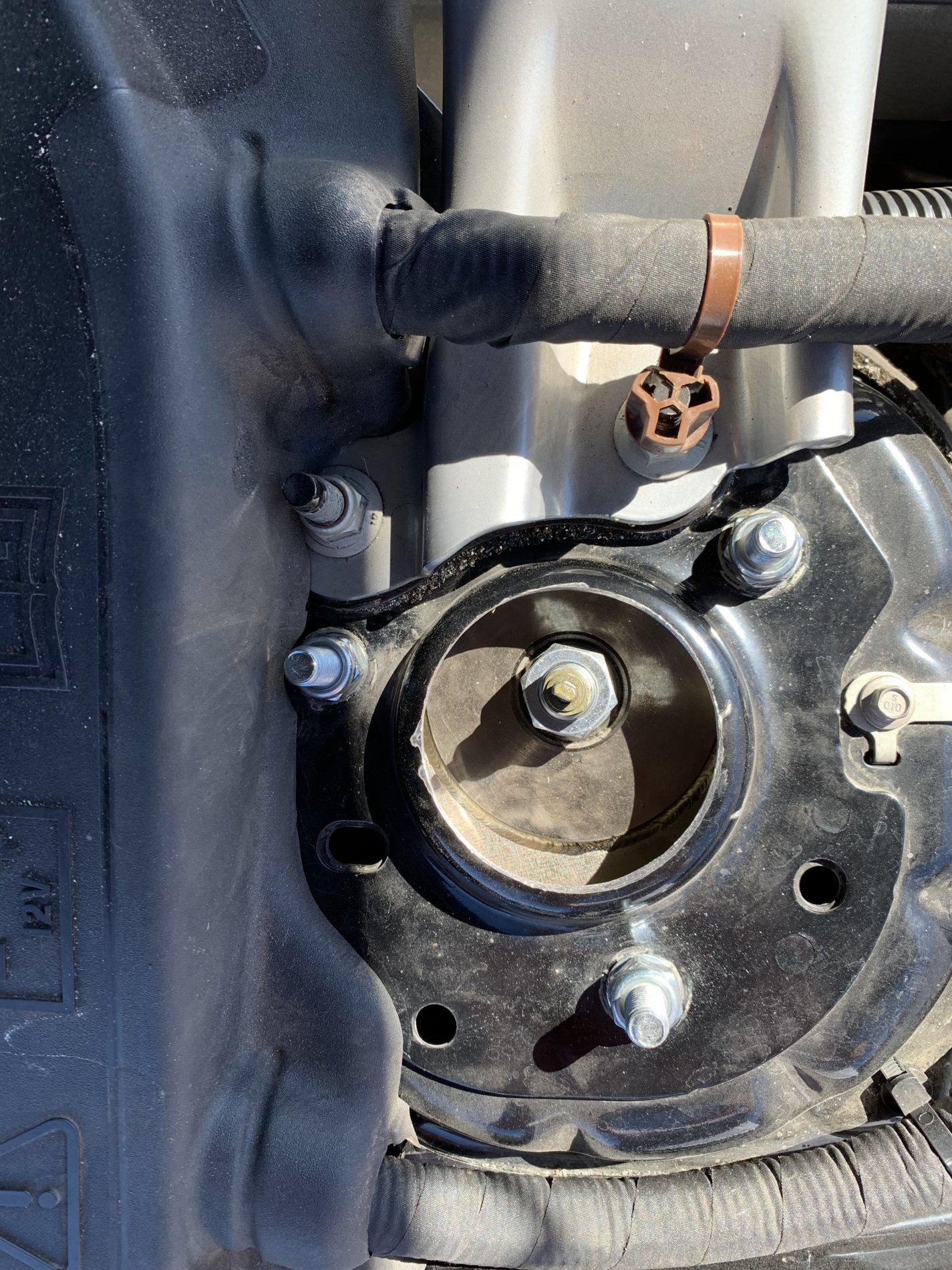

Nightmare,
I notice you don't have the top brace like mine. Could that be it?
Edit:
Son of a gun, Thats it.

Nightmare,
Edit:
Yup, that part goes underneath. Glad to help.
