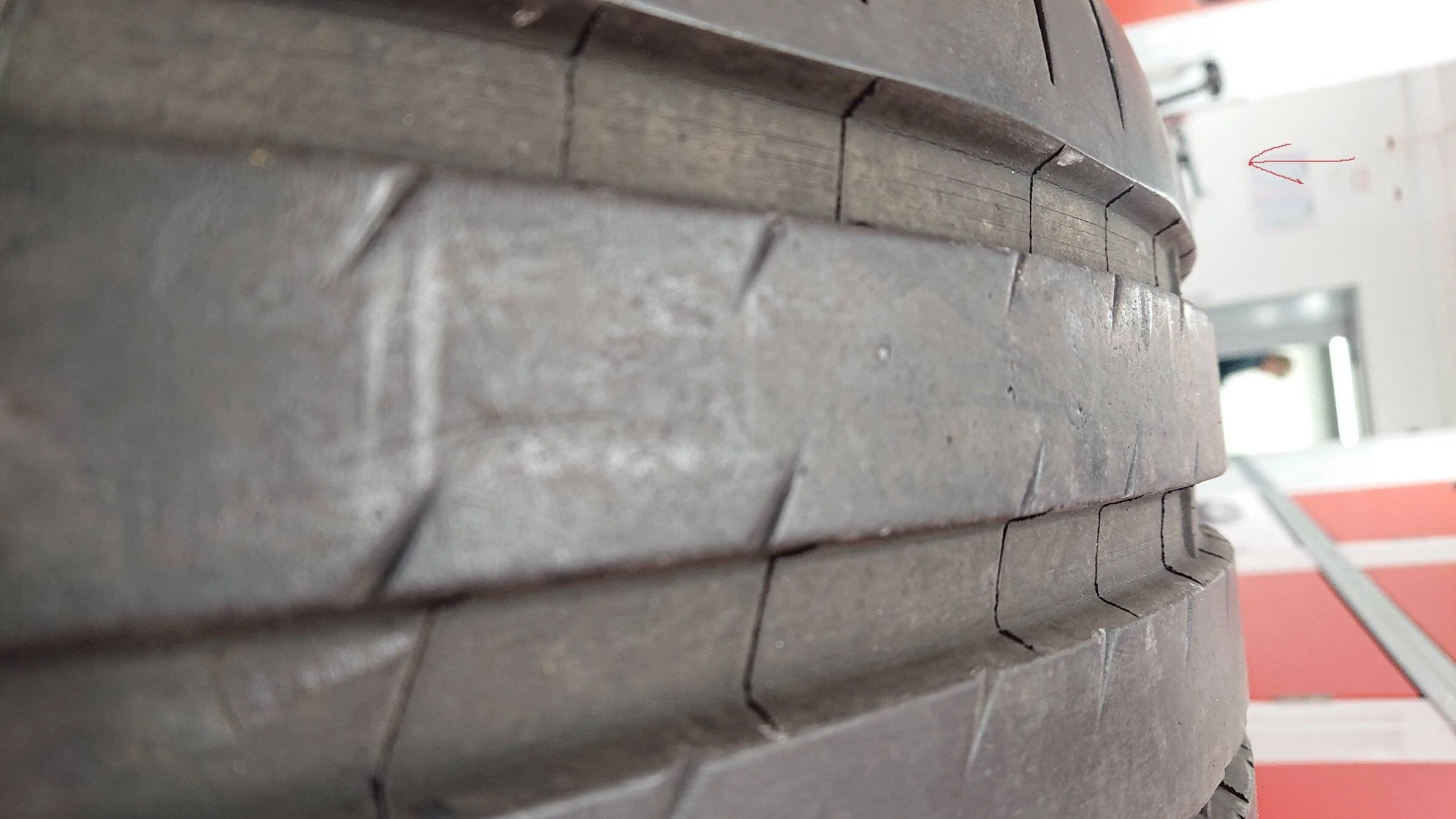

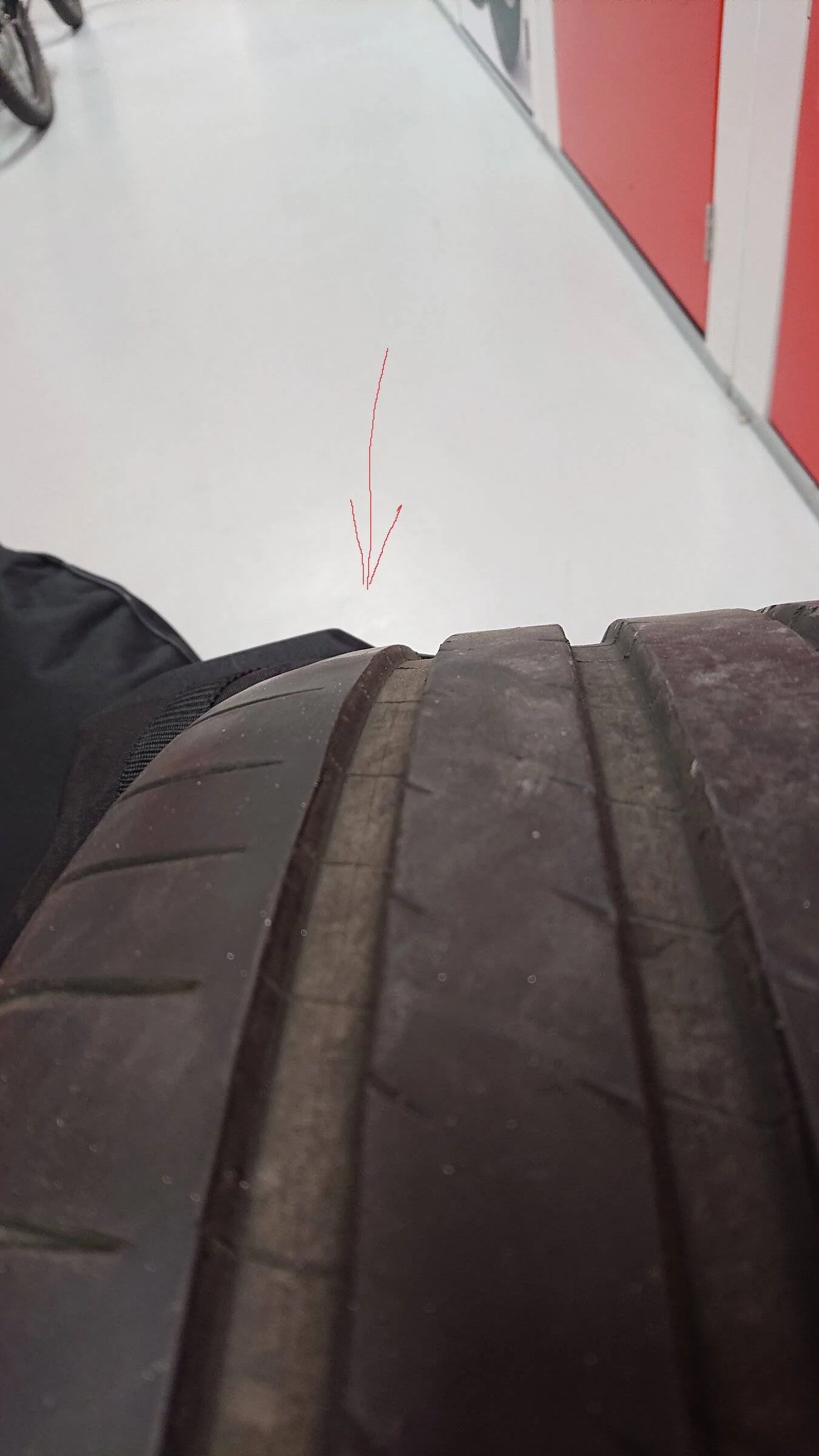

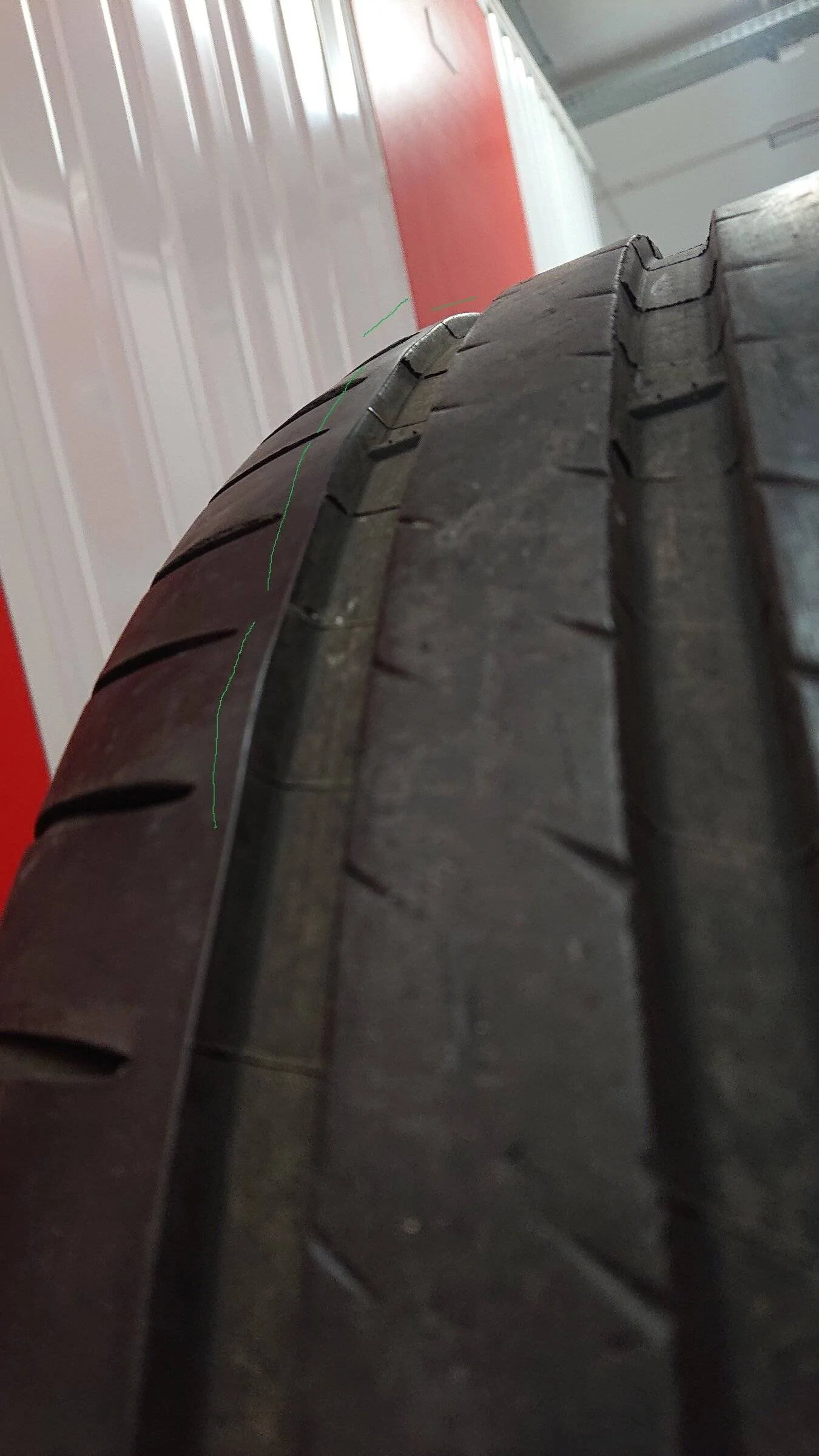

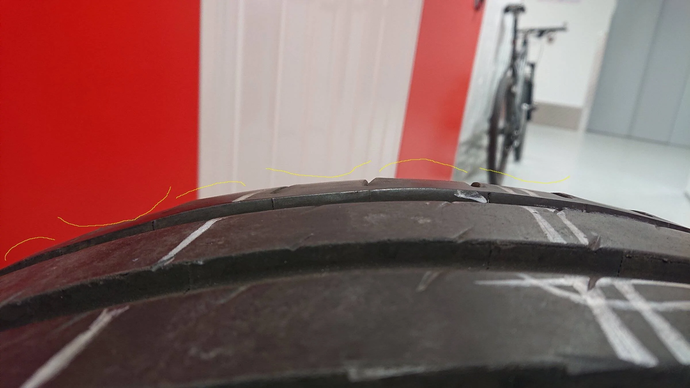

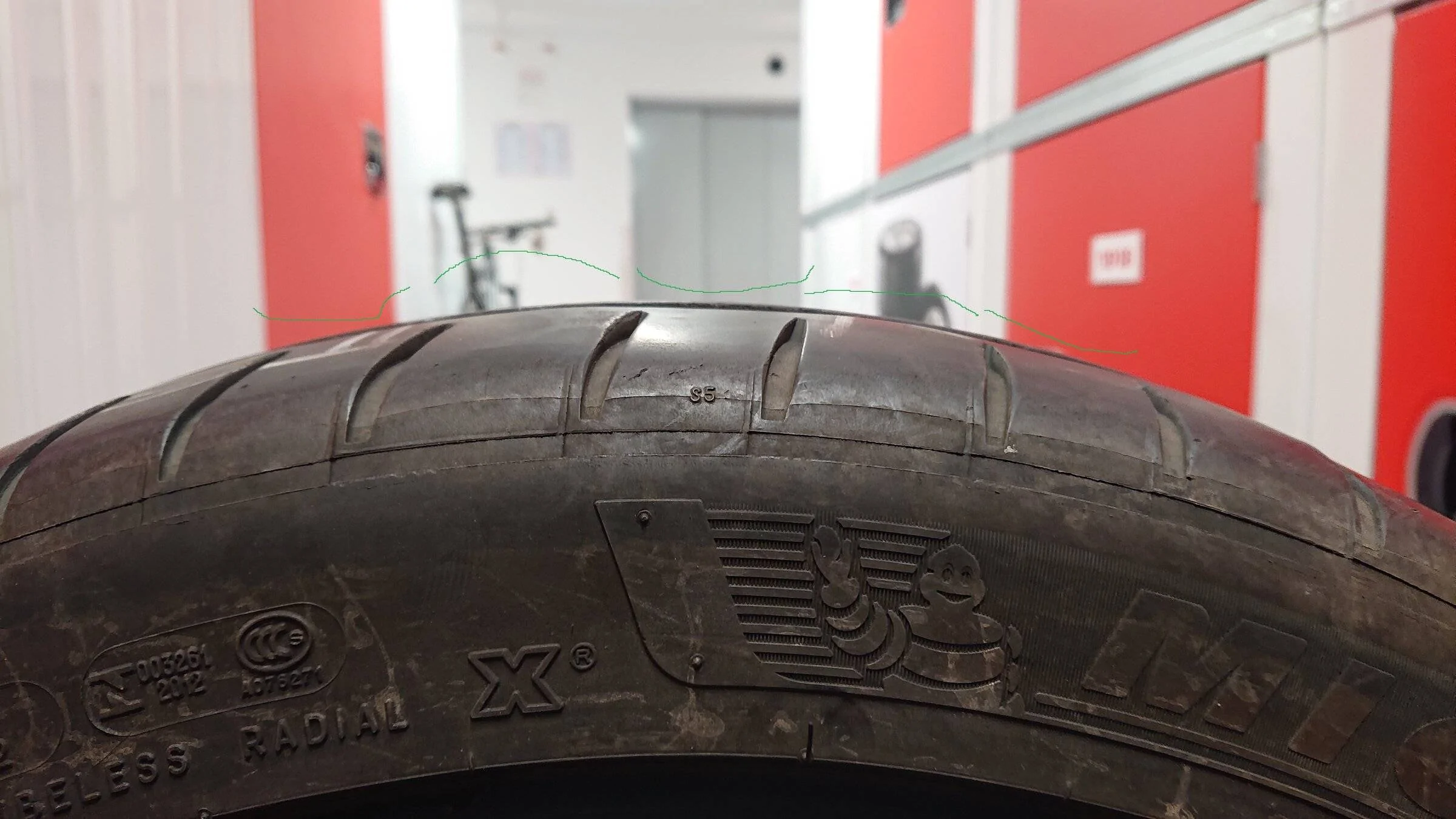

I have GT MY2019 EUR version (bought new), 35k miles driven so far, and I change my tyres every season. Summer tyres are pilot sport 4s which came with a car. Last time I changed from summer to winter in November 2021 the mechanic said my summer fron tyres are damaged and have to be replaced (he didn't want to sell me new ones, so I consider his advise legit). Then he showed me the issue - both of the front tyres have inner edge uneven. It's not nice and curvy but it became many upper and lower segments. Hard to describe it but it looks like in computer graphics when you zoom in on 3D ball or circles you will see it's actually many small straigt lines which looks like a circle. Or, maybe it's better to visualise, when I look from the side of a tyre it looks like the inner edge is continuous line of hills and valleys. I attached some photos. The tangible effect of this phenomenon is mostly noticable when I stop slowly (parking, approching the junction etc.) then I hear deep sound (sounds like woof, woof, woof) with every wheel rotation, like the tyre rubs agains something. Nothing happens during higher speeds. After change to winter ones this sound went away. What can cause that? Dealership took a look and said suspension is fine, geometry was off but just a little bit. Can this happen because of wrong wheel balancing during the previous tyre change? Or maybe it's magnaride problem? Rear tyres are all good.

Hello; Looks like what i understand to be tire cupping. Here is a link i found with a quick search.
4 Causes of Tire Cupping and How to Avoid It | Auto Buyer Guru
There are lots of sites with information. If the front and rear tires are the same size you can rotate them to help and get more miles out of the tires. If different sizes that cannot be done.
If the alignment is good and suspension parts are tight you may try a bit more air pressure. If it is due to driving style such will be part of the cost of having fun.
I live in pickup country. Lots of lifted trucks with oversized offroad tires. Those truck tires tend to cupp a lot. I can hear them "singing" from half a mile away on some trucks. Acceptable if you are doing serious off-roading, but too much noise for street driving.

I'm dealing with the same thing, on an earlier post of mine a few say it's common on these cars and one said specifically the PS4s. Mines going in for an alignment check and will probably try a little less negative camber being as I don't track the car. Jim
