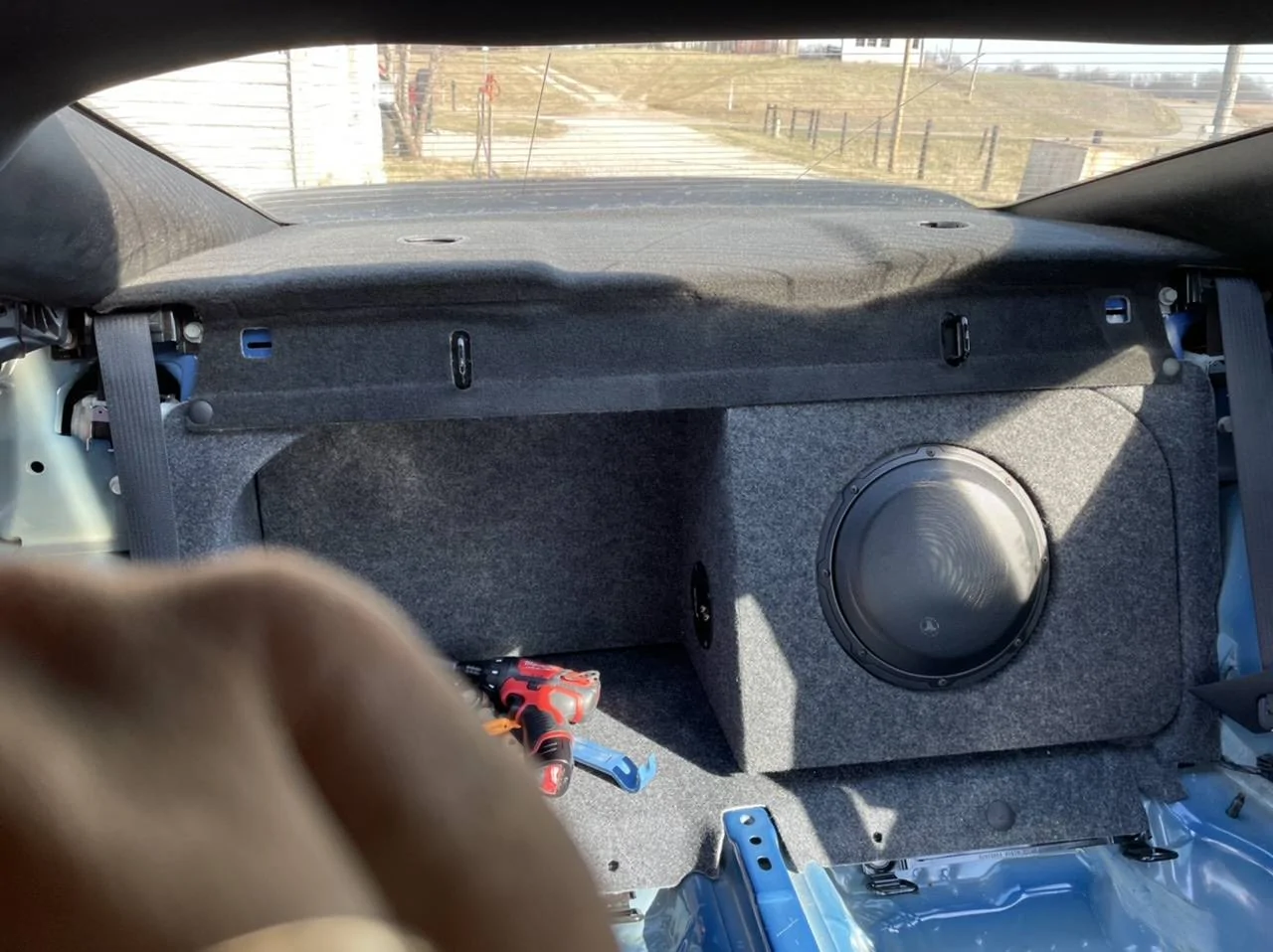

Thanks! I’ll wait to do the rears, trunk sub and external amps for my “new” leather seats (adding the heat/cool feature as well) to arrive. All of this is so much easier without an interior in the car!

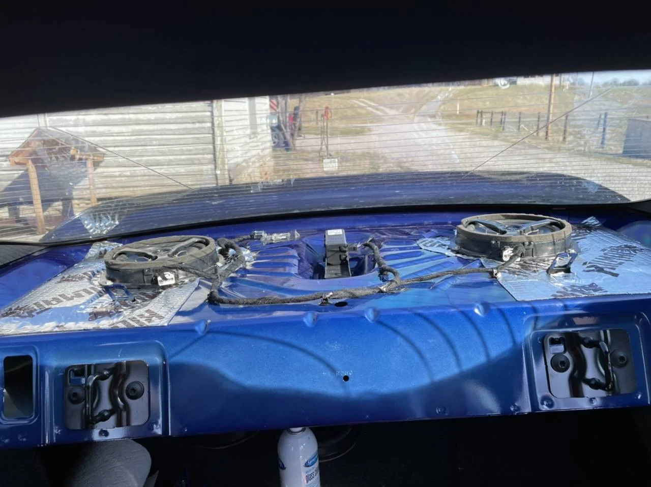

I spent more time in the car yesterday. After pulling out much of the interior - seats and panels - I installed rear speakers and ran cables (power, remote turn-on and RCA preamp) from front to rear for the amps. I got a used pair of rear speakers from a 401a car -these have plastic woofer cones and a small tweeter overlaid in a coaxial manner - factory coax’s. Far superior to the paper cone with wizzer cone “tweeter” that was there from the factory.

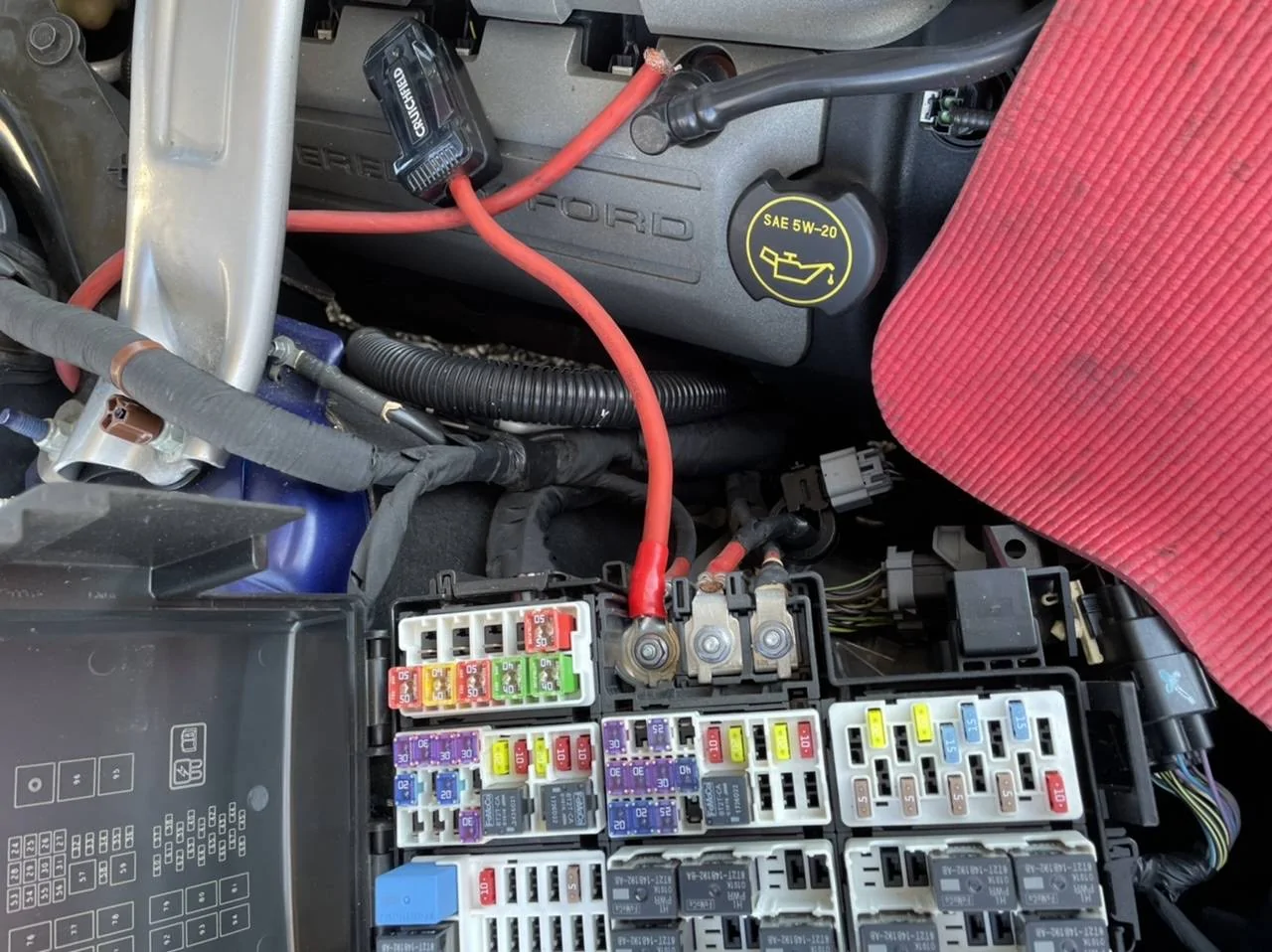

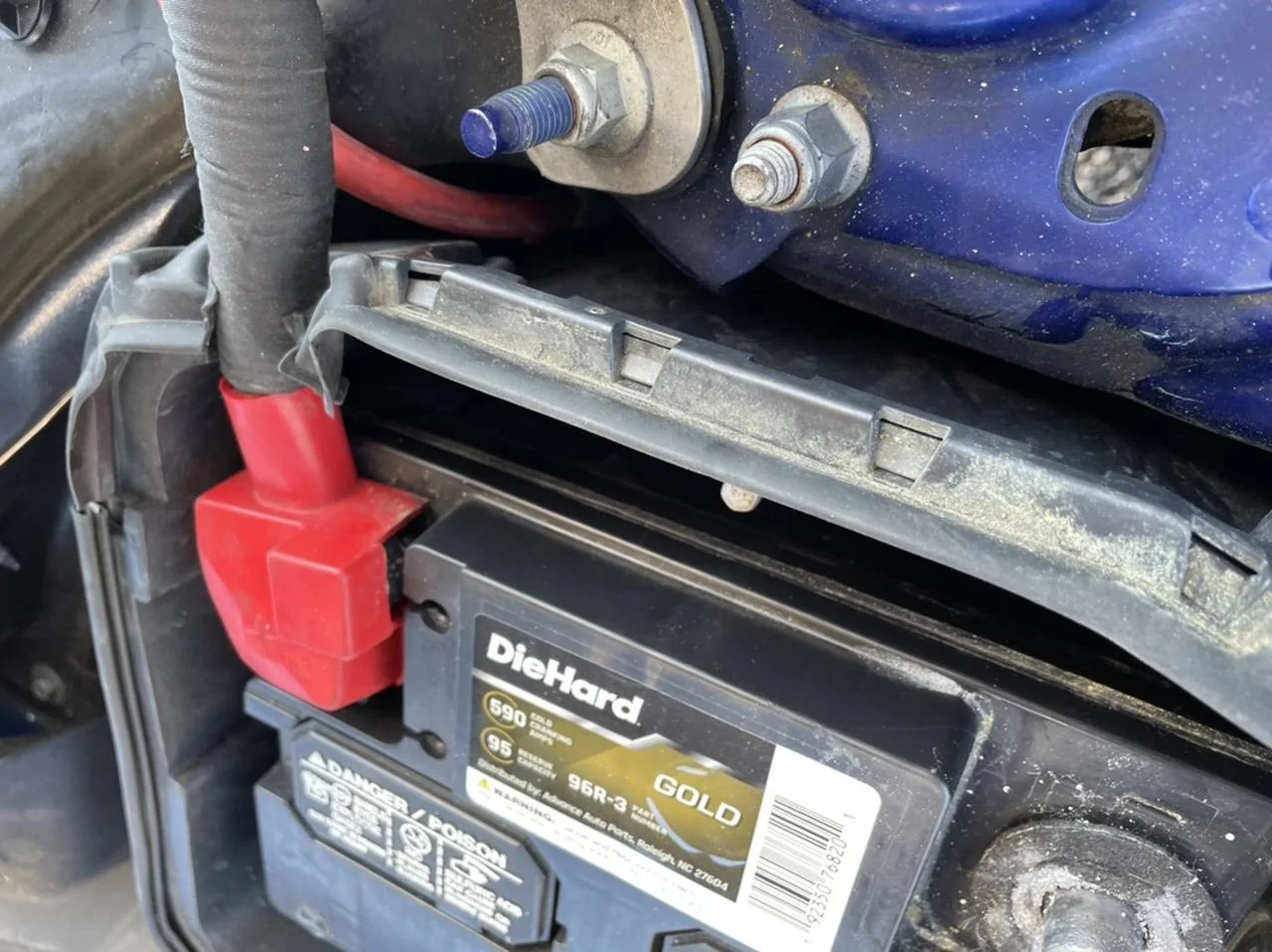

I also figured out how to route the 4 gauge power cable from the power block under the hood.

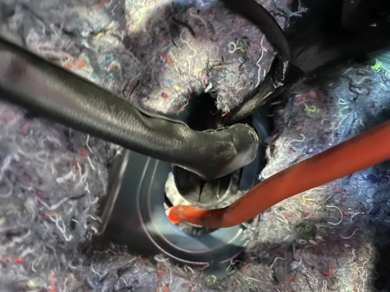

1) From inside the car at the front passenger footwell, look high on firewall near the kick panel.
2) Push that rather large and squishy wire bundle and grommet forward, goes maybe an inch.
3) Under the hood, remove your battery and then the three bolts that secure the battery tray.
4) After lifting those out, you’ll see a hard plastic snap-in grommet (square on one end, rounded on the other) about an inch forward from the rear of the metal opening seen when you pull the battery and its box. This hard plastic grommet has a “chute” aimed downward and an opening just right for your power wire to fit through.
5) Push that ovalized grommet down and look under it to the rear. You are looking one inch up and just in front of that squishy rubber grommet you pushed forward at the firewall inside the car.
Next step is critical…
6) Feed your long run of power cable from under the hood, through the plastic grommet, down its “chute”, and towards the opening in the firewall. I fed maybe three inches for this step.
7) Go back in the car to the firewall opening, reach up to find the end of your power cable, then pull it through the opening.
8) With the path now created, feed more cable towards the rear of the car to wherever you are mounting your distribution block and amps.
9) Make a small cut along the side of the squishy grommet, tuck your power cable in, apply rubber cement to seal/repair the cut you made, then pull back wire bundle and grommet to snap the squishy grommet back in place on the firewall.

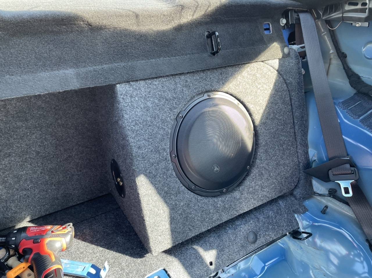

In my case, my amps are going on a vertical board formed as part of a Zenclosures single 10“ forward-facing sub box. ~$200 plus sourcing a nice JL Audio 10” sub with optional press-in grille should provide me enough bass along with a readymade area to install the amps, etc. - all out of sight unless I fold down the rear seats. Viewed from the trunk all you see is a new vertical wall. You lose the pass-through feature unless you can make all of this removable for when you need all that space.
