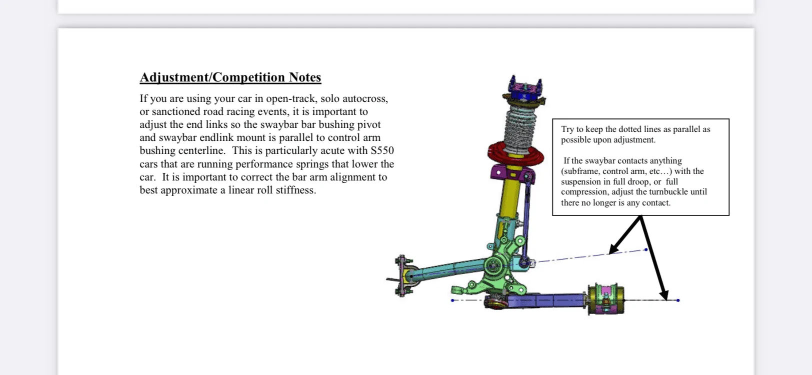

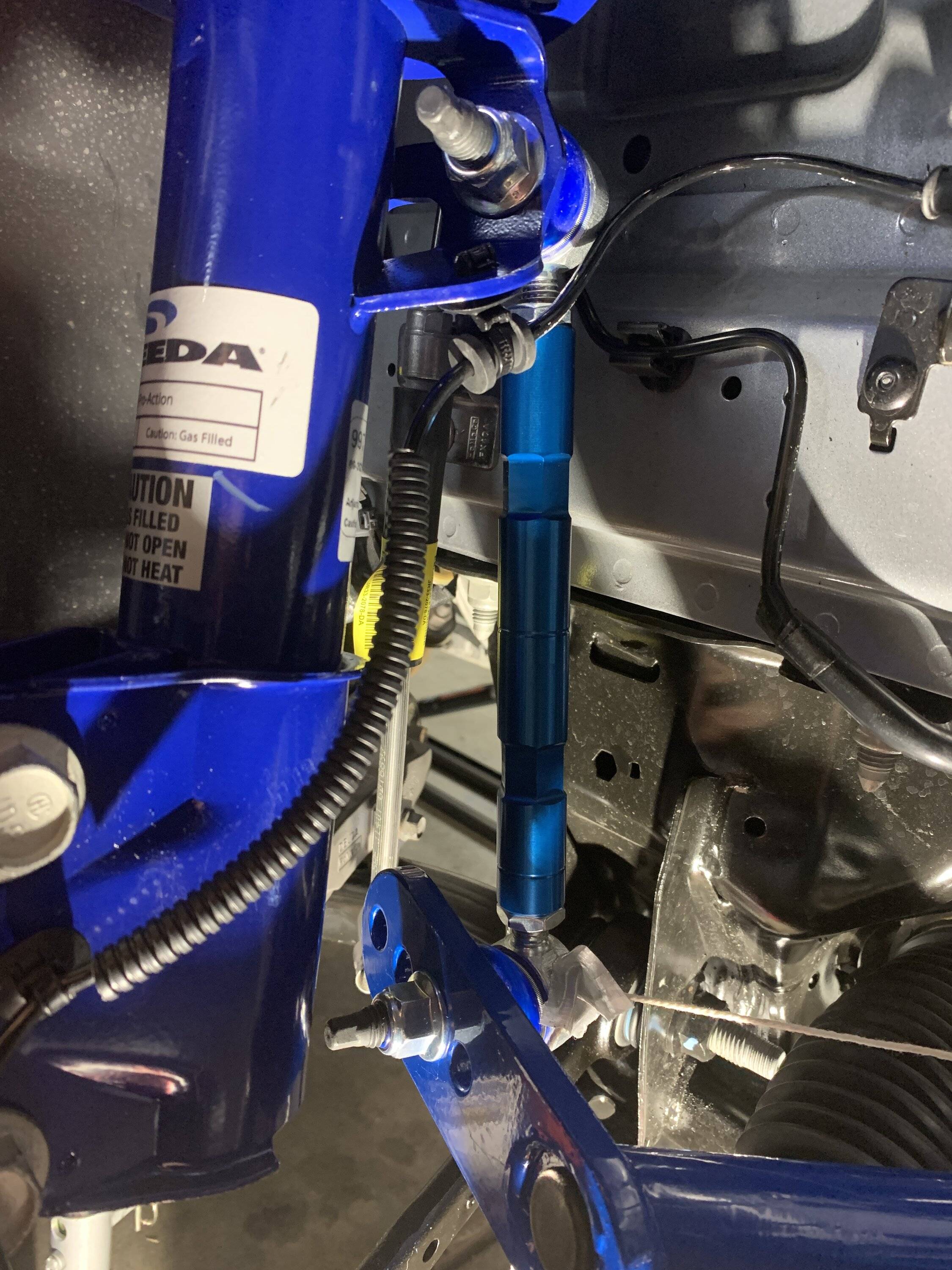

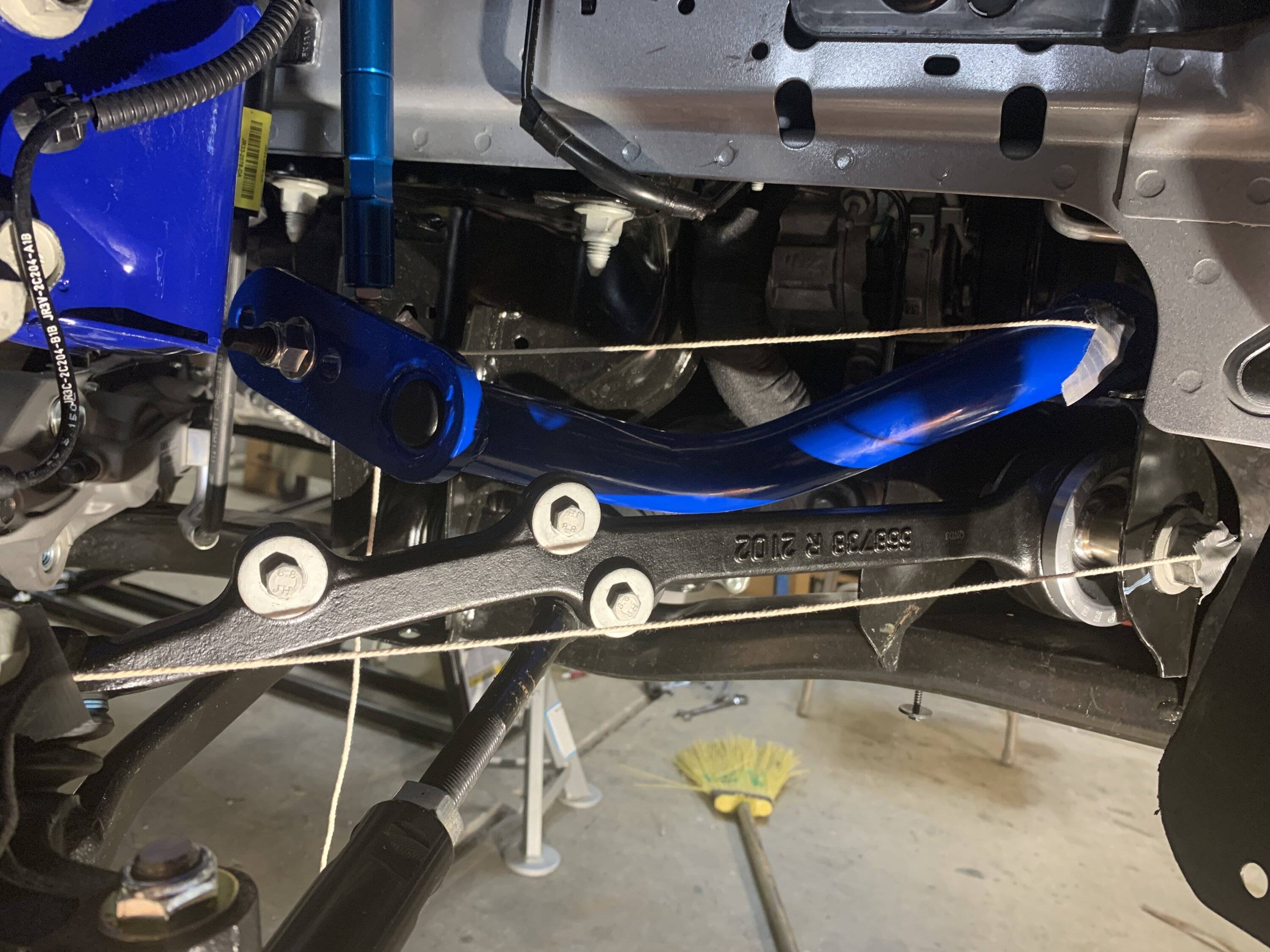

Following Steeda directions, is this string alignment going to the correct points to adjust for parallel? Also with the camber plates moved to the -3 degree area for 19x11 305 30 19 (haven't measured camber yet) the zerk fitting was tearing into the metal brake lines. I removed it and repositioned the endlinks as in the photo. Will there be any geometry problems like this?

Good question it would seem to be spot on but that diagram is a bit confusing in that the sway bar is conveniently straight vs the multiple doglegs of the S550 front bar, maybe it doesn't matter.
Also the orientation of the bushing in the diagram vs the orientation on the S550 is strange although you can probably discount that as artistic licence.
Might be worth sending TJ@Steeda a PM he's very good at getting this stuff resolved.

Thanks. I did send Tim a note and he responded on the weekend (nice) and he has passed it on to his tech team.

Great it's a good question and one I thought would have been asked previously, very interested to know what they say :like:

They got back to me early Monday. The strings are in the correct spots. He suggested checking the strings are all centered. My moving the upper link to the front hole will require making sure the ABS line won’t get snagged. I’m going to remove the springs and run everything up, down, left and right checking clearances which have been reduced by moving the top of the strut to -3 degrees camber. I will try front and back top holes for the strut/endlink but I appear to have a very narrow space to the brake hardline in droop. Looks better in the front hole. One of the reasons I’m removing the spring. To check all clearances in full movement. The upper zerk definitely needed to go and I will cap the hole.
