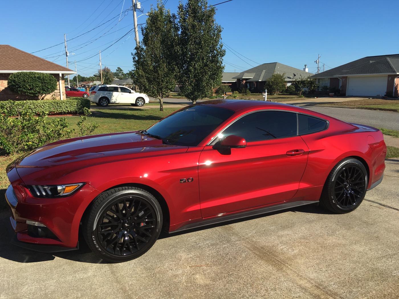

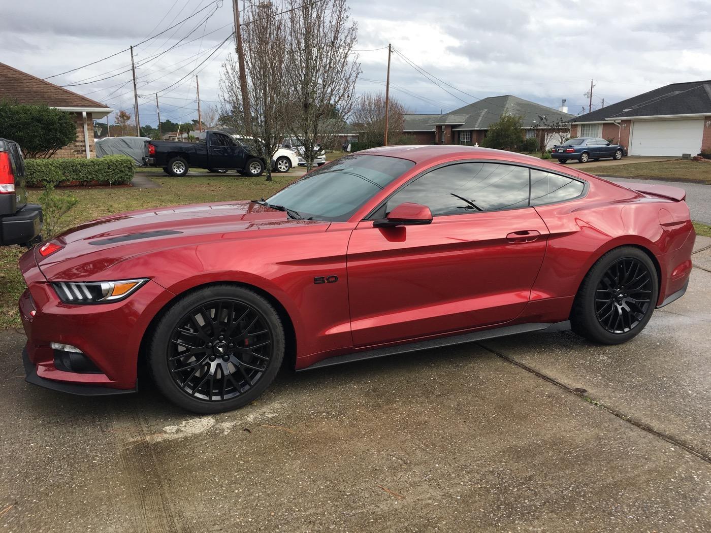

Overall Impression: I love the drop! It's perfect for what I wanted. Ride-ability is awesome. I went from Performance Pack springs to these and the rear bounciness is gone now. With the rain today I'm not willing to go test out the handling of this setup just yet but so far everything feels great!

Here are my before and after shots of the install. I have 20mm spacers in the rear and 25mm up front and no rubbing issues noted.
