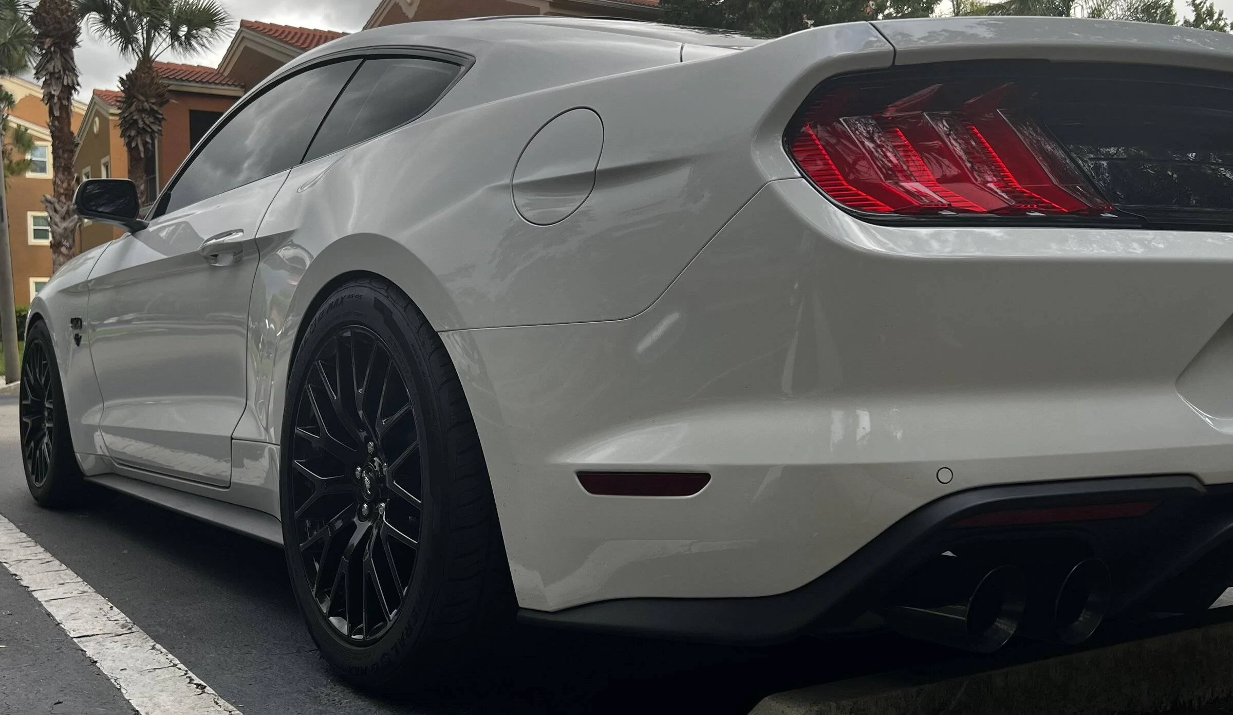

Here suspension and the rear support brackets. Here is a picture of the car prior to the install

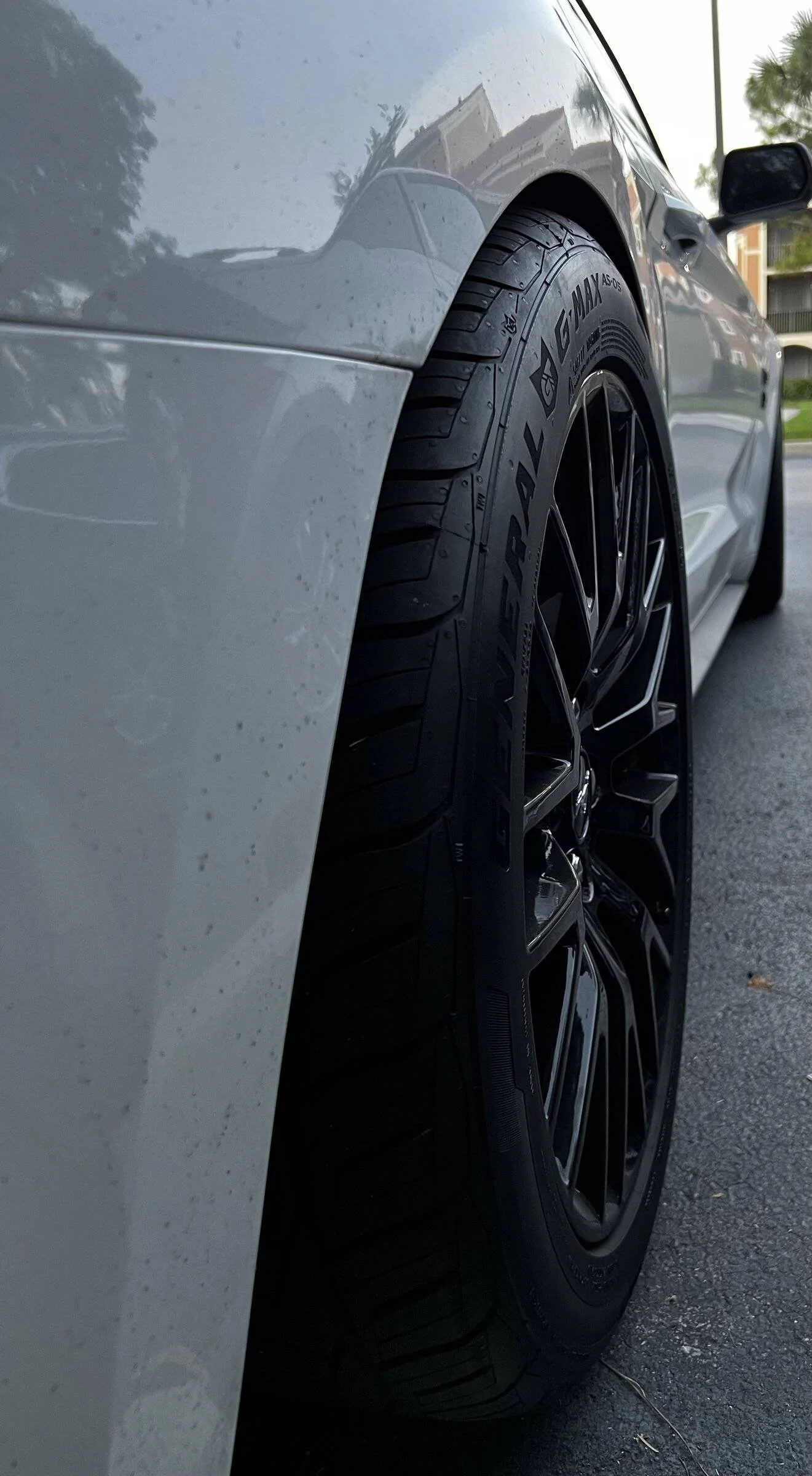

I also wanted to keep the wheels because I really like them for one, and two has a brand new set of tires installed. So I purchased some 1" spacers. I also now have the standard spare tire kit which is supposed to fit over the brembos since I have the 1" spacers.

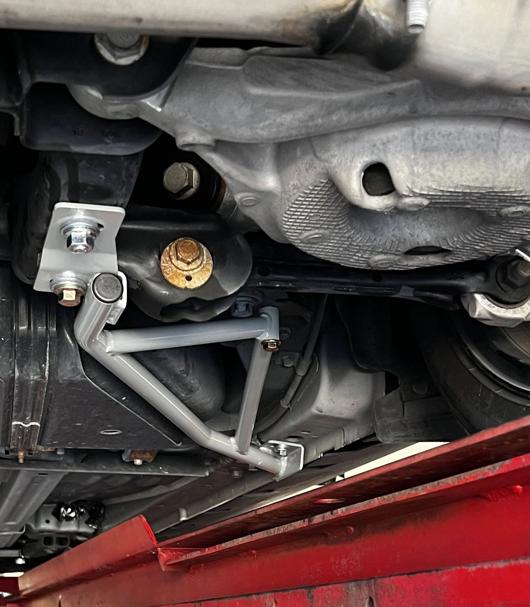

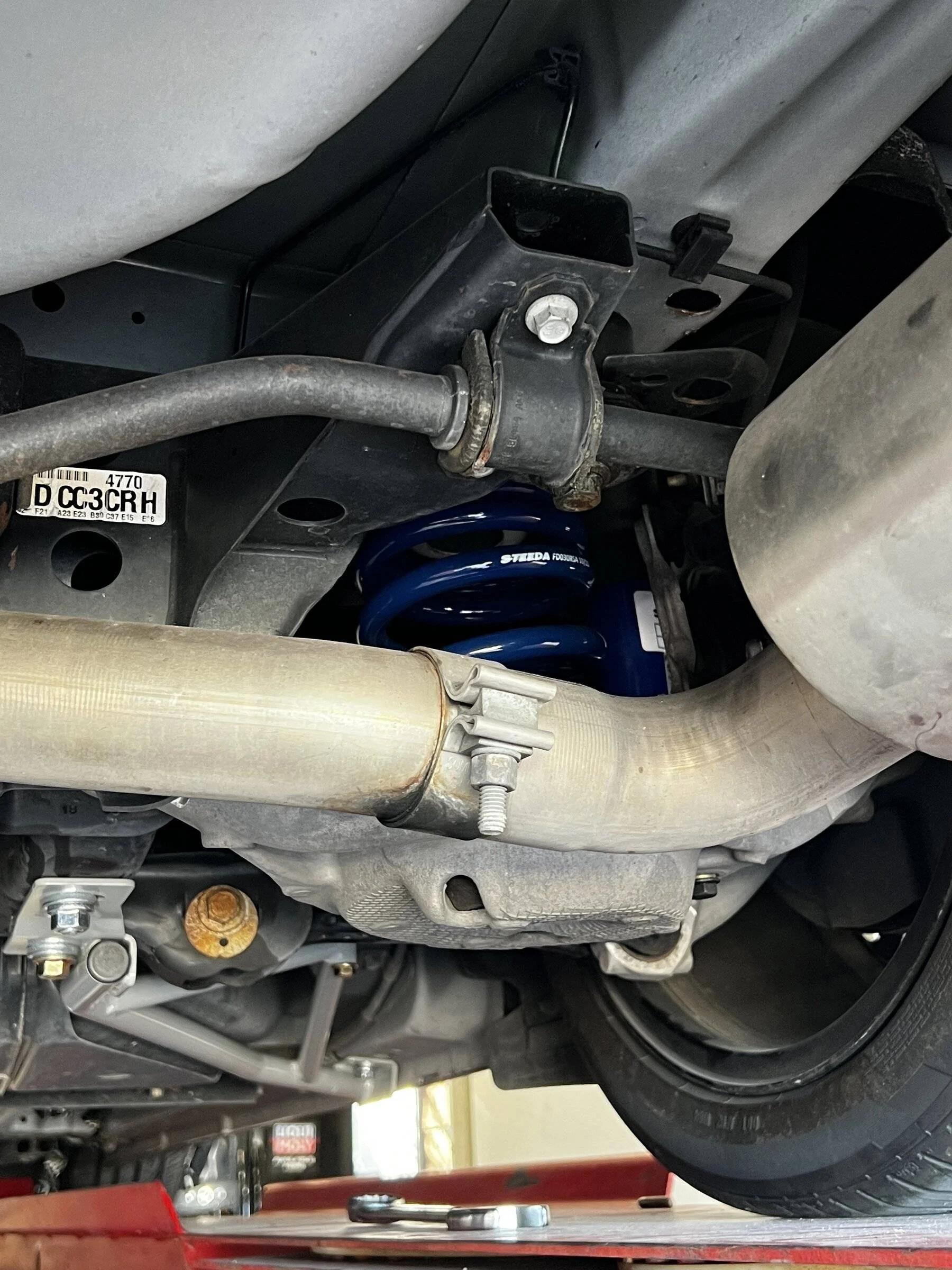

Here are pictures of the rear arms and springs, shock and upper camber arm. Hard to see I know and I will get some better pictures to share.

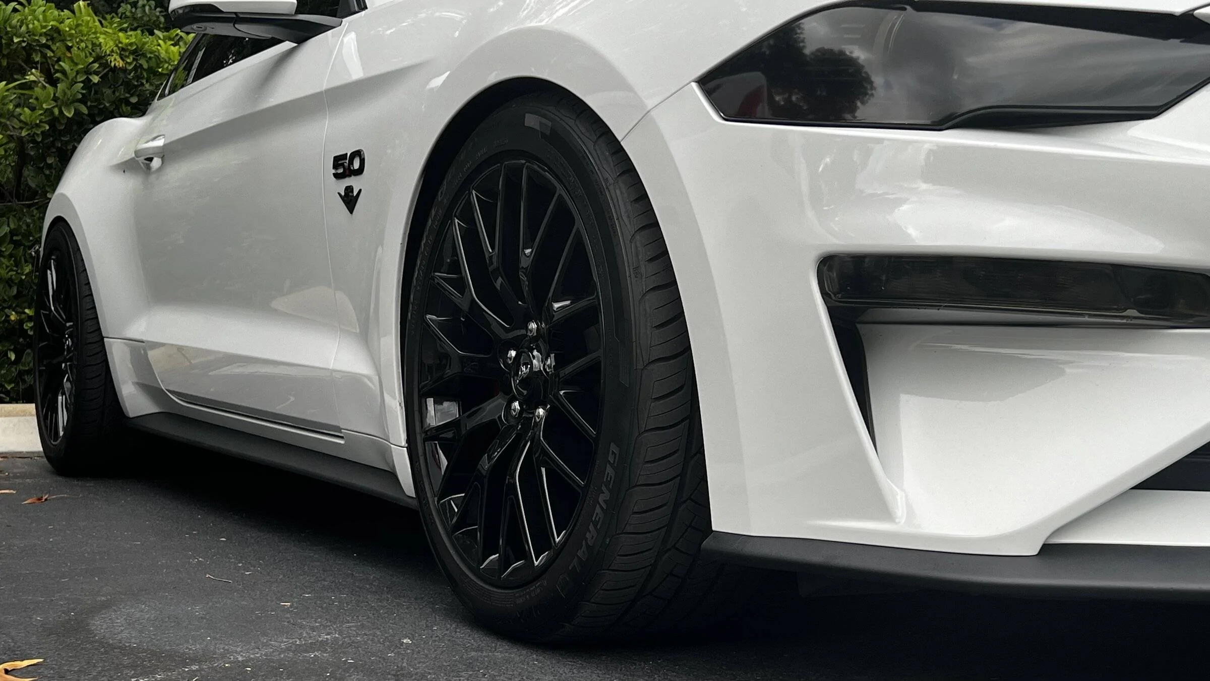

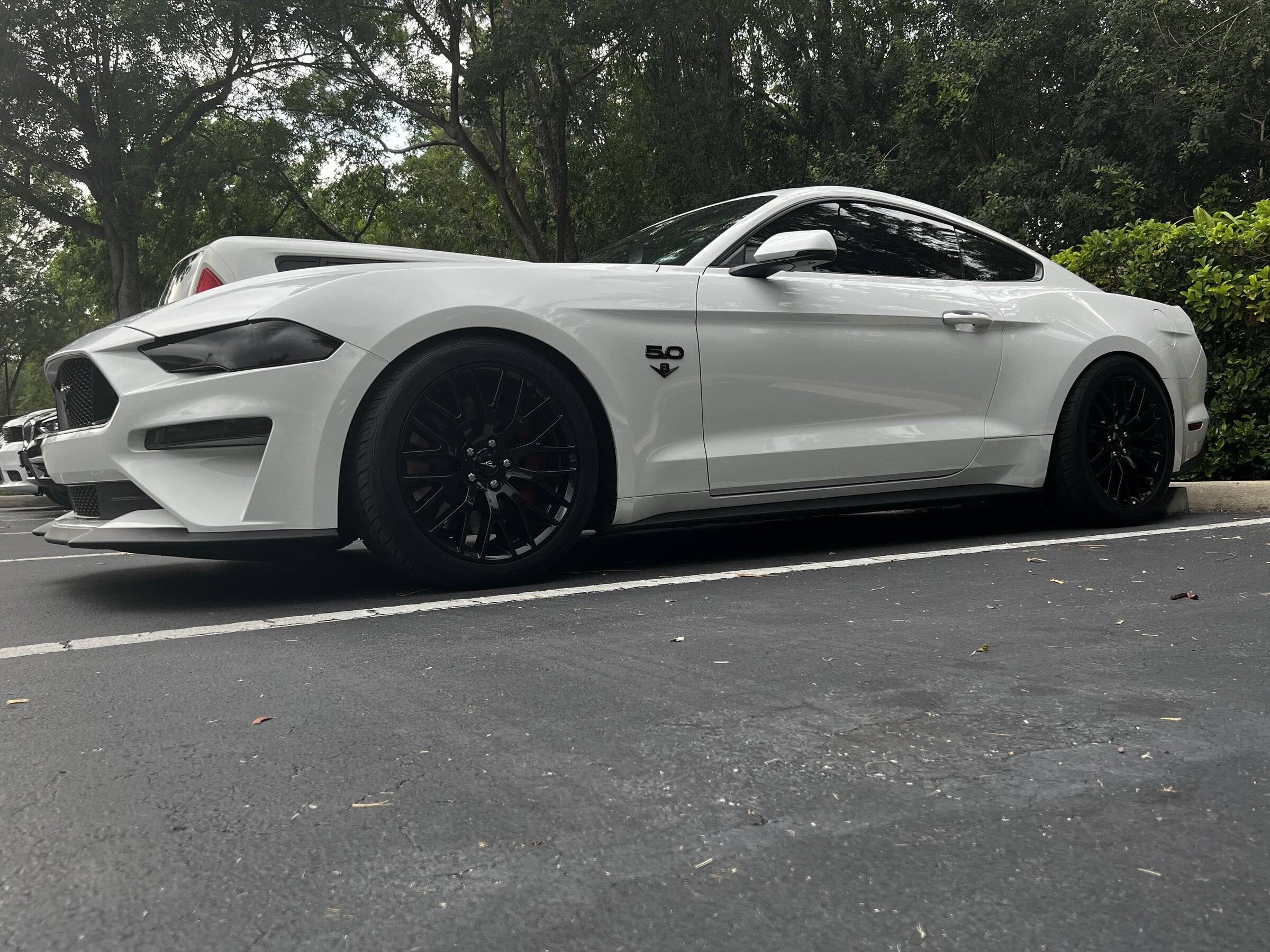

This is after install. The spacers and the suspension have the stance exactly the way I wanted it. Perfect for me.
