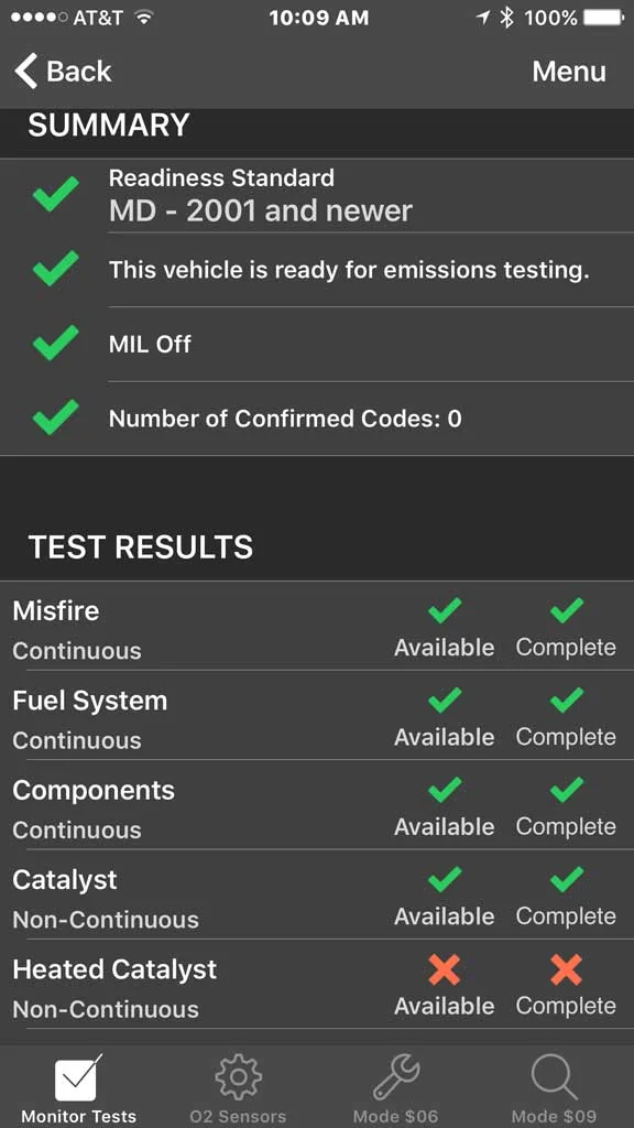

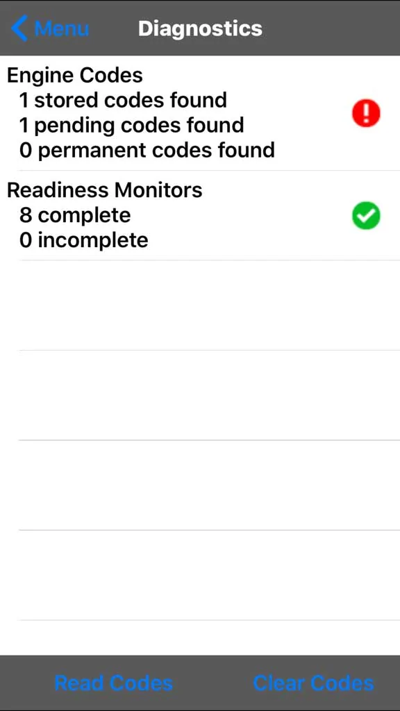

I personally really like PLX's Kiwi 3 but it's a little expensive, most of the good ones are though. This one works with Android and Apple, has an automatic shutoff so you can leave it plugged in and it won't draw power. No hitting buttons to turn it on or anything. You can literally get in the car start it, open the app and depending on the app, it will auto connect in just a few seconds and you're going. PLX is about to release an app too. I'm one of the beta testers and it looks great! It should be available soon.
For the monitors today I have a couple other apps I use, OBD Fusion and Dash Command. For both of those, I bought the enhanced PID package for about $10. With Dash Command, I had to buy the enhanced PIDs for the 2014 Mustang GT so I could have IAT2 to read the temps after the intercooler that are actually being used for combustion. Here is a pic from OBD Fusion and one from Dash Command showing the monitors. Notice OBD Fusion actually lets you select your state so it knows which monitors will be looked for. I like OBD Fusion better but the interface on Dash Command looks nicer.
