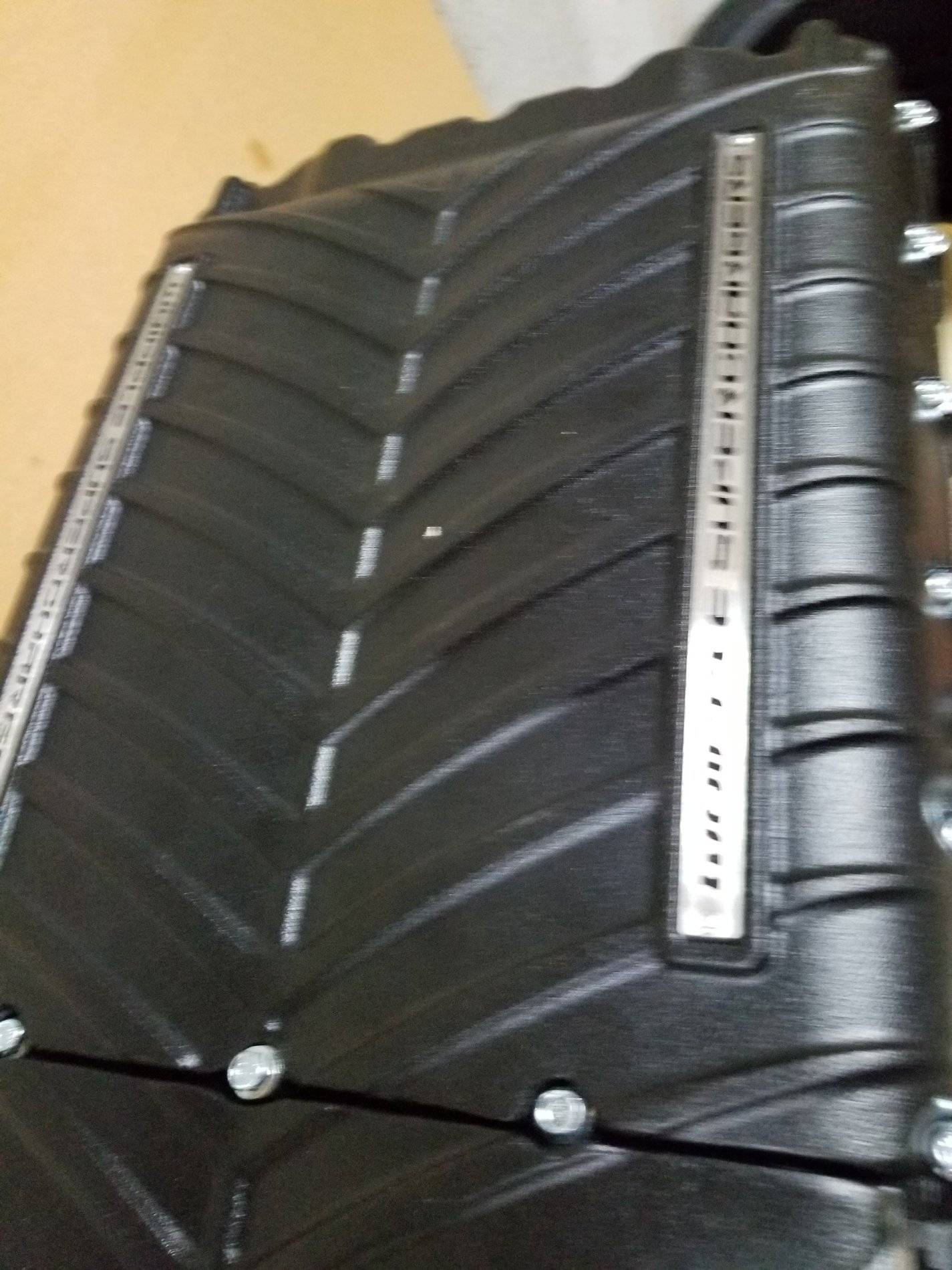

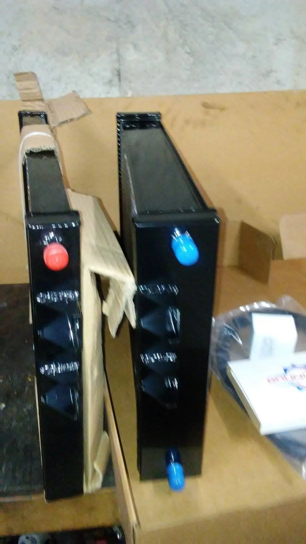

I am finally ready to put the charger on my car after having it for a couple of months now as well as install the oil pump gears. After some hard thinking I went back and ordered the larger heat exchanger living in the south.
