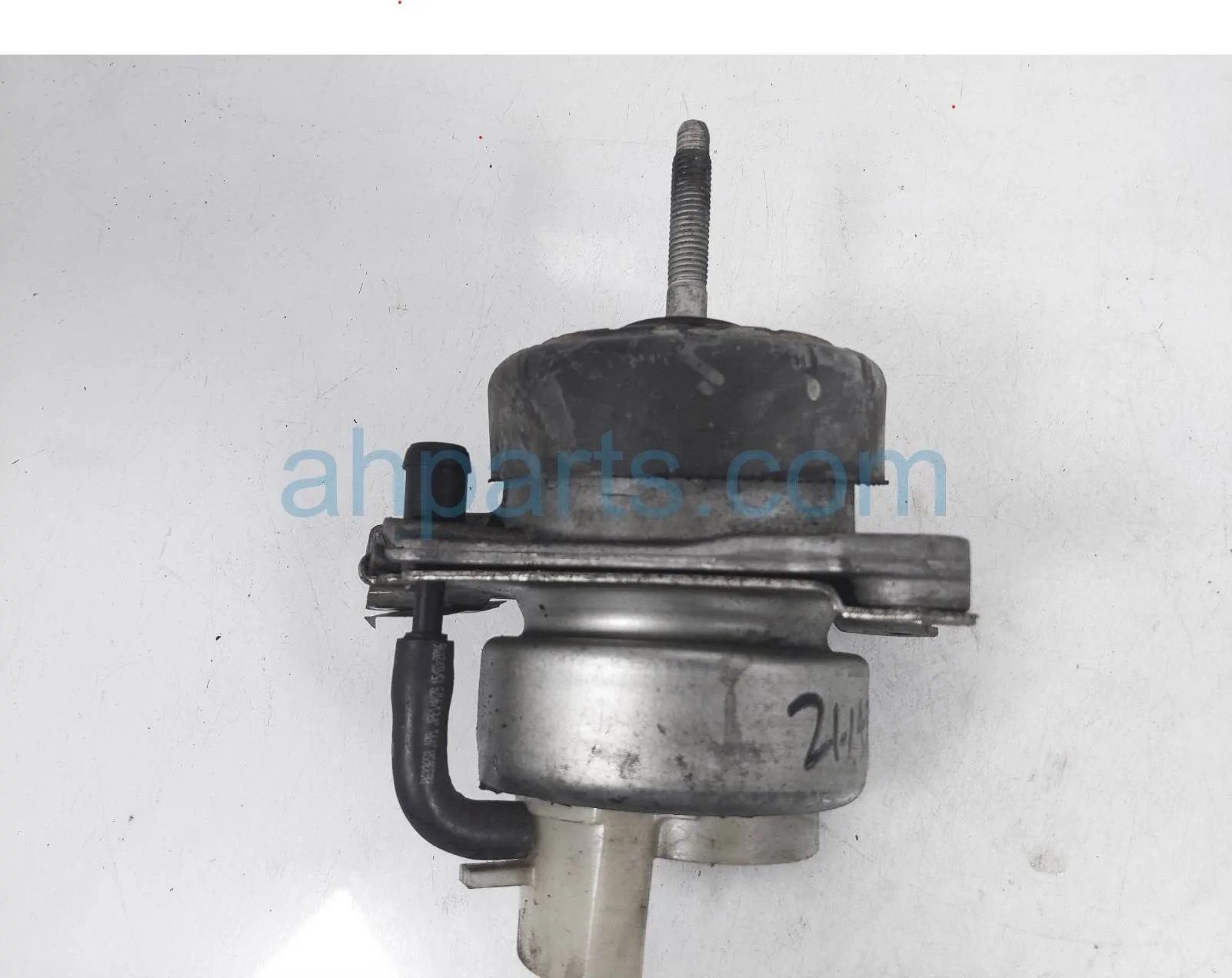

I think I now understand what's going on with the start-up bang & rocking of the car. I spent some time examining the engine mounts & I noticed vacuum lines going to both. I'm sure what's happening at start-up is that there's no vacuum in the engine mounts. Maybe it's normal or maybe there's a leak somewhere. I would expect some check valves or a reserve tank somewhere in the system to assure vacuum at start-up but I didn't see anything obvious. So most likely there's just no vacuum until the car starts and the vacuum pump starts to operate. That's why the bang and the rocking of the car only occur once at start-up. As soon as the vacuum pump starts operating vacuum is applied to the mounts and both symptoms stop.
Does anyone have a diagram of the vacuum system from the pump to the mounts? Or do you know where I can find one?

Looks like there's a small vacuum line connected under the mount. Did you check for cracks/leaks? Where the vacuum comes from may be here: https://www.mustangecoboost.net/threads/6th-eco-boost-breather-pipe.23584/
Thx. That's helpful. I noticed the vacuum system when I was replacing the brake power booster check valve. Apparently there's a vacuum pump located at the top/rear of the engine that creates the vacuum source for the brakes & engine mounts. And any other vacuum operated components under the hood. (Maybe the HVAC system too.) But I hadn't realized at the time that the engine mounts were vacuum operated (or assisted). Now that I realize that they are I suspect this is the source of my 'bang' problems.
I took the car to the dealer as soon as I bought it and they claim this 'symptom' is normal. Not sure why. I still don't think it is. I'll need to 'rent' the vacuum tester again and check the mounts. If I can figure out how to connect the vacuum lines to the mounts.
