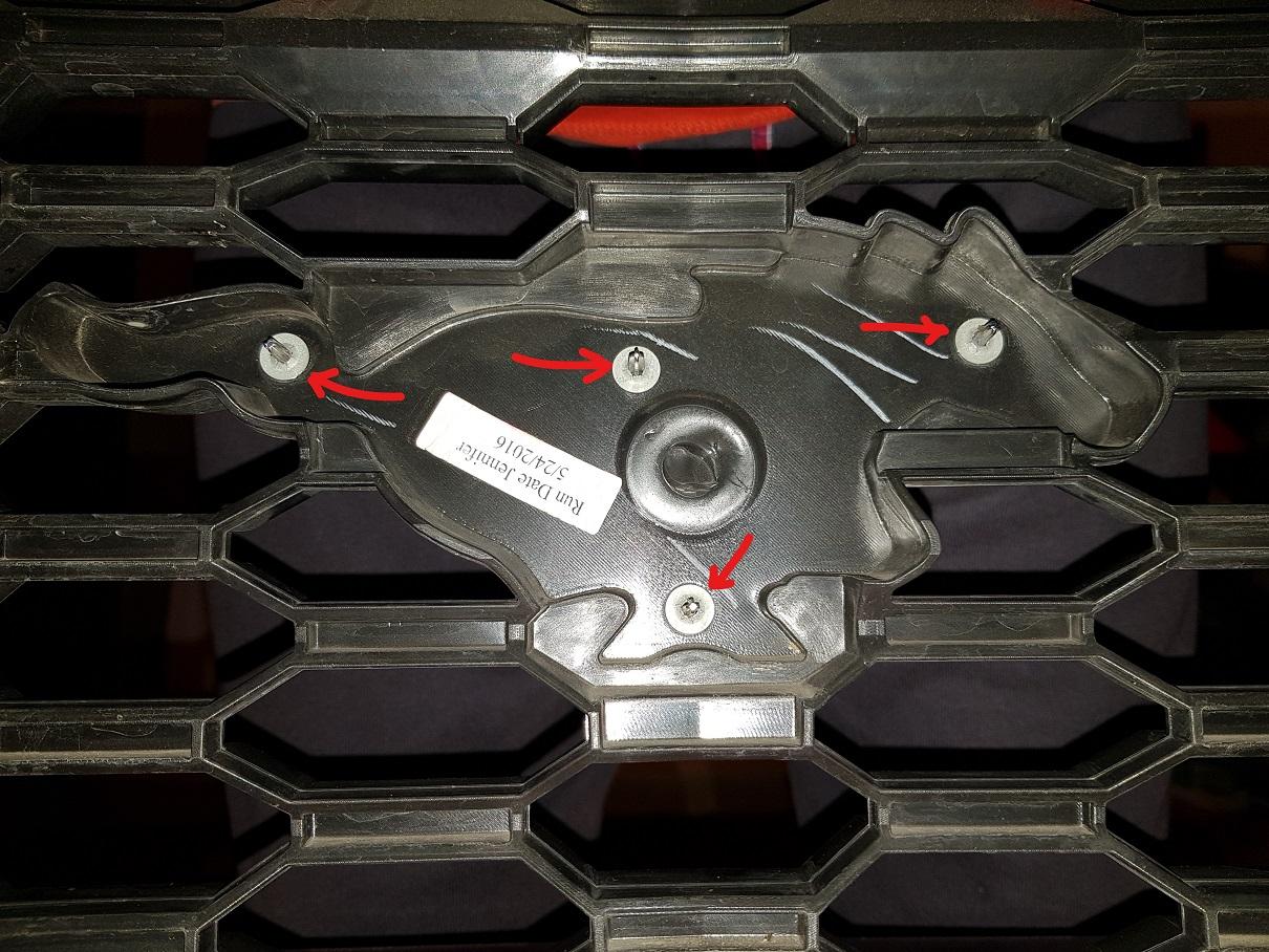

Sure. What I did is explained below, after following the detailed instructions that Rickycardo sent me:
After removing the radiator cover, simply reach for the tabs behind the grille that retain the pony in place. My Mustang is a 2017 EcoBoost and I have very easy access to the back of the grille after removing the radiator cover (maybe because there are no Active Grille Shutters in my European Mustang). Using your fingers (or the back of a small screwdriver or any other tool with a flat head) push the tabs back out, pushing each tab a little bit at a time. Do the same to all tabs. Take small steps each time, don't rush, you have to be patient. It seems that the tabs are tapered, so the more you push them out the easier it becomes.
I took my front pony emblem out already, it took about 10 minutes to do it.
For those who haven't done it yet, the picture below shows the 4 tabs that retain the pony in place:
Now you can put a new emblem on your grille and keep the original one as well, in case you want to put it back on or even sell it! :headbang:

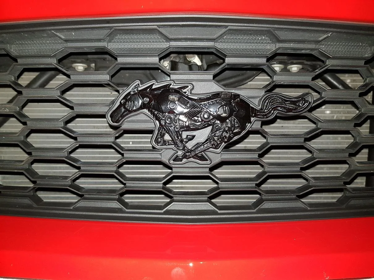

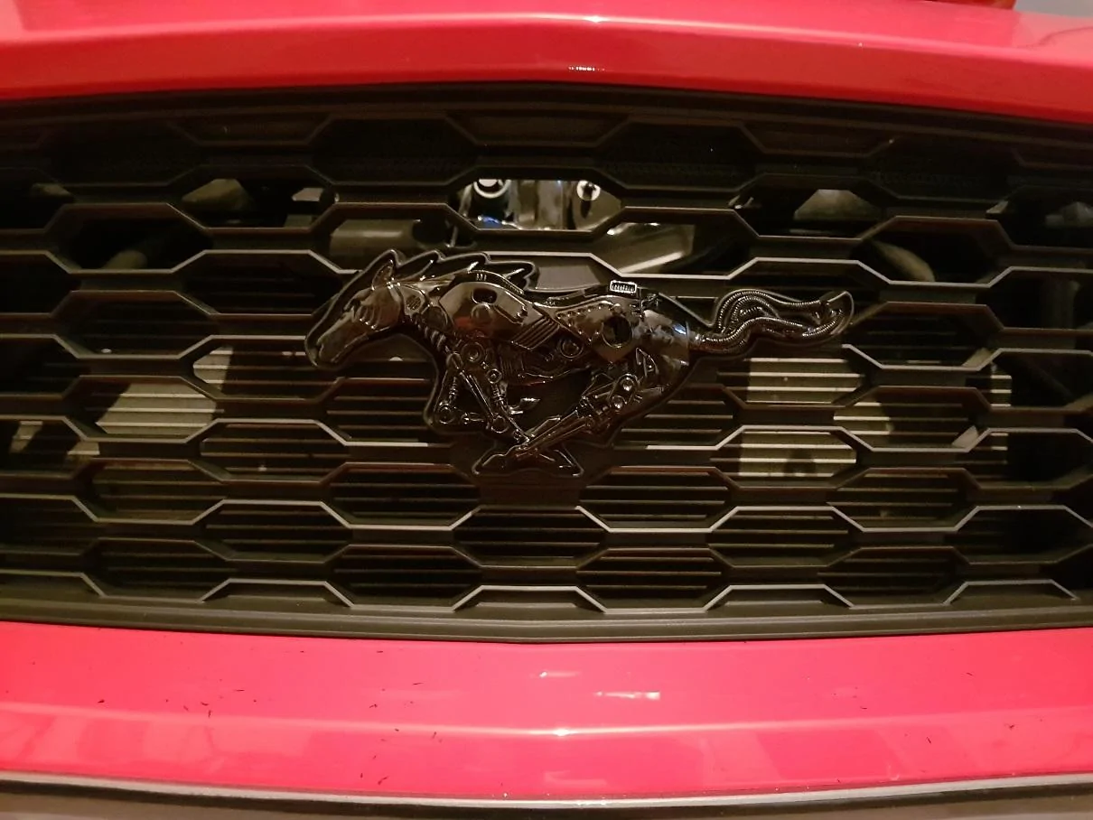

Just installed the Stanginator. I had to use a drill in order to widen the holes where the previous pony was sitting, because the studs on the Stanginator were a bit wider and slightly miss-placed. Other than that, all good. I show two pictures with different lighting conditions :headbang:
This is officially the first Stanginator in Greece!
