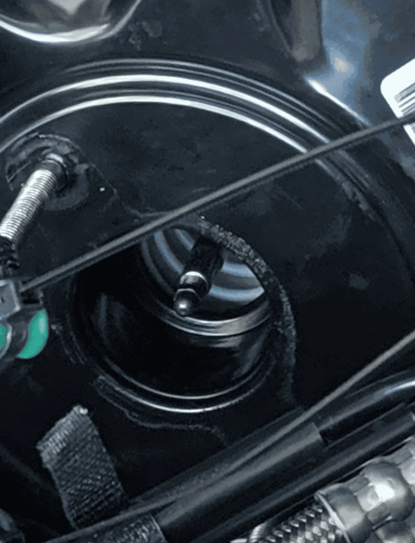

I also bought this tool to make sure the distance between the booster shaft and master is correct before I install everything. We do have an adjustment nut on the booster shaft so you can adjust the length of the shaft if it is off.

You cannot reach the master cylinder plunger unless you completely remove it. The studs on the booster are too long and you need to disconnect the hydrolic line in order to even access the inner/back of the master where the booster shaft sits.
I have the same issue since I bled my brakes when I painted my calipers. I pressed way too hard on my pedal while bleeding. Afterwards I was getting a squeaking sound also from inside. Tried everything and nothing worked.
I bled the brakes probably 10 times and it did not fix the problem.
I am now in the process of replacing my booster and master. I checked my booster shaft and it looks bent. That is why I am buying everything new.

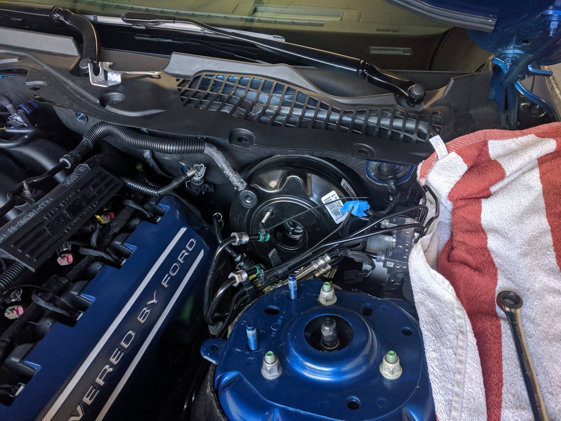

Not only you have to bleed the brakes many many times over you also have to bleed the ABS unit and you need a scammer in order to do that. When you get air in ABS unit is one nightmare of bleeding process.
Picture of my master taken out and booster is next. Just waiting on the parts to arrive.
Nice 350. I do have an extended warranty, but since I changed the calipers I'm thinking they might deny the claim. I might try to bring it in anyway and see what they say. If not, and all the simple fixes don't work, I guess $200 isn't bad and it will give me an excuse to update the booster and master cylinder to the PP version. I think they're only a few $$$ more than the stock one.
