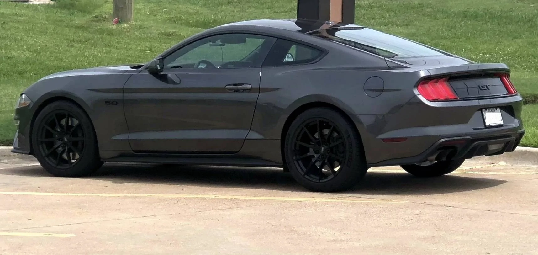

275/40/19 on 19x10 wheel (in my case LMR SVE S350), 40 offset. Stock GT PP height. Rotates perfectly, fits perfectly front and rear, no spacers, no rubbing, hard daily street use.

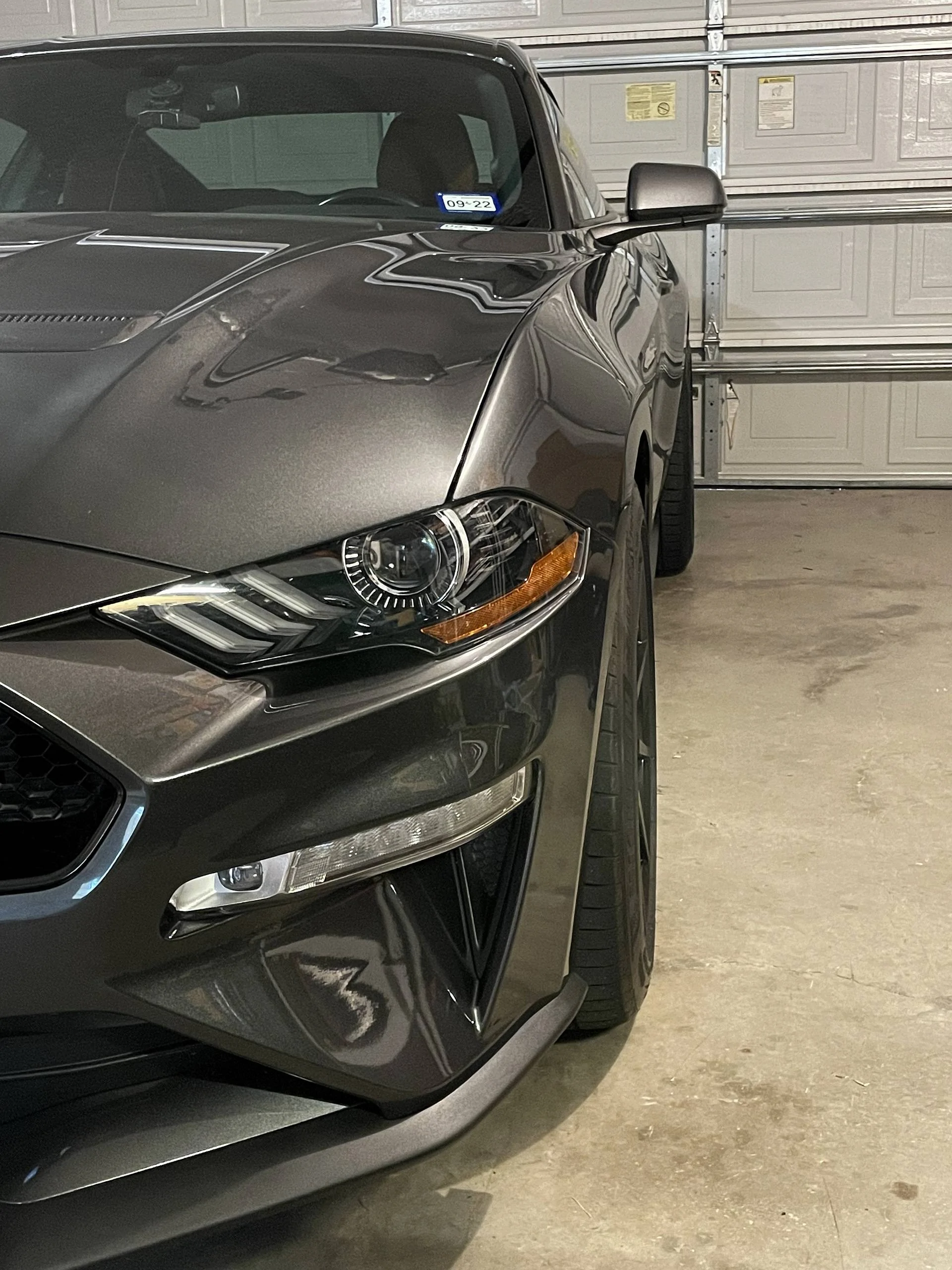

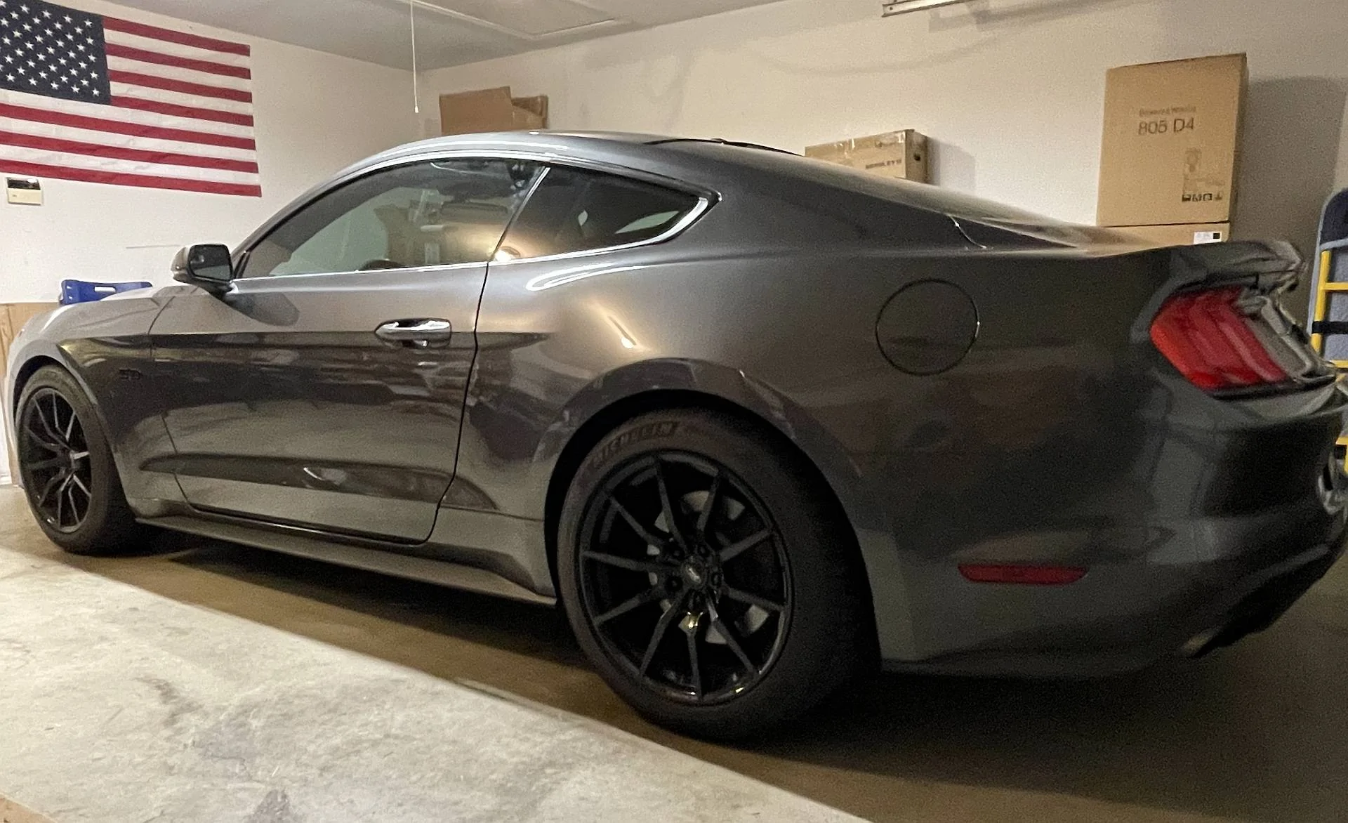

A couple of rough ones but you get the visual idea... (can't back up enough inside the garage...:wink:)
