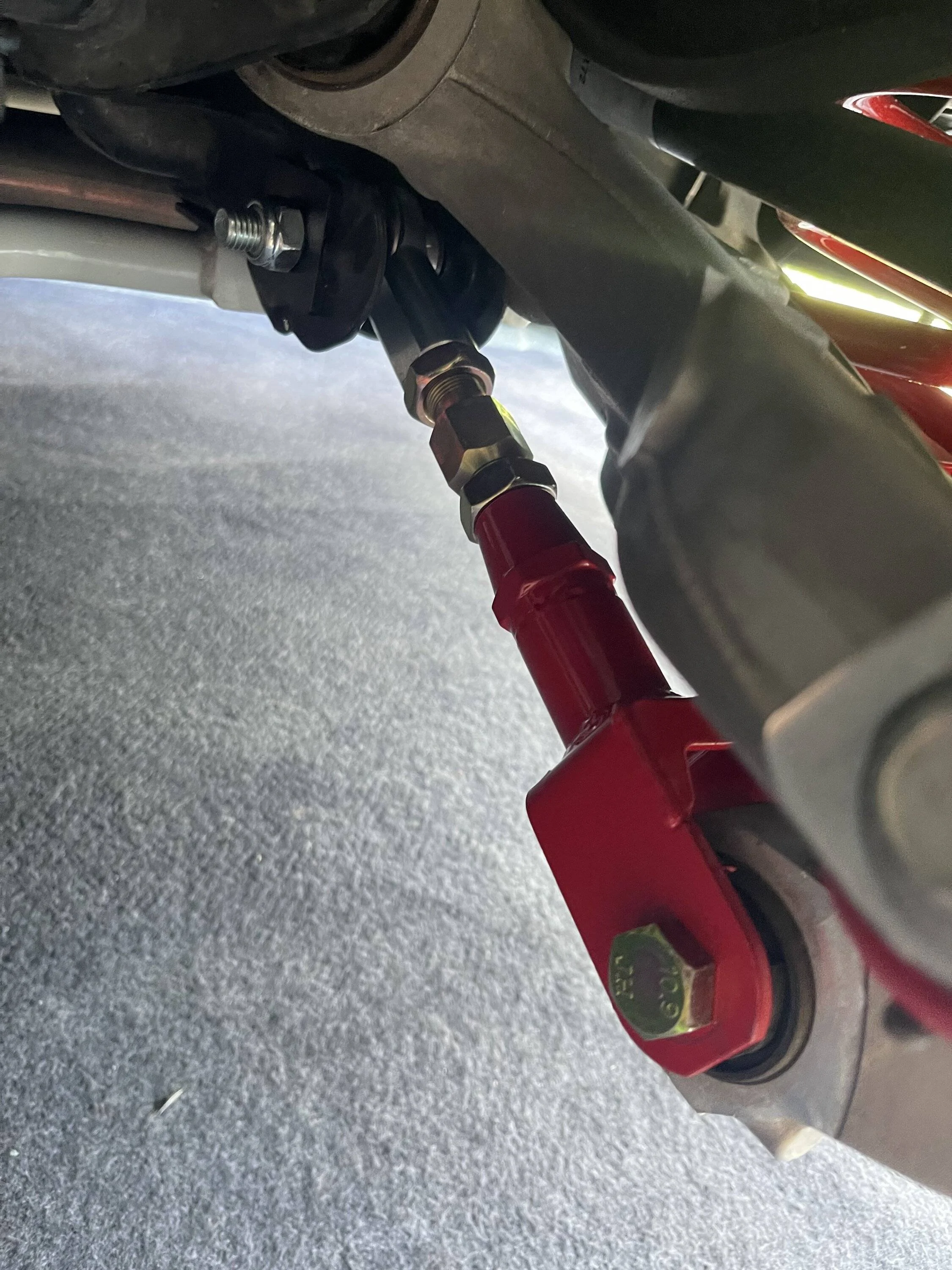

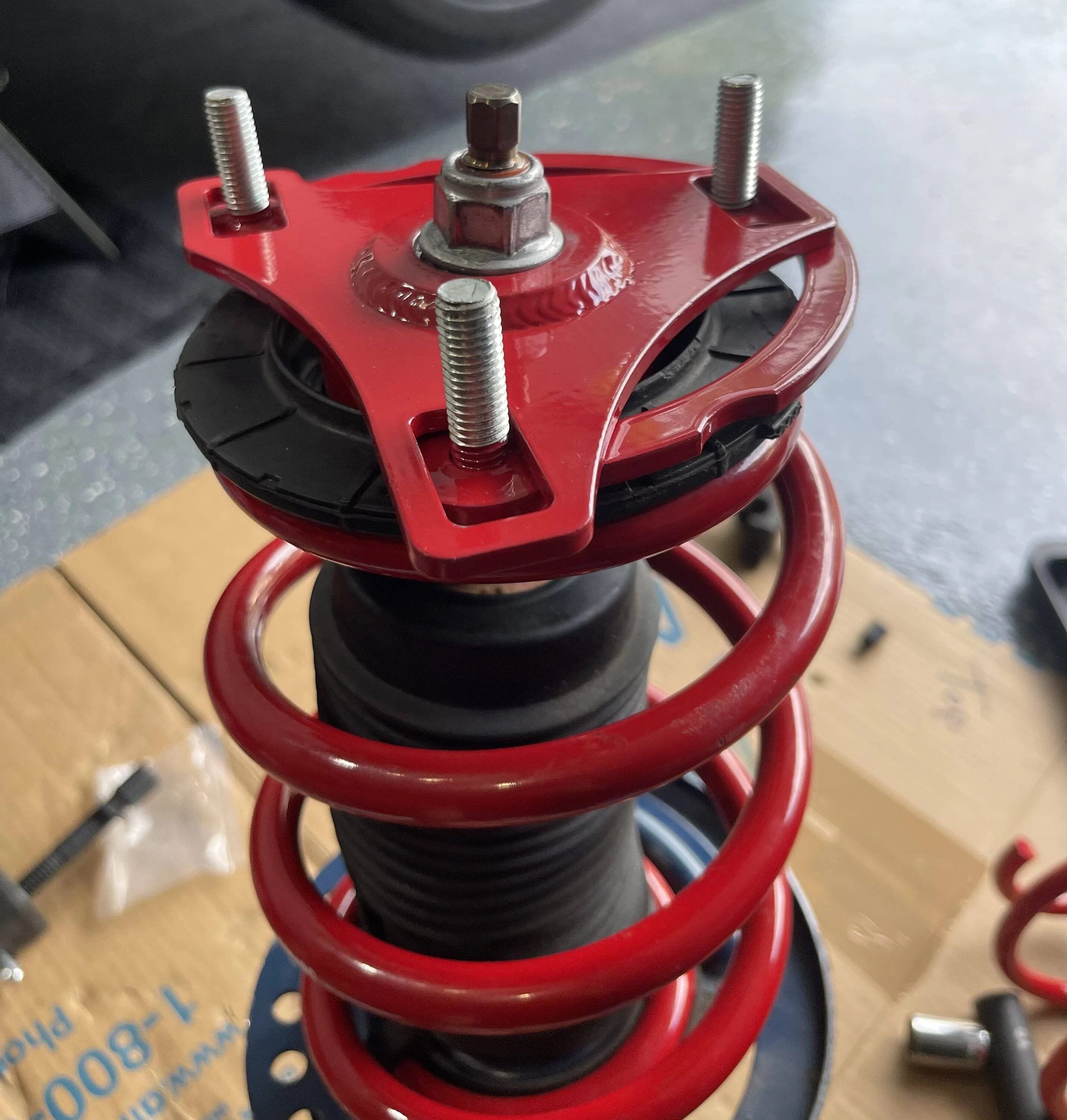

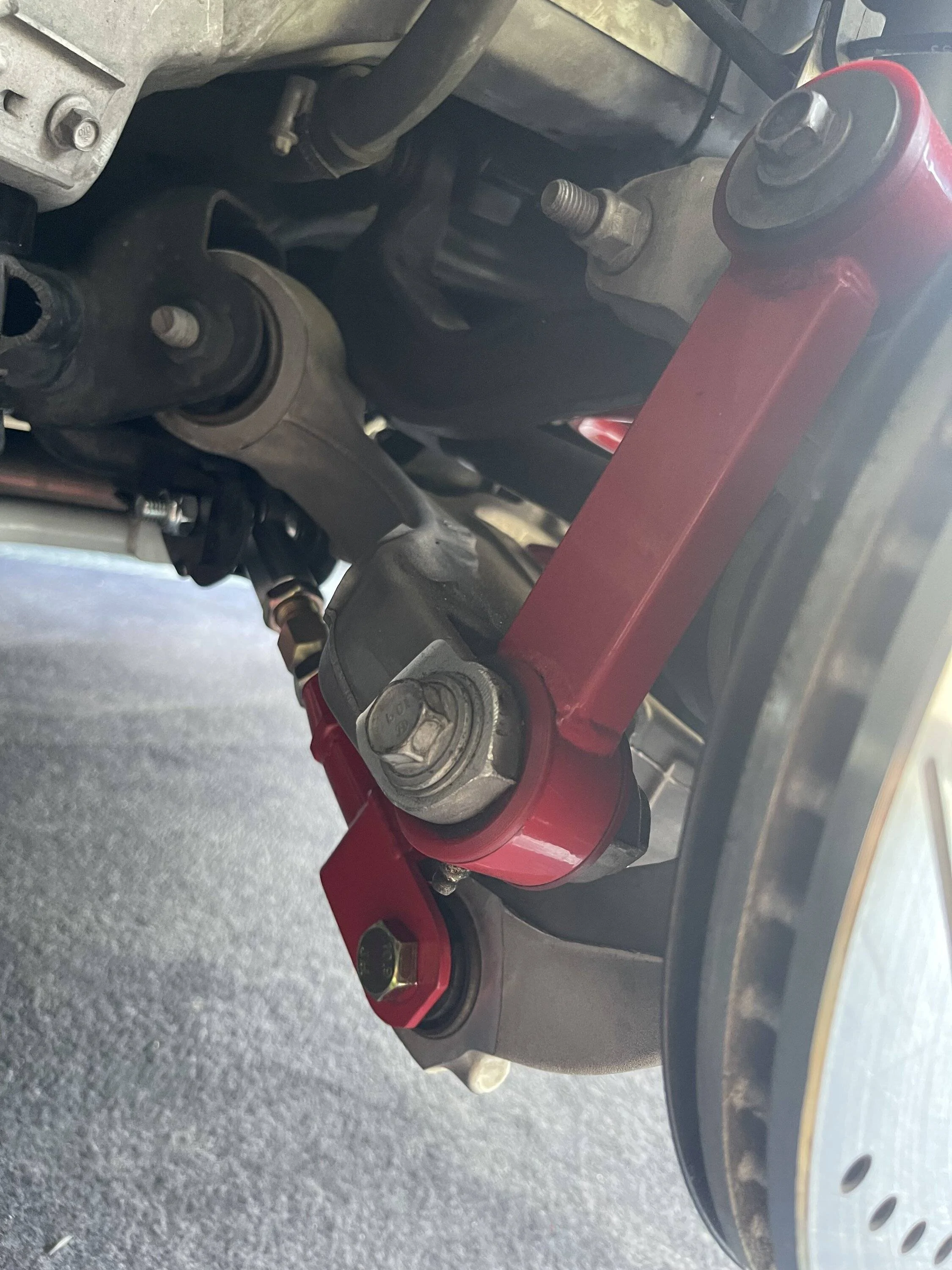

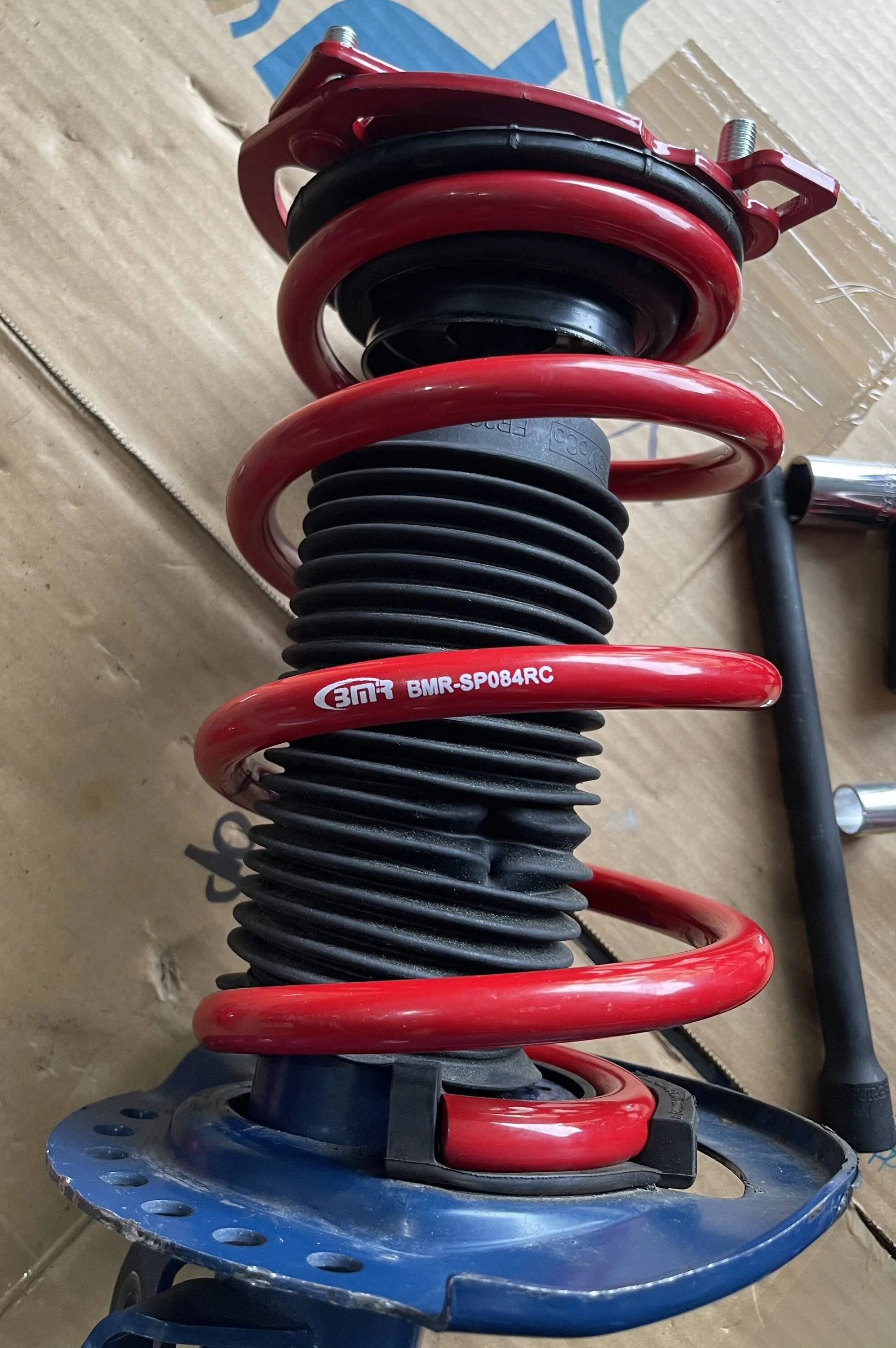

I had Ford Performance track dampers and shocks with FP track springs (Y), and I couldn't believe how soft it was compared to BMR 083 springs, lol. Seriously, for a street only application, I would consider BMR 083 to be absolute max firmness. Anything beyond this would be too firm for a daily. I find BMR to be compliant on most surfaces but I do get jolted around on rough roads and bumps. More road noise also and I feel road surfaces through the steering wheel, but I still cannot figure out what my front tires are doing. The steering is little quicker as well, but again no meaningful feedback.

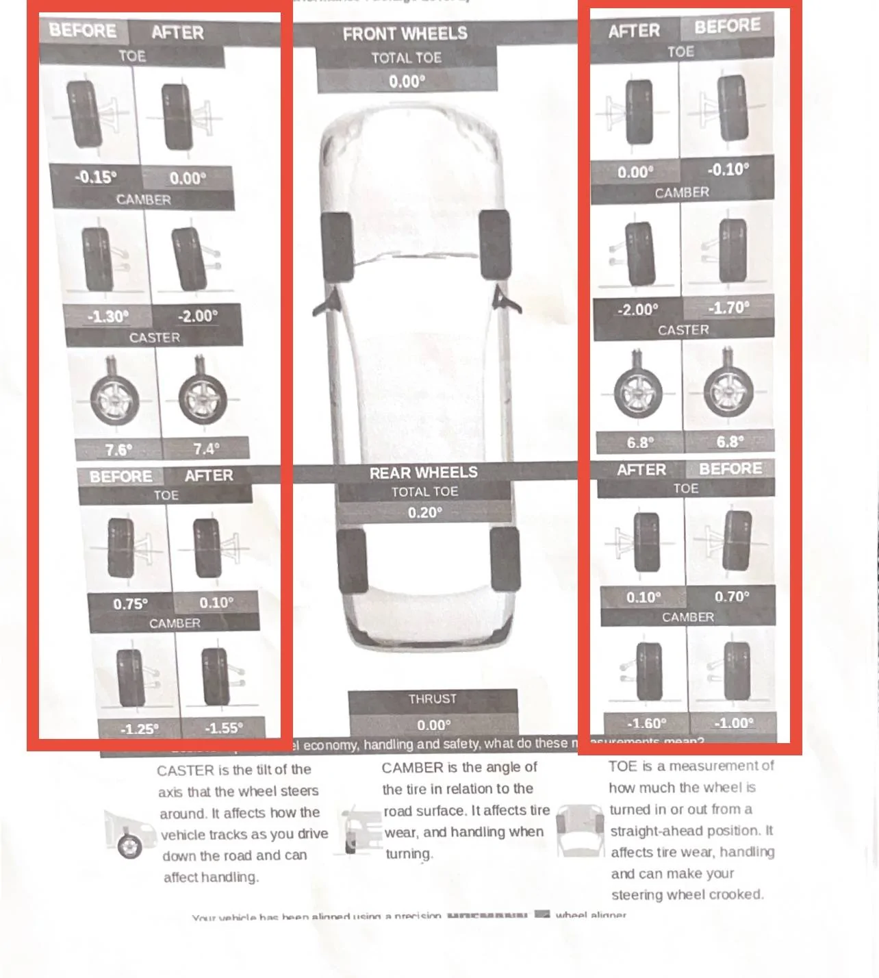

Anyways.. I installed BMR Toe Rods and BMR camber plates the same time and I cannot believe that I got the exact alignment I wanted. I told the shop for -2.0 front camber, 0 toe, -1.5 rear camber and 0.10 toe-in both sides, and my shop was able to do just that. Also, bushings were clocked the same time, which dropped the rear 0.25 inches more (great!!)

With the components you installed, it would be a tragedy and an insult if they didn’t get it aligned perfectly. You should not be surprised. Good numbers too.
