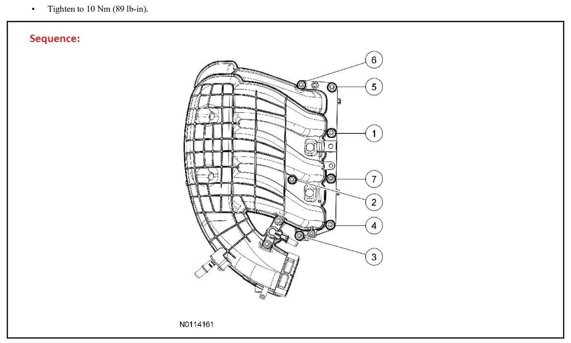

Hey guys! I've messed around with my car lately and I've noticed I have a microleak. I removed my intake manifold and I guess when I put it back I just tight it hard and now I have a microleak. Anyone knows the torque specs and pattern to get it back in place? I'm about to be done dealing with this car:(
Thanks for y'all's help!
I found this for the 2011+ (I know our intake is a little different but I guess it should be the same for our 6thGen). What y'all think?:shrug:

Well, I did the torque specs and the bolt snapped... I will have to find a way to extract it. FML

Did you do 89 ft-lb, or 89 in-lb? I can't believe a bolt snapped at 89 in-lb. That's only about 7 ft-lb.

My torque wrench is only ft-lb I did 7.9
