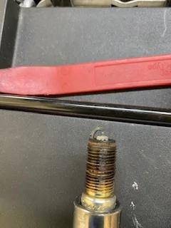

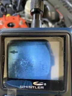

I have a 2015 Mustang 38k miles with a Whipple gen 3 supercharger. I just changed the plugs and I noticed oil on the threads. The plugs seemed to be gapped inconsistently.
#4
#1
#8
#8

Throw a new set in gapped at .026”. Drive it. If there’s no misfiring and the logs look fine. Continue enjoying the car.
