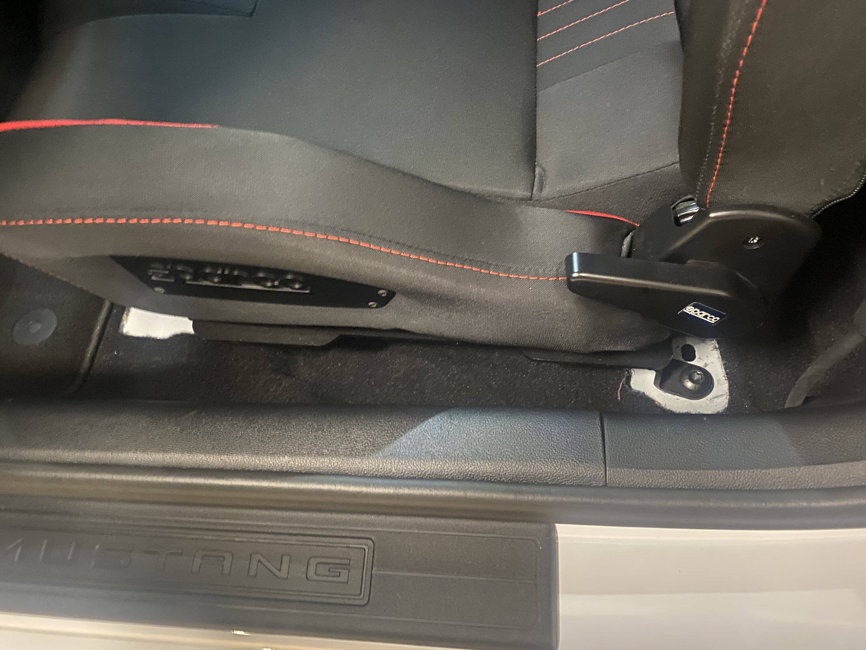

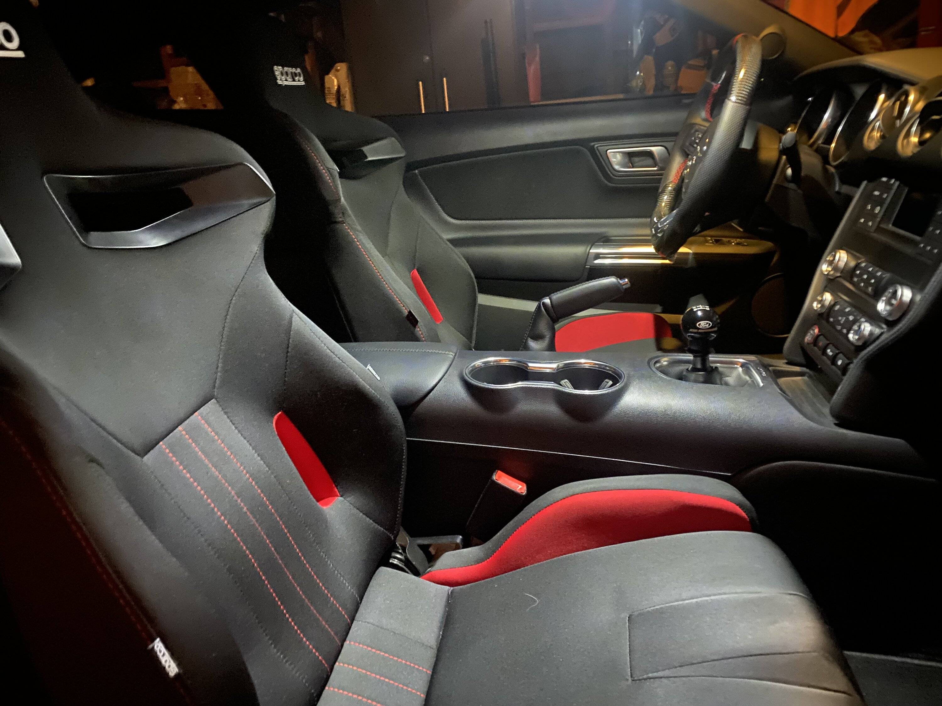

Recently installed some Sparco seats. Where they mount to the floor is left exposed and the stock covers don’t fit. I can hack them to shred and make them work, but I’m looking for something better… anyone deal with this or have any ideas?
Thanks-

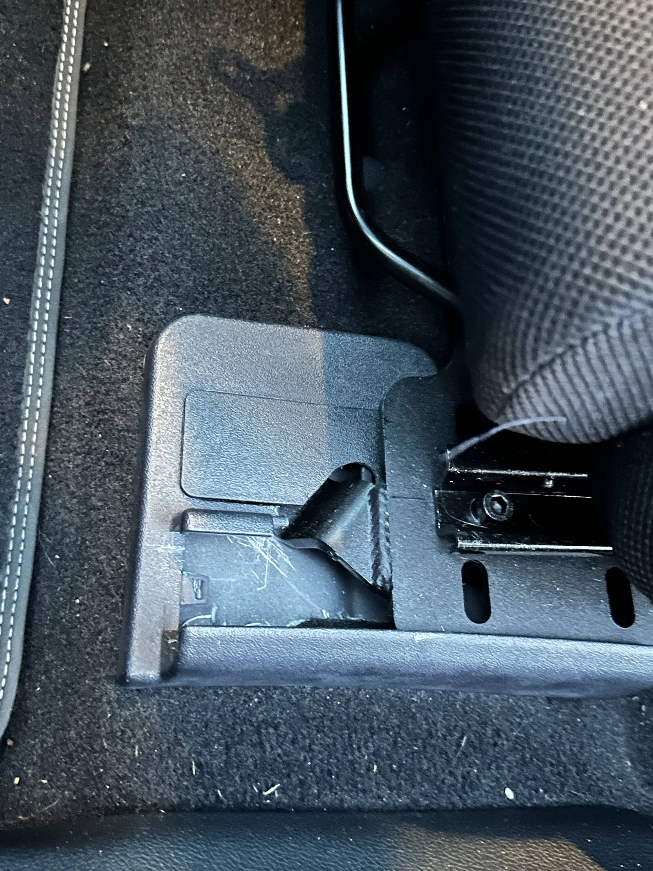

I cut my plastic pieces to fit… only choice unless you want to find matching carpet and try a make it look right.

That’s kind of what I was looking at as my last resort… I like how you did it though

I just marked it the best I could with a sharpie and used a rotary tool to cut it. You can’t see my back ones cause I’m 6’3” and the fixed back seats are all the way back.

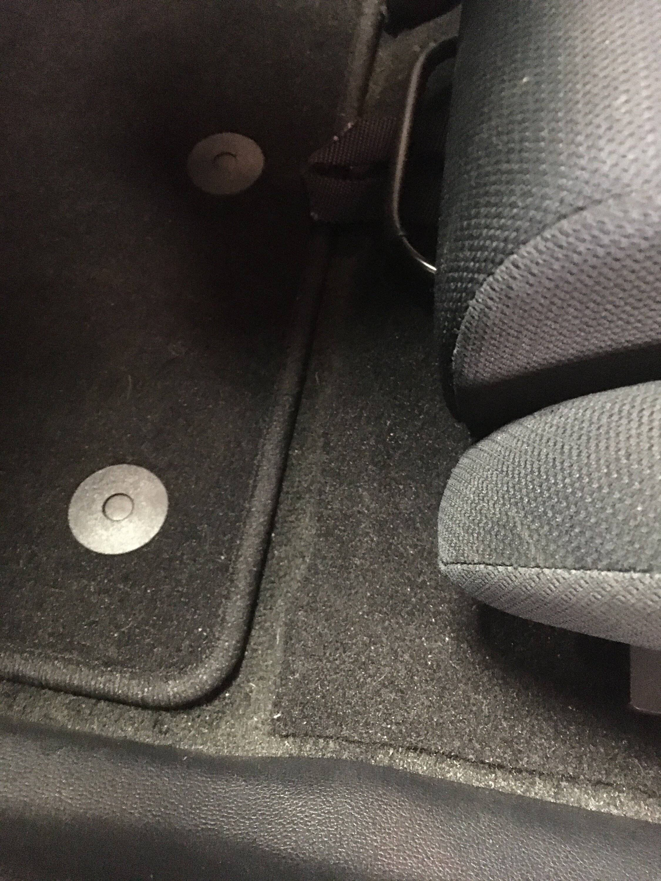

A piece of cheap part store black carpet with stick on velcro on the metal floor to retain it

What are those seats? Do you have more pics?
