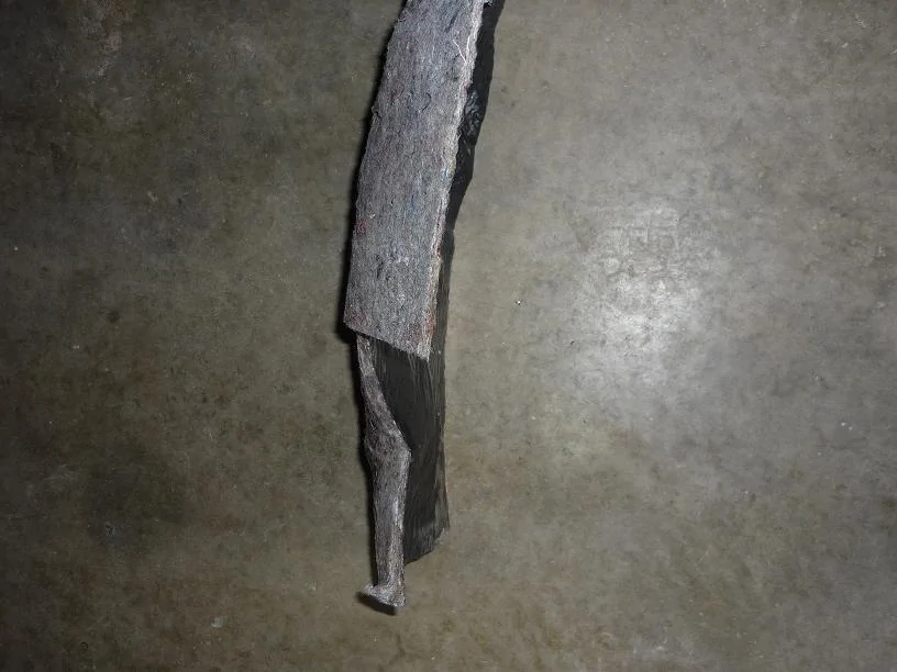

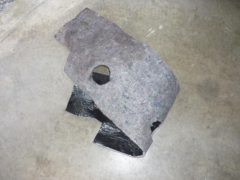

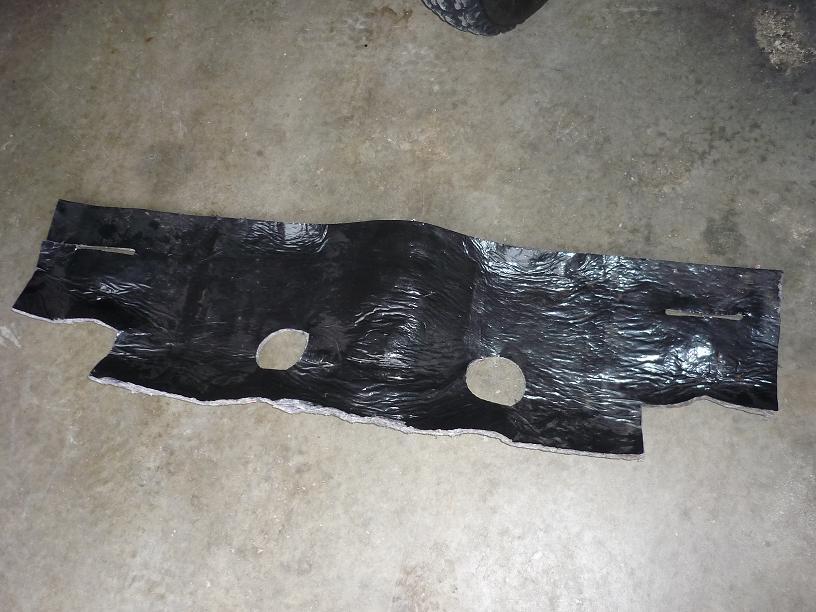

Haven't removed it from a 2015 yet but on my Mustang I had to remove the front seats, bottom rear seats, carpet and door sill panels. I was doing a rear seat delete and changing my front seats at the same time along with some other stuff, but it was pretty much a days job from what I remember. I'm not sure of the exact weight but it wasn't really as much as I thought it would be and you do get more interior noise with it out.
If you're going to do other weight reduction mods then it's a good thing to do IMO, but if you're not and your car is a daily driver that probably isn't going to be raced at the track more than a couple of times in its life then you probably won't benefit from it. From my experience weight reduction mods add up over time as you do more of them.
Here's a few pictures of what was under my back seat. You can see how thick the stuff was.

Out of curiosity what do you think the weight of that is compared to dynamat?
Probably not worth it for most people but I'm curious if we could reduce weight and NVH slightly.
