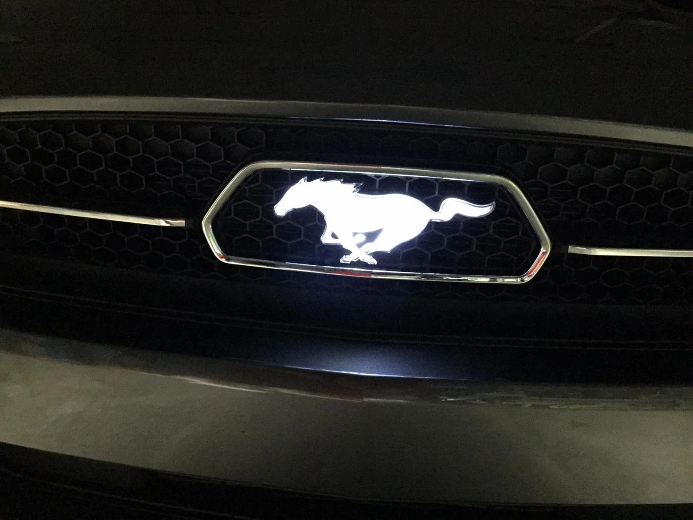

Any pics of it lit up?

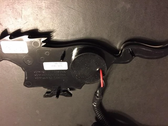

You have to drill a 1 1/2" hole in the grill where the pony mounts for the light. You can see it in the pic below.
Correction: The red above is incorrect. The installation instructions clearly state what to do if the car has the active grill shutters and what to do if they don't. To access the back of the grill and the driver's side parking light, they have you remove the belly pan if you don't have the grill shutters.

OK, after thinking about it a little more I decided to go ahead and install it myself. It's not going to hurt their figuring out the install charges. As I expected, the install was very easy. Here's some notes from my install in case anyone wants to do this. Keep in mind, my car doesn't have the active grill shutters so I didn't have to remove the bumper.
  1. If you are going to install this, some tools you might want to have.
    a) A 1.5" hole saw. I thought I had one of these I use for installing house doors but it turned out that was 1.25" so had to make a run.
    b) A 1/4" drill bit
    c) A 3/16" drill bit. I used this to drill the hole on the top center of the grill pony mount. They tell you to use a 1/4" but that is a bit large.
    d) 7mm socket (and 5.5mm socket if you are removing the bumper).
    e) Drill
    f) A 5mm deep well socket. This is used to push the retaining clips on the back of the new pony. You can use something else.
    g) A pushpin removal tool.​
  2. Be prepared to ruin the pony that is currently on your grill. Removing it without breaking the pins off the back is near impossible. The instructions just tell you right up front to brake them off.
  3. Also, know up front the pony lights up with a blueish tint to it. It will not look as white as the other lights.
  4. The instructions tell you to remove the belly pan to access the back of the pony and the driver's side parking light. I decided to remove the radiator cover figuring it's easier to get off and easier to reach the back of the pony. The problem was, I wanted to do a very clean install and for good cable management, I decided to jack it up and remove the belly pan any way. I was glad I removed the radiator cover still because reaching and seeing the back of the pony from the bottom would have been very difficult and was very easy from the top. Removing the bumper would have made it easier to fasten the retaining clips on the new pony, especially the one on the tail but I made out just fine with the bumper installed.
  5. When installing the new pony, be careful pushing the retaining clips on the plastic pins. Think of how easy those pins were to brake off removing the original pony. You don't want to brake the pins off the new one.
  6. When you're running the wires from the pony, don't just run them straight down or you will see them through the grill. Pull them straight back, tie them off and then run them over to the driver's side.

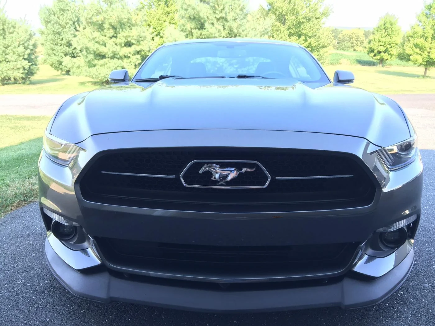

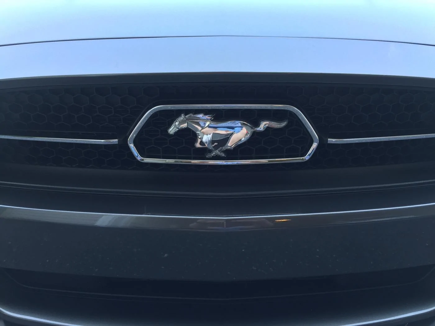

I will get pics up after it gets dark. I will post both daylight and night time pics.

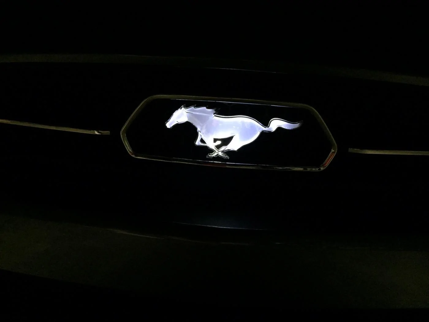

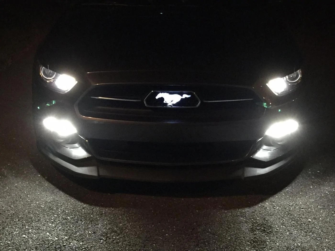

I'm not seeing any noticeable blue tint which is good. Maybe its more visible in person.
One of the closeups show a bright consistent light from the entire pony but another shows splotches that are very dim. Is that from the amount of light changing as it heats up or something else?
jbailer
May 1, 2015
43
3,270
1,297
Maryland
Joe
2015 EB Magnetic Premium PP 50AP
The blueish tint is more noticeable in person I guess. I'm not that good a photographer. I'm not saying it's blue, just bluer than the other lights. From further away you don't see it.
I haven't noticed any change with heat. The one that looks a little splotchy is what you see when you are close to it. When you are further away, it looks more like the picture that is even. That isn't why the pictures are different though, one picture just exposed more than the other. You can tell in the picture that it looks evenly lit, the bumper is brighter. I believe the reason it looks that way is probably because all of the light you are seeing is being reflected off the chrome and brought around by the acrylic or whatever it is.

So seems like a good product. Thanks for the info and pics!
