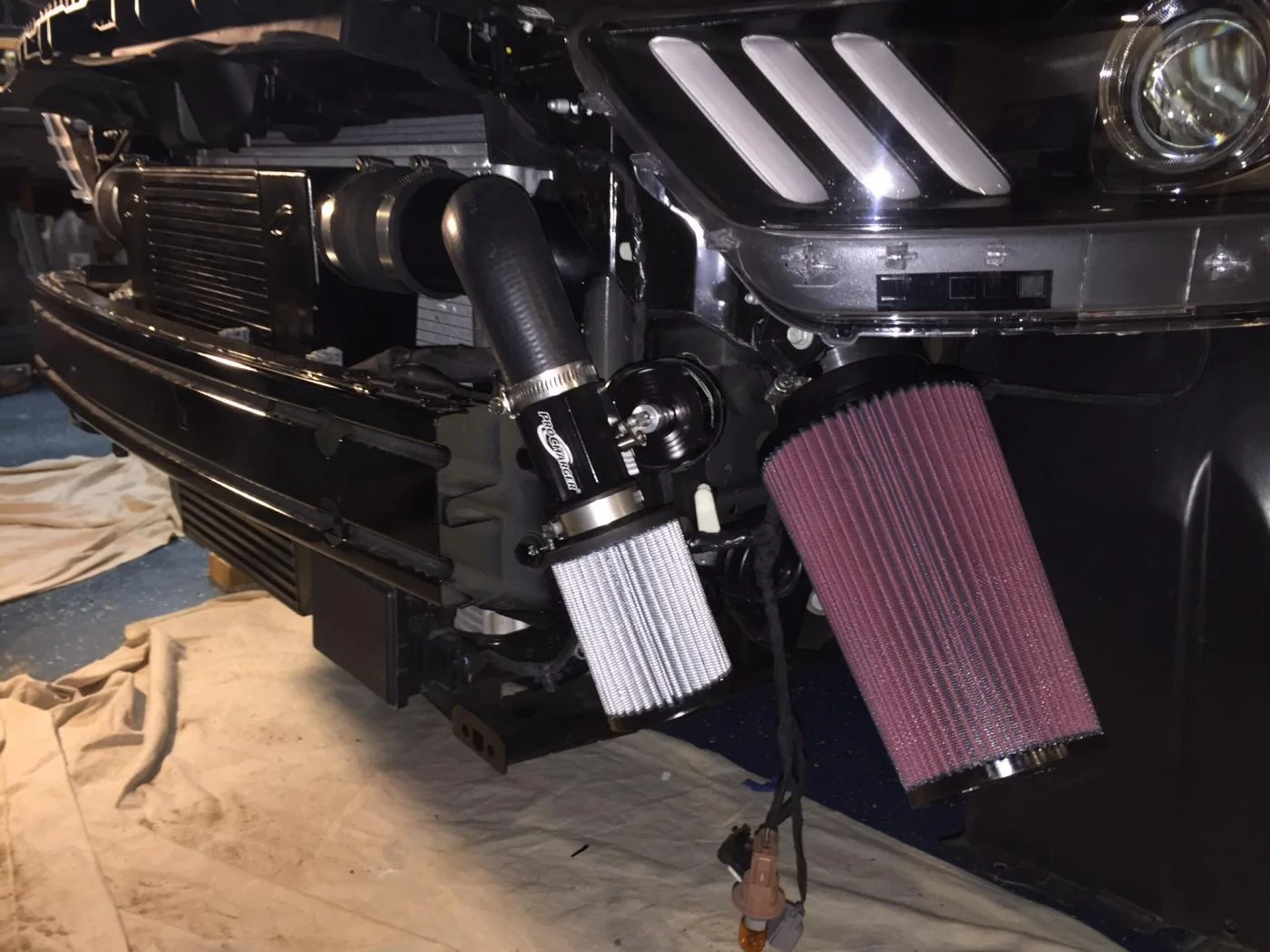

And remember no one has a "true" cold air available. A intake that is sitting high up sucking in heat is not a cold air. It's a hot air intake. When the hood is shut, the IATs will be way way past ambient temps. In most cases it will perform way worse than the stock airbox. In fact the only cold air intake I've seen is from ProCharger. The temps are always ambient or 3 degrees above. That is a cold air. Also the intake is very close to the ground.
