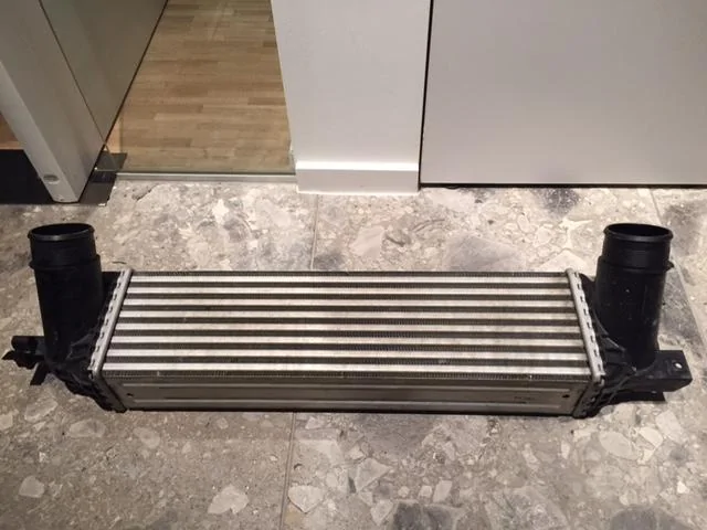

Today some new MODS were installed !
First we had to remove some basic stuff:
Now back to real business !
Intercooler installed....no pictures...
Nice! Can you please report your charge air vs ambient temperatures after some serious driving? I've read Mishi is one of the worst intercoolers there is, so I want to know how it really performs.

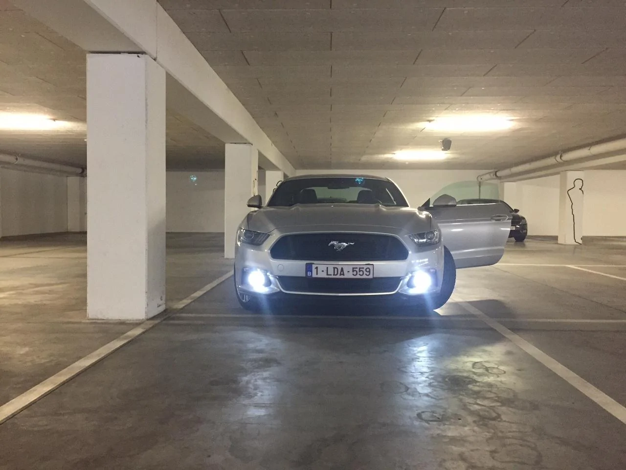

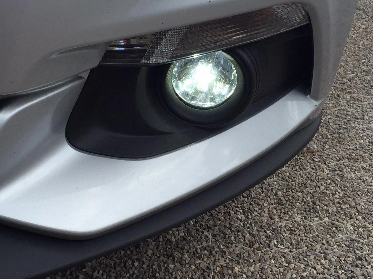

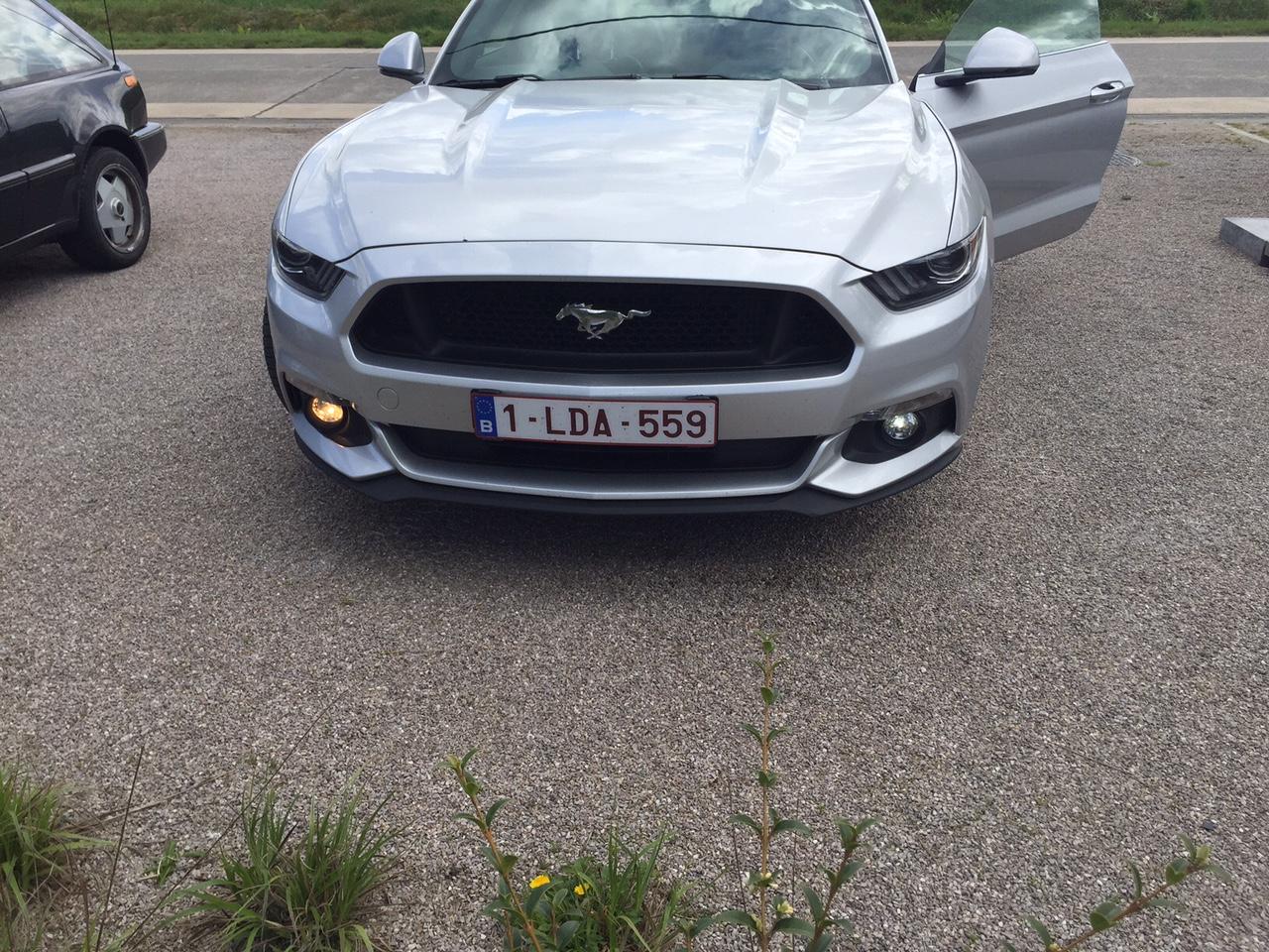

Next MOD onboard ! DRL LED

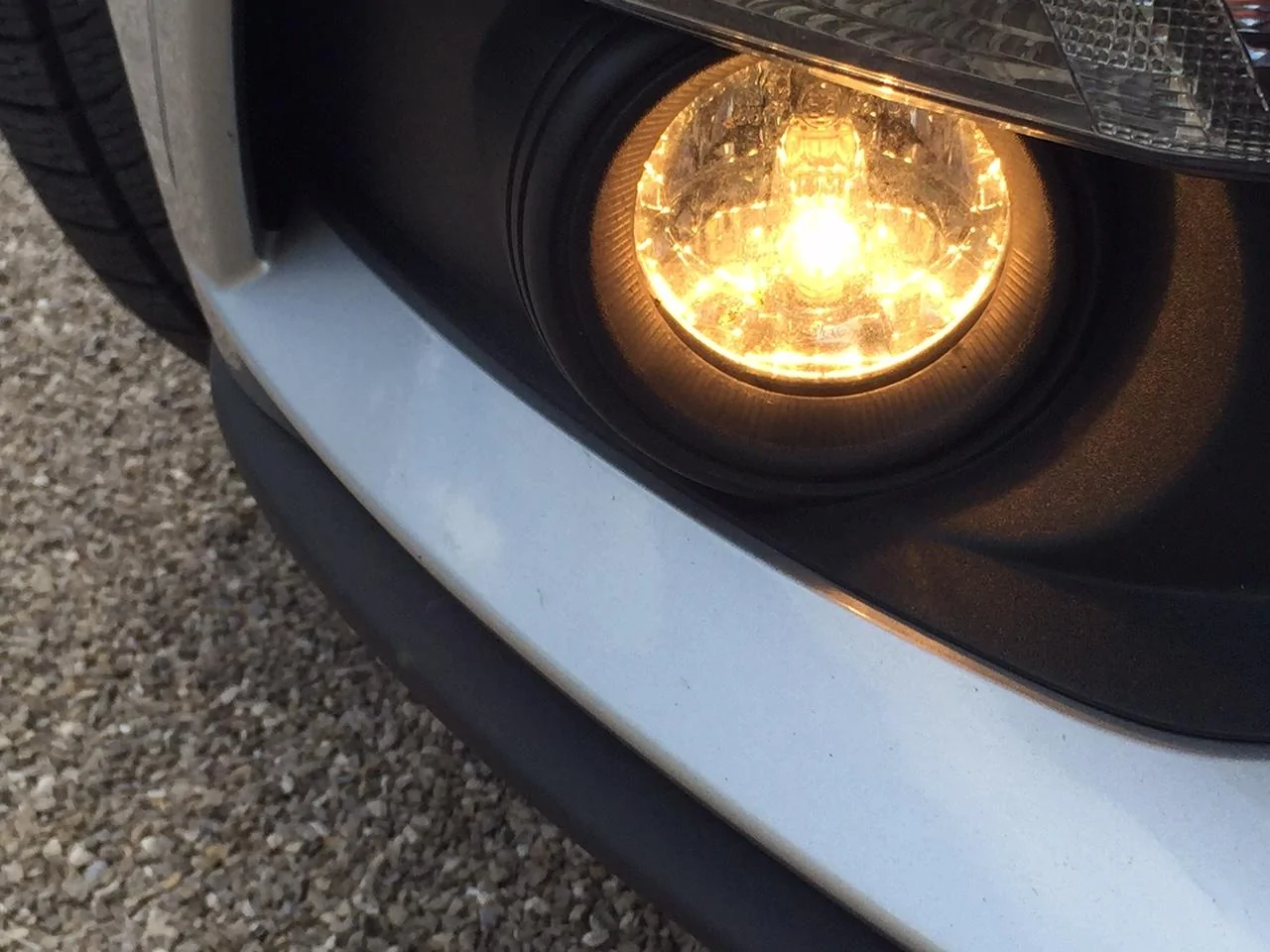

Finally deleted these ugly yellow/amber lights
and replace them with these nice 25watt power LED's
Check out the difference

lol... nice "fogs" though... ;)

No LED fogs (Yet) It's a 25Watt power DRL upgrade

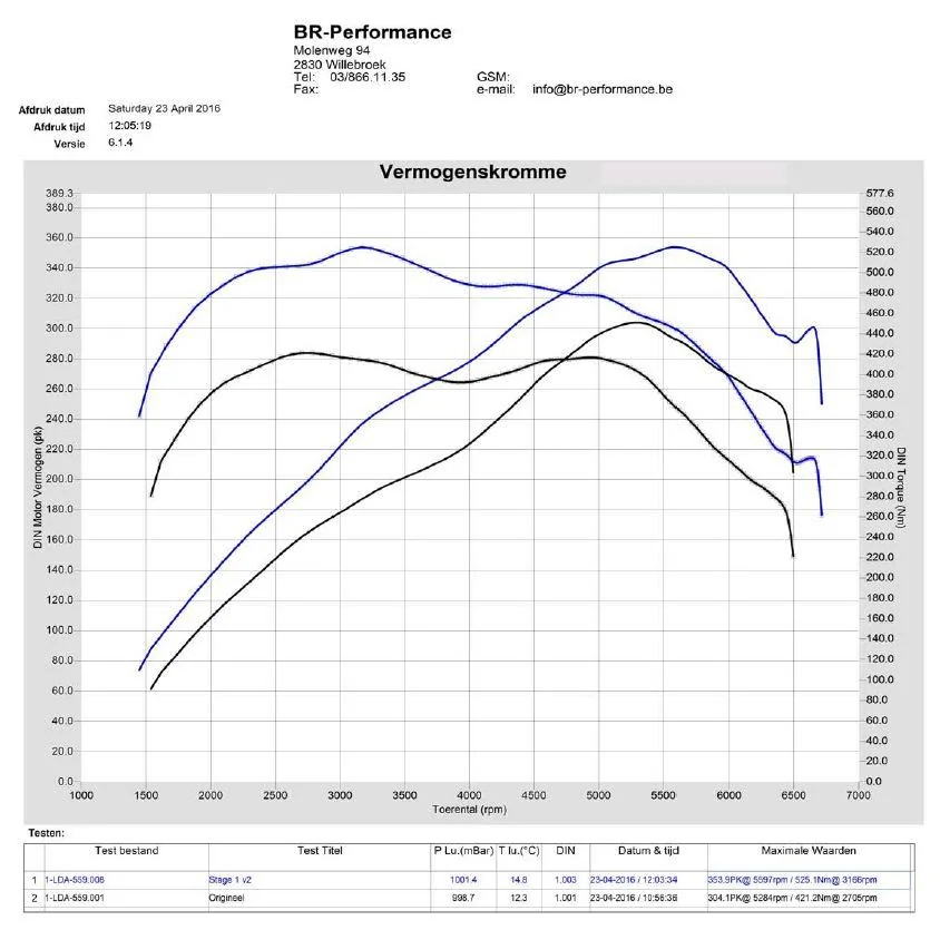

Interesting days....

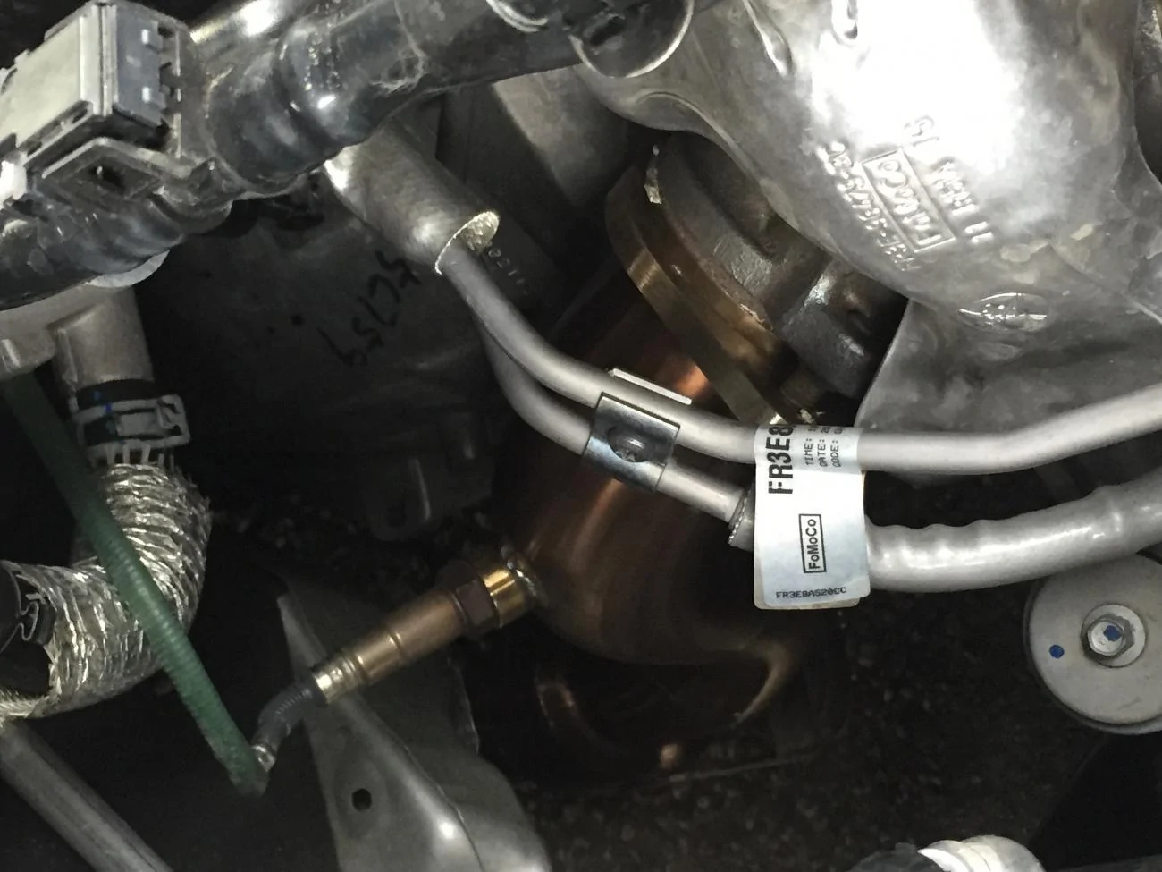

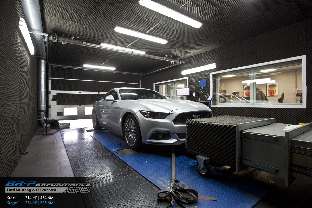

Yesterday my dealer installed a Mishimoto Downpipe :):

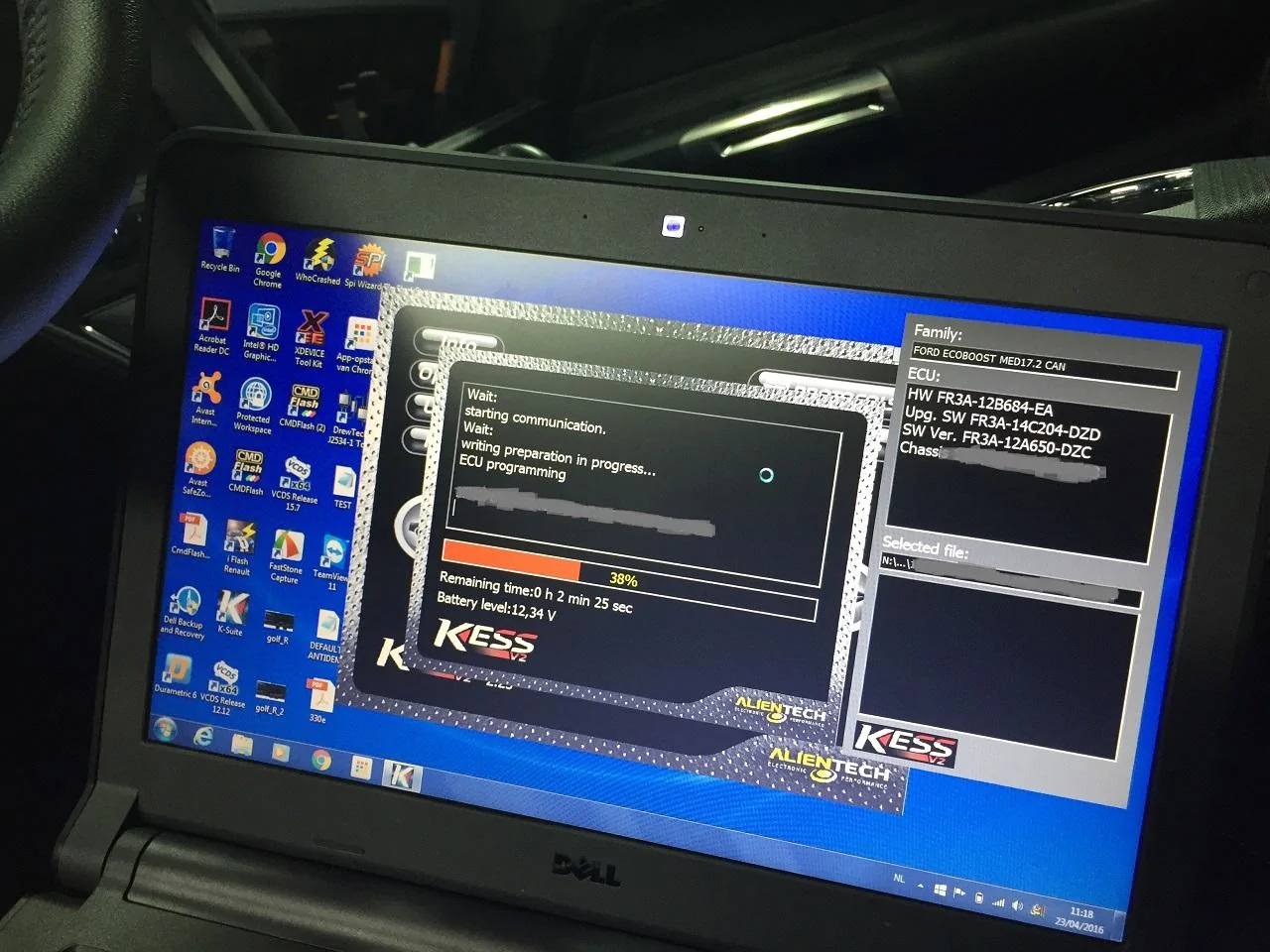

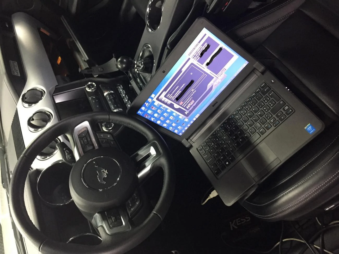

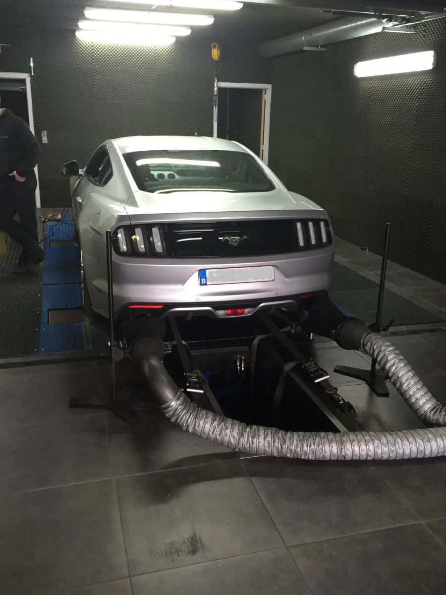

And today I went to BR Performance to have the car updated with a stage 2 Tune. Previously I had a Mishimoto Intercooler and K&N air filter installed. These 3 accessories aren't suppse to bring any additional power without a tune according to the site of Mishimoto but they would allow me to go for Stage 2 instead of 1.

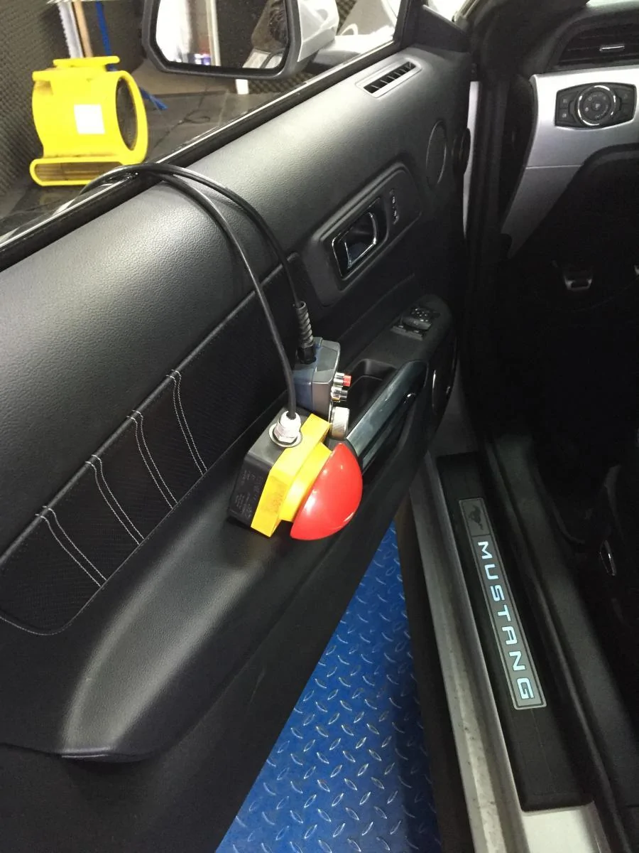

Preparations (tightning up the ecoboost before it becomes an ecobeast, get some exhaust suction tubes installed and position a massive front ventilator to cool off the engine):
And added some security measures in case things go wrong :eyebulge:
We started at a modest :D 304HP and ended up at 354HP!! :clap2:
This is what the Dyno thinks about the car...
The results of the jury :
A new car is born...:first::amen:

Impressive Régis!
Nice to read it and see your car change and get updates all of the time.
And the 525NM .... Drooling.
At one moment you talk about your dealer, is that your Ford dealer and if so which one? Or do you talk about a (local) garage that does the mods and tune?

The dealer CIAC in Ghent installed everything so far except the tune. This was done by BR-Performance. You'll find their info above on the dyno report sheet. ASk for Yannick, they have a nice experienced team and do the tunes for Mc laren Germany as well.
I'm gonna post the dyno movie, quite impressive !
