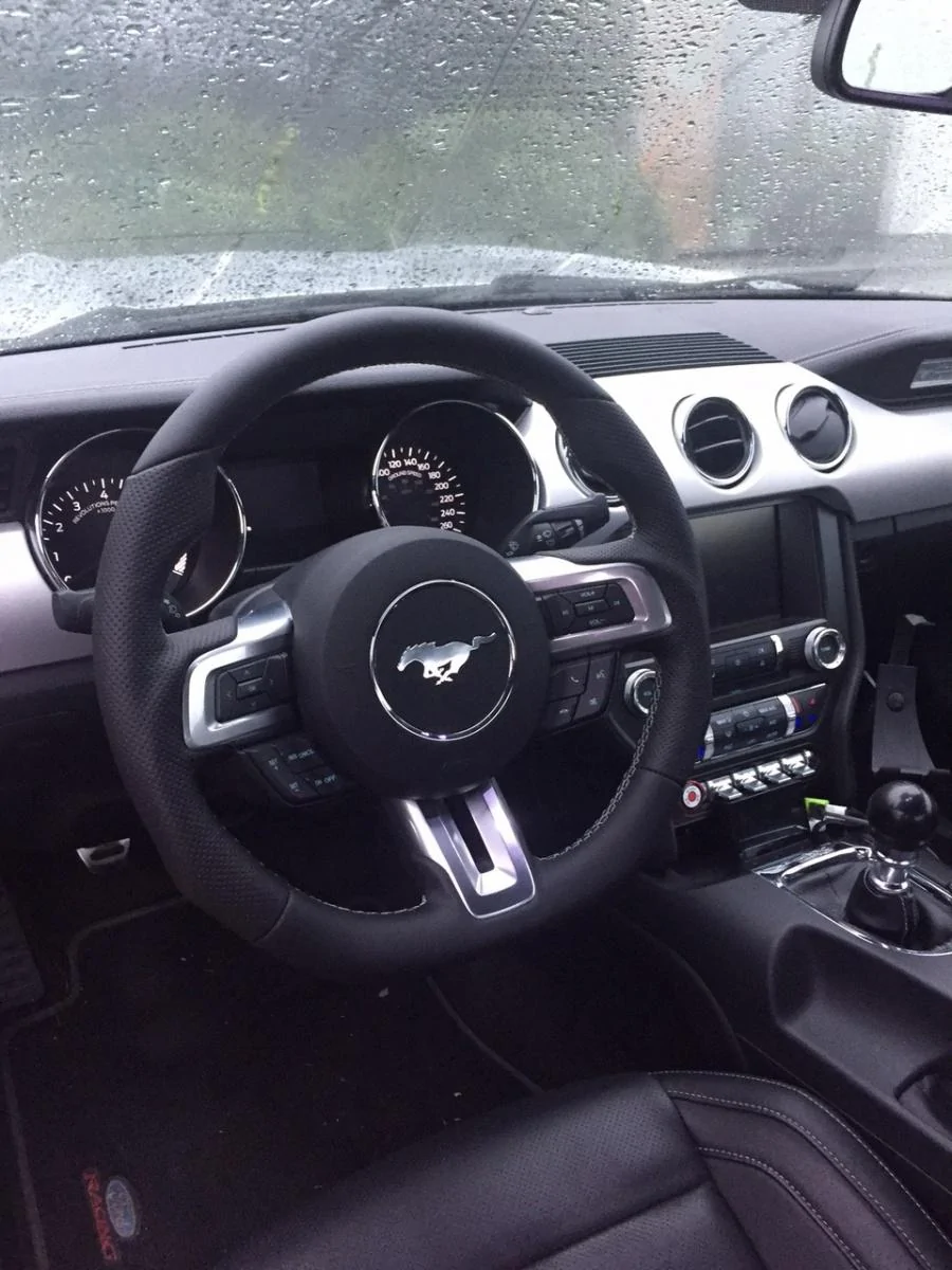

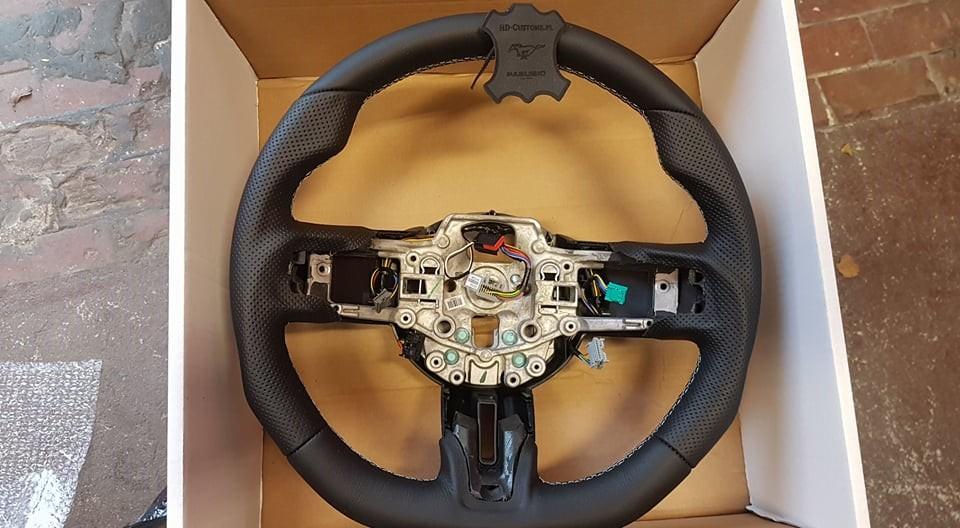

New MOD driving in from Poland, mounting planned next Thursday...

It's gorgeous. I ordered one as well, so it wouldn't surprise me if your current steering wheel will end up in my car :)

More info please :)
Edit: I noticed the website reported on the leather label, great job Pawel :D

Should be in tomorrow, I'll get you my first impressions on the finishing but on the pic it looks indeed great !! After his lights his steering wheel... :headbang:

Results once installed...

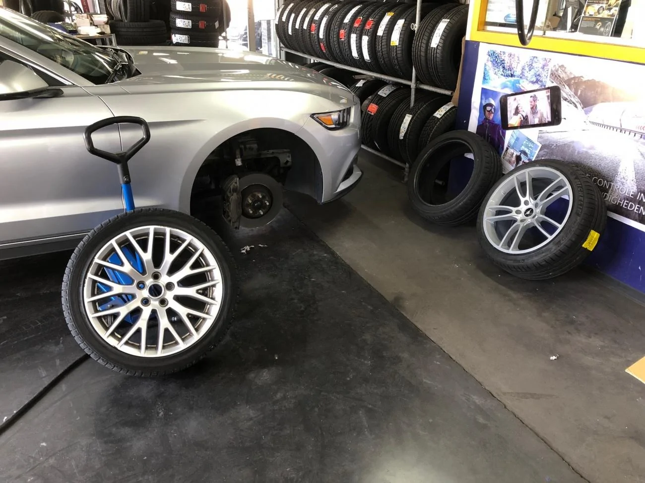

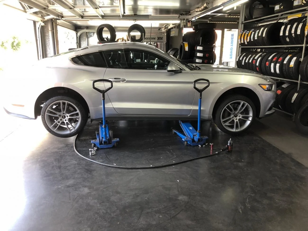

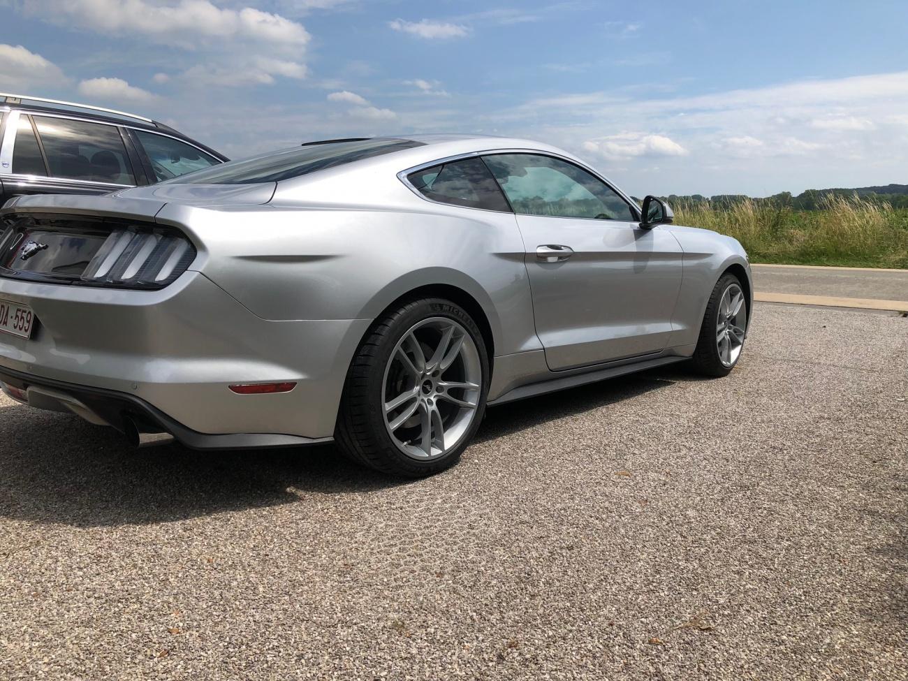

It has been pretty calm since the steering wheel upgrade in November last year. Time for a new add on !! WHEELS !!
I finally picked the MRR wheels M600 (Ford GT replica) and think they fit quiet OK on an ingot...

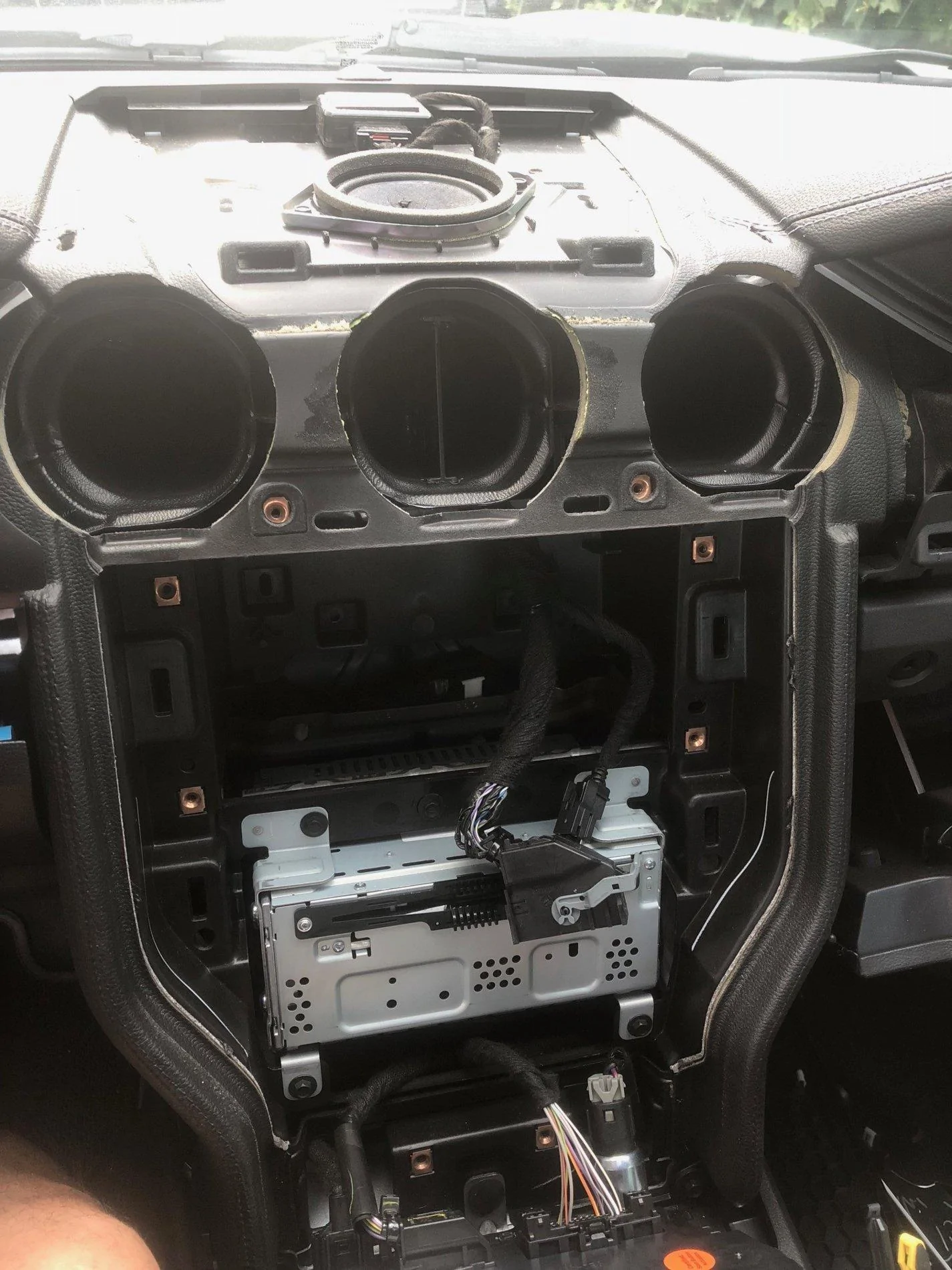

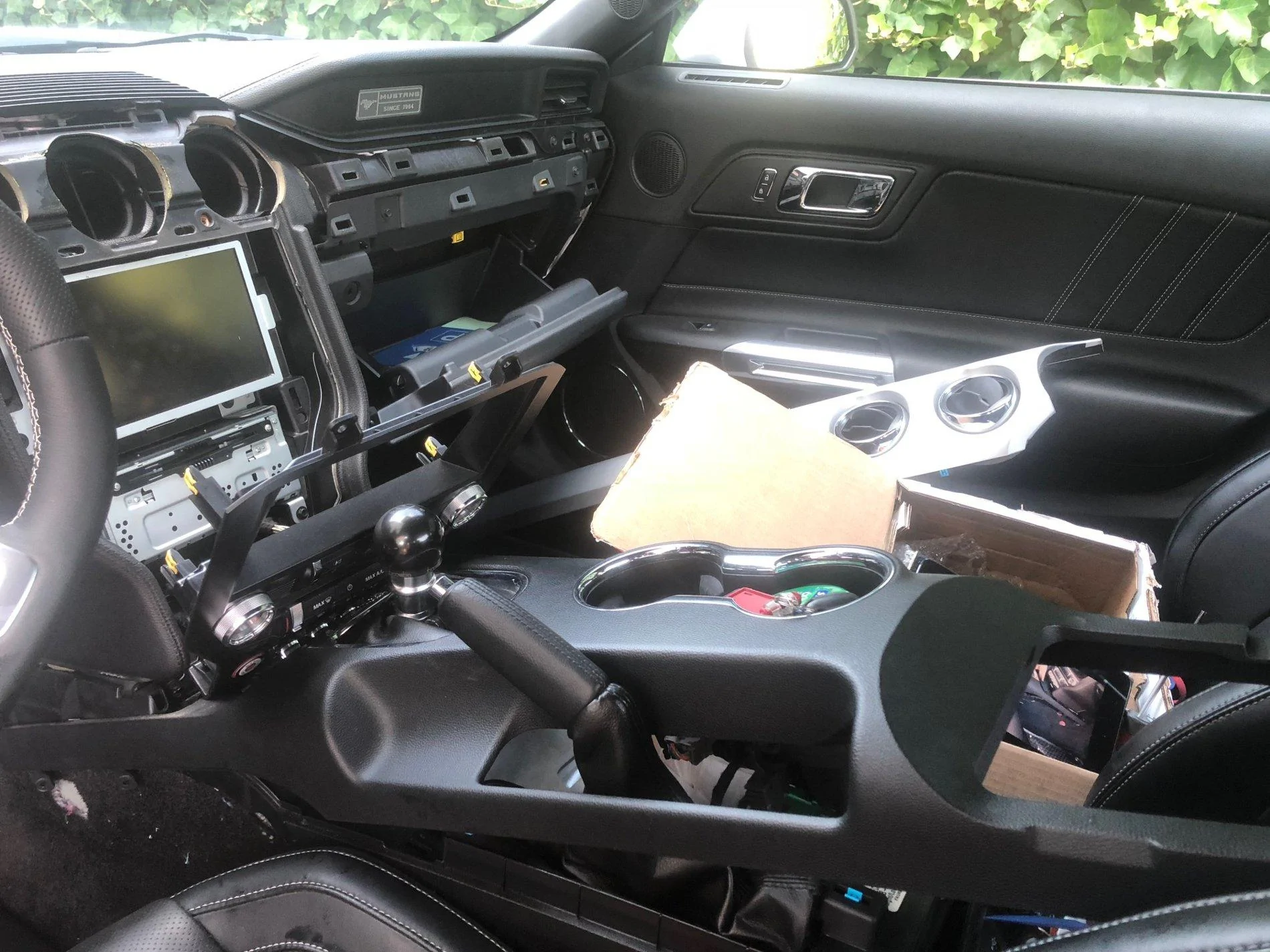

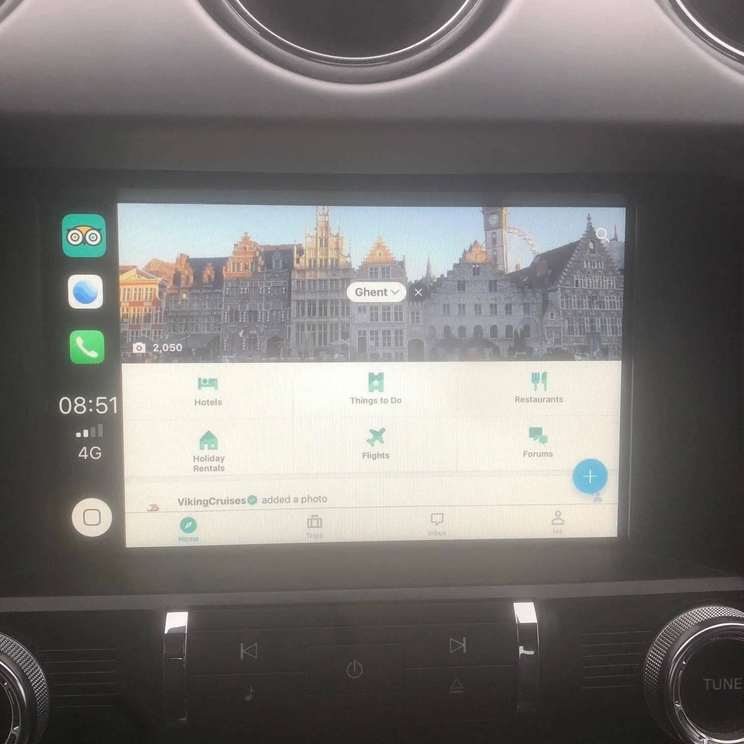

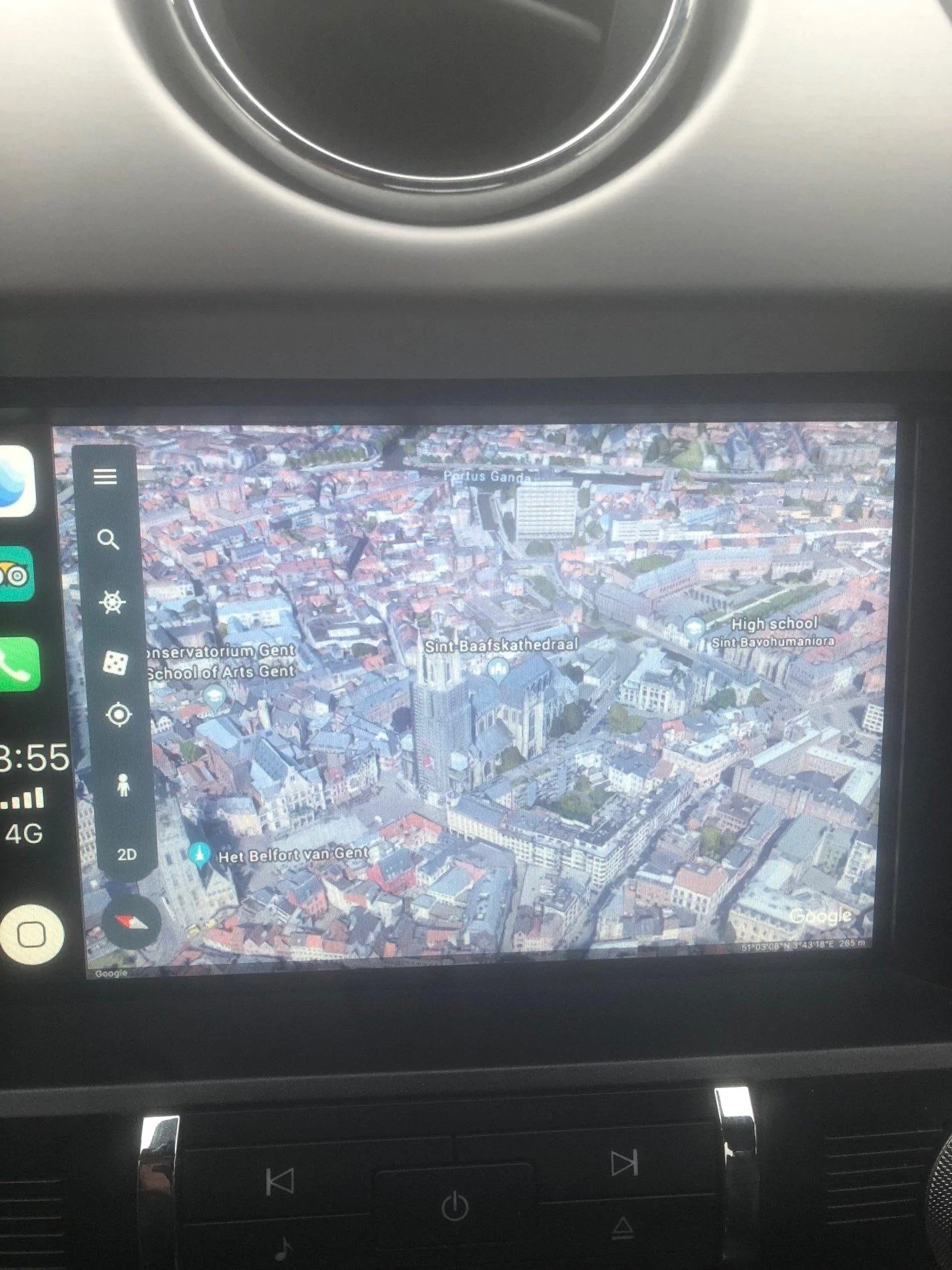

I saw Carplay and especially the Jailbroken Carbridge version which made me decide to swap Sync 2 for 3.
Found a unit in Dubai and install was simple.

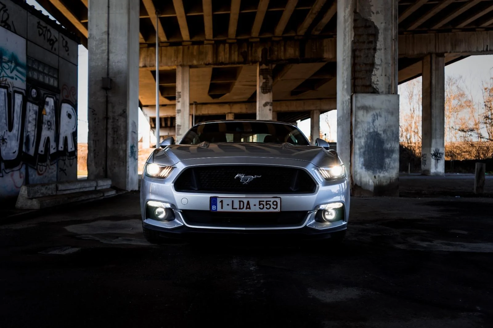

Next, last LED upgrade in the front of my Car. Installed the Osram LEDriving DRL/FOG set !! Mind blowing !!

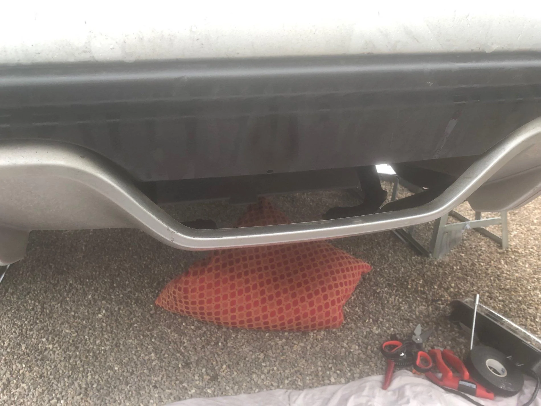

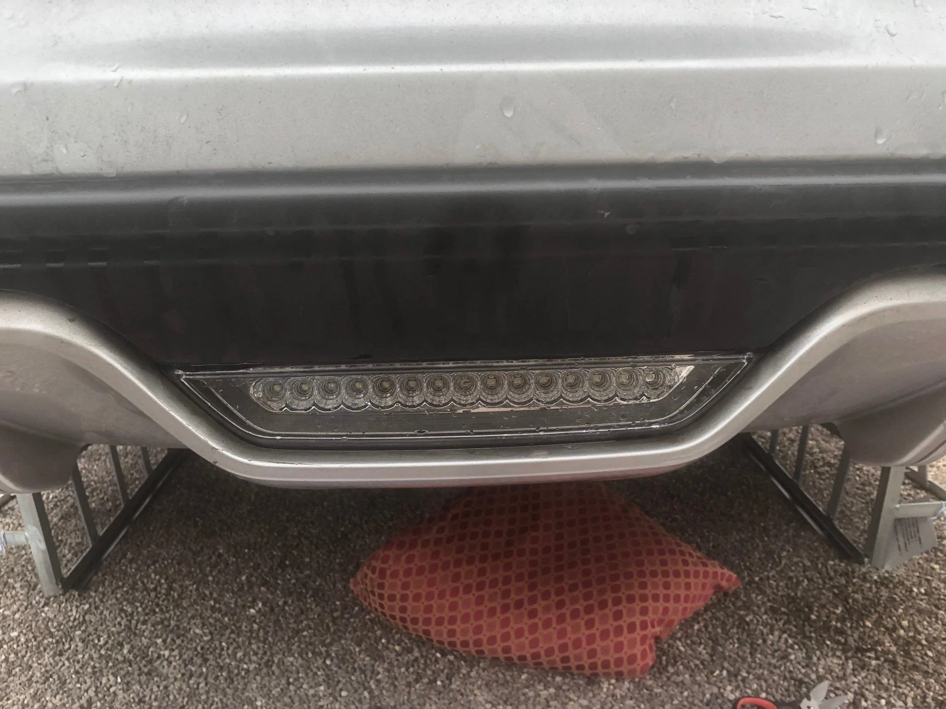

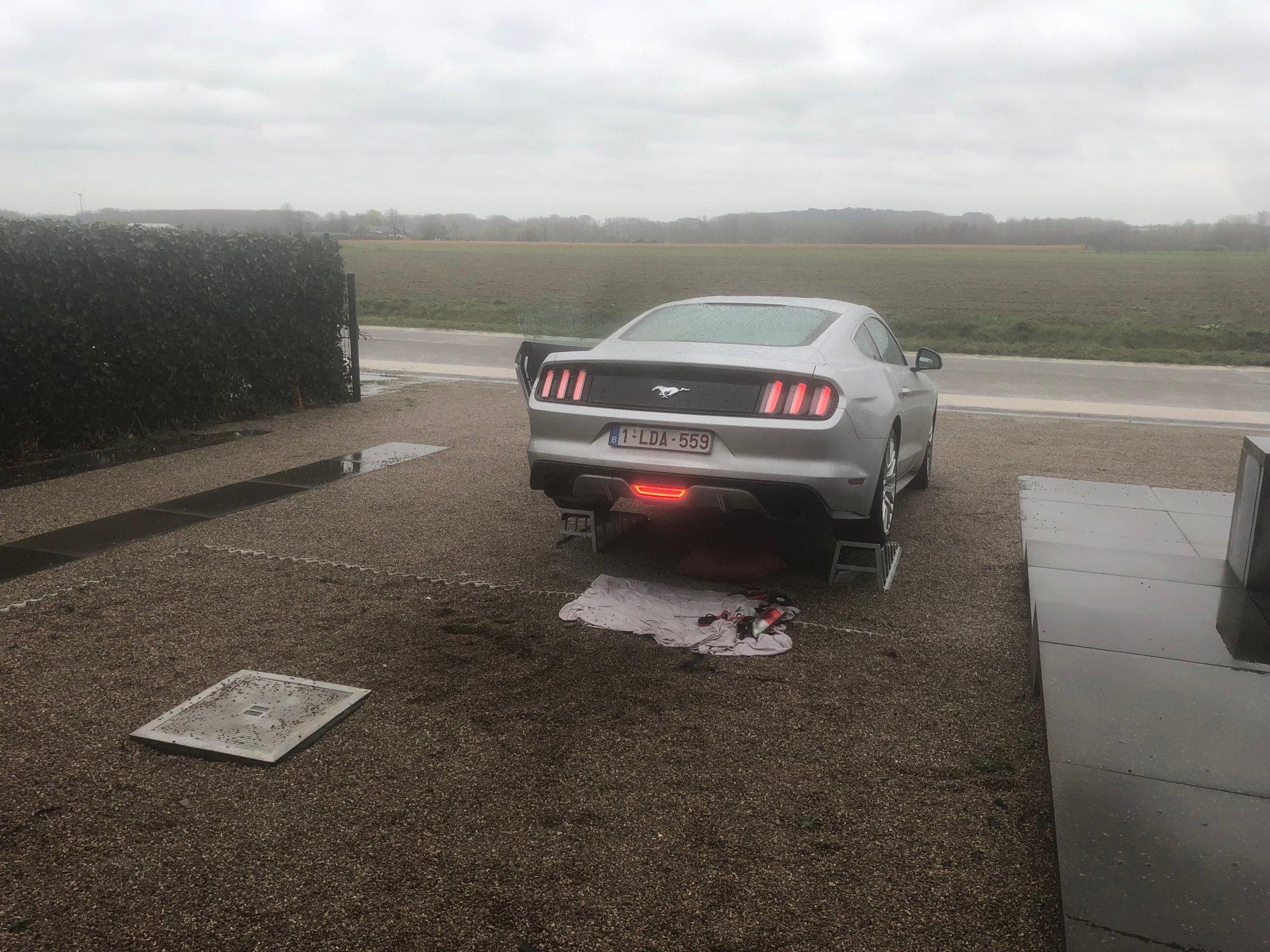

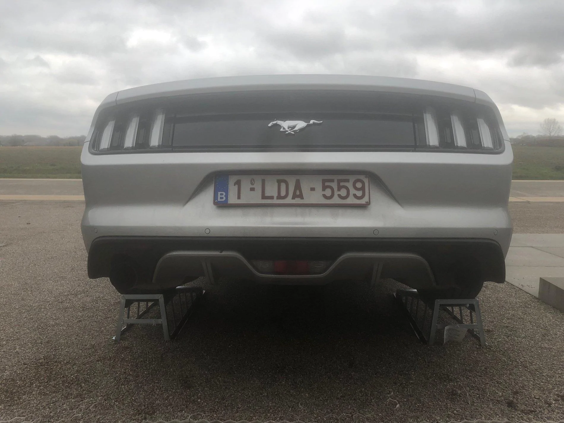

FInally I got rid of the ugly rear Fog light !
Swapping Sync 2 to 3 was easier. The 2 upper bolds are kind of inaccesable.

OP, nice upgrade this LED fog light.
But is it reverse light also (white LED)?
Yes and very, very intense, hard to take a good pic..

Where did you get this light?
Is it Plug&Play (except the problem with inaccessible upper bolts)?
Any modifications needed on electrical connector?

They are from IJDMtoy. Got it from a forum user who sold his mustang.
Bolts are indeed a nightmare, you'll need a 7MM inbus from medium length. My initial one was too long.
Have no idea if the original plug (if there is one) will fit. If there is one and it doesn't fit, just cut the original mustang one...
I Got it without plug: 4 cables and just used wago clips for 3 cables, I don't use the 4th brake light function (4th cable) as there is no cable in our EU cars for the brakes in the Fog cable set/plug.
The rear LED's are osram made and the white one is Xenon.
