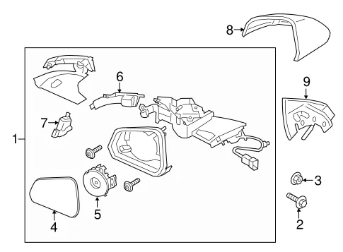

Does anyone have any idea how to replace the turn signal lamp assembly in S550 side mirrors?
It's part #6 in the image below. It does NOT just pop in/out.

That's a huge help, actually. Thank you!
Once the pieces of the mirror are apart per the video, plus the mirror cover is removed, the lamp drops right out.
