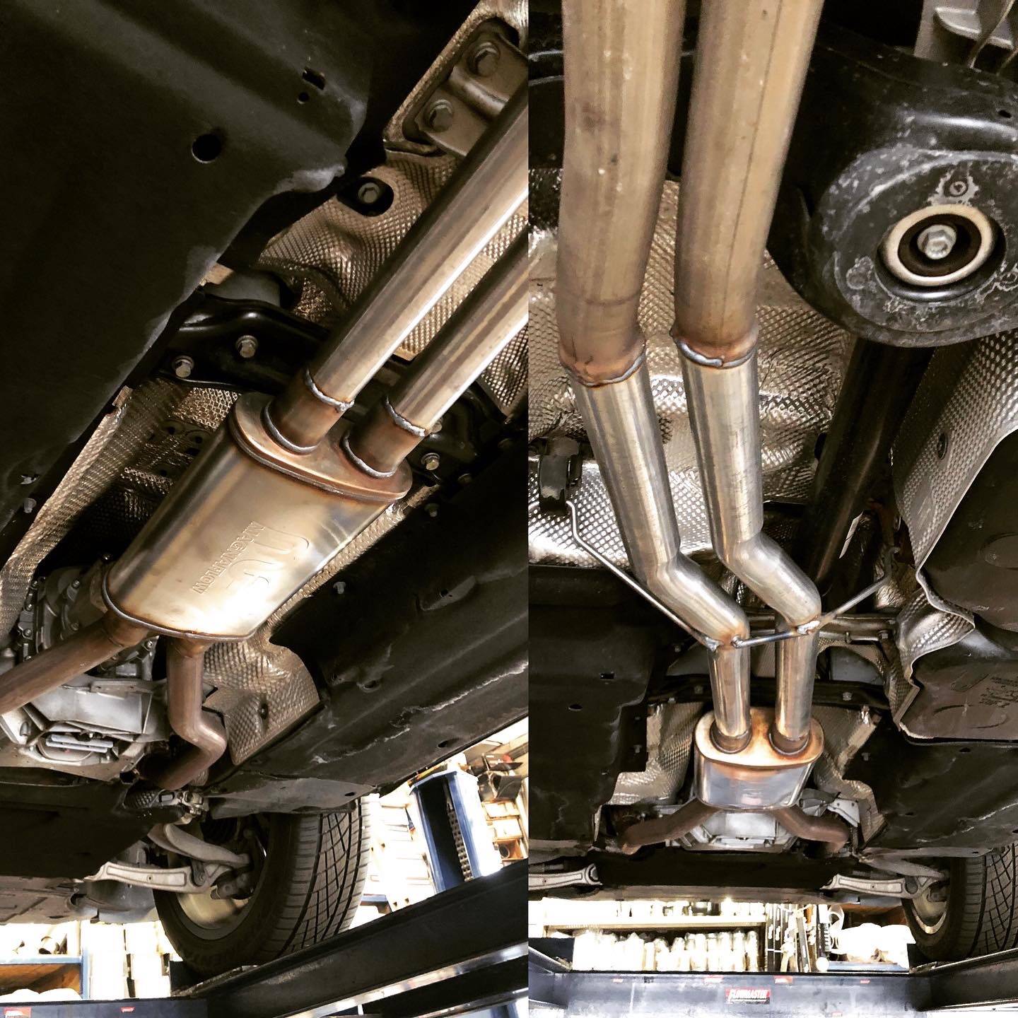

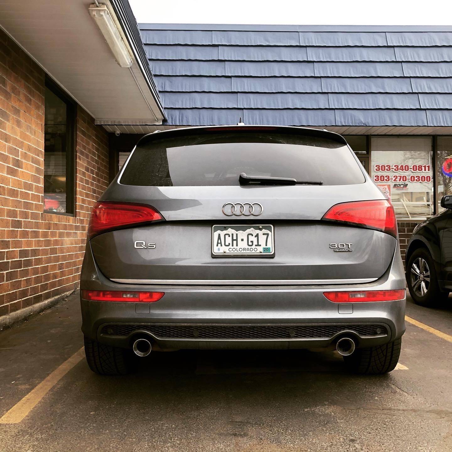

Threw an exhaust on my wife's daily, figured I'd share here too.
It's a 2016 Q5 3.0T
It's basically an SQ5 in sheep's clothing.

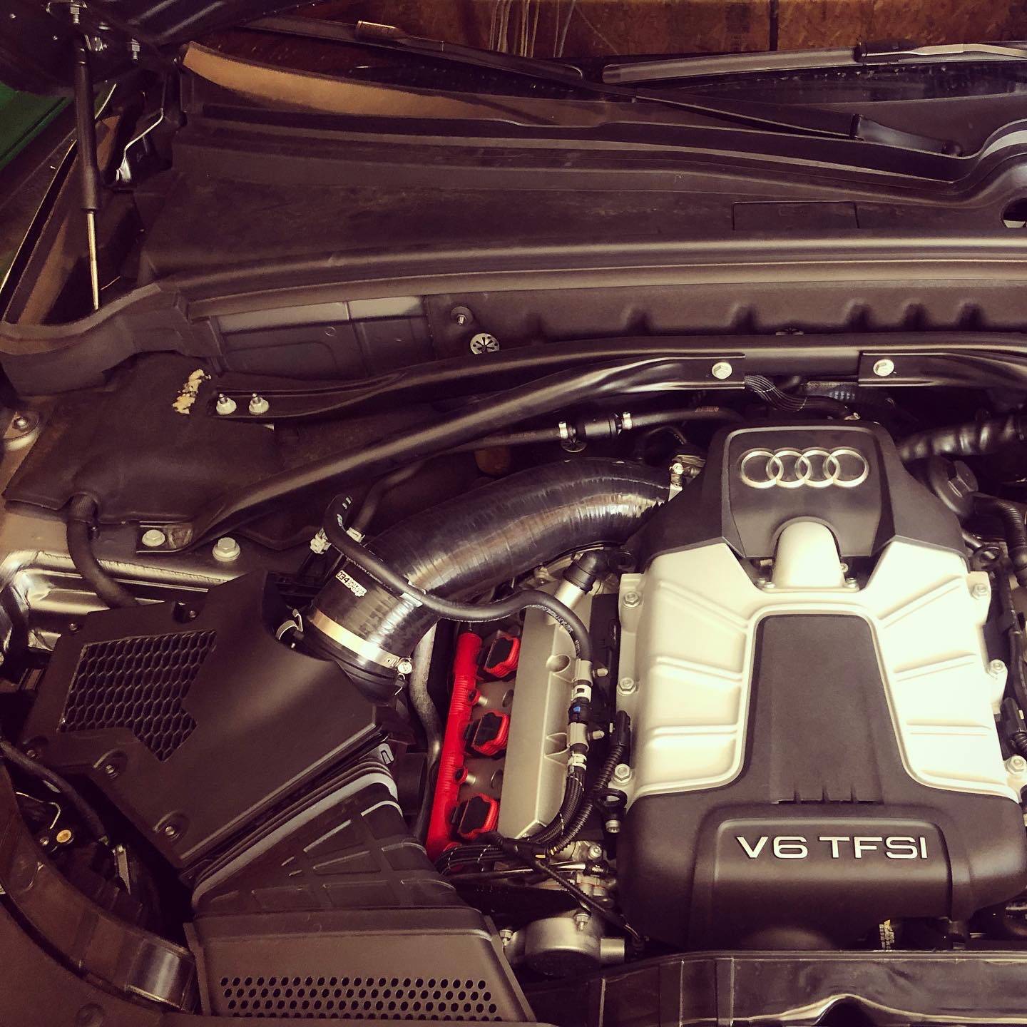

The engines are 100% identical with the normal Q5 just having a different tune. (Audi added an electronic bypass to the TVS blower so they can electronically control boost in different applications).
Our Q5 has the sport package so it has the SQ5 seats and paddle shifters. The only actual difference is our car has 345mm front rotors with 4 pot Brembos and the SQ5 has 380mm front rotors with single piston floating calipers. Other than that the only differences in the cars are on the exterior and cosmetic.
As far as power goes, the Q5 3.0T makes 272hp stock (SQ5 is 354hp).
Ours should be somewhere around 415 at the motor though.
I'd love to answer any questions!
Mods:
EPL Stage 1
034 Motorsport Intake Pipe
AFE Filter
RS7 Mod Airbox
Magnaflow 11385 Resonated X
(Baby Resonators & Mid Muffler Deleted)
