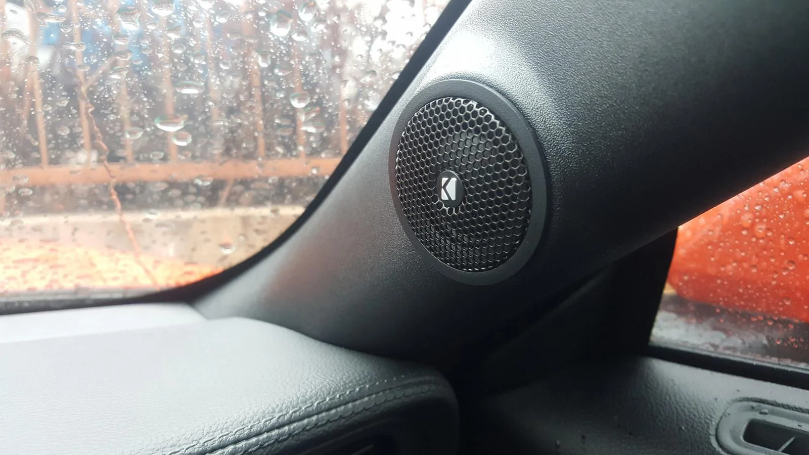

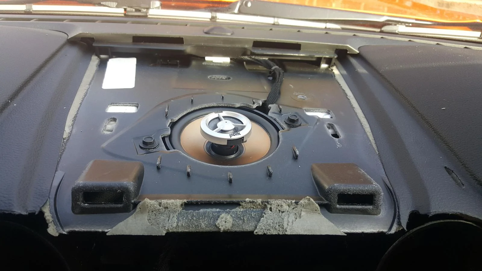

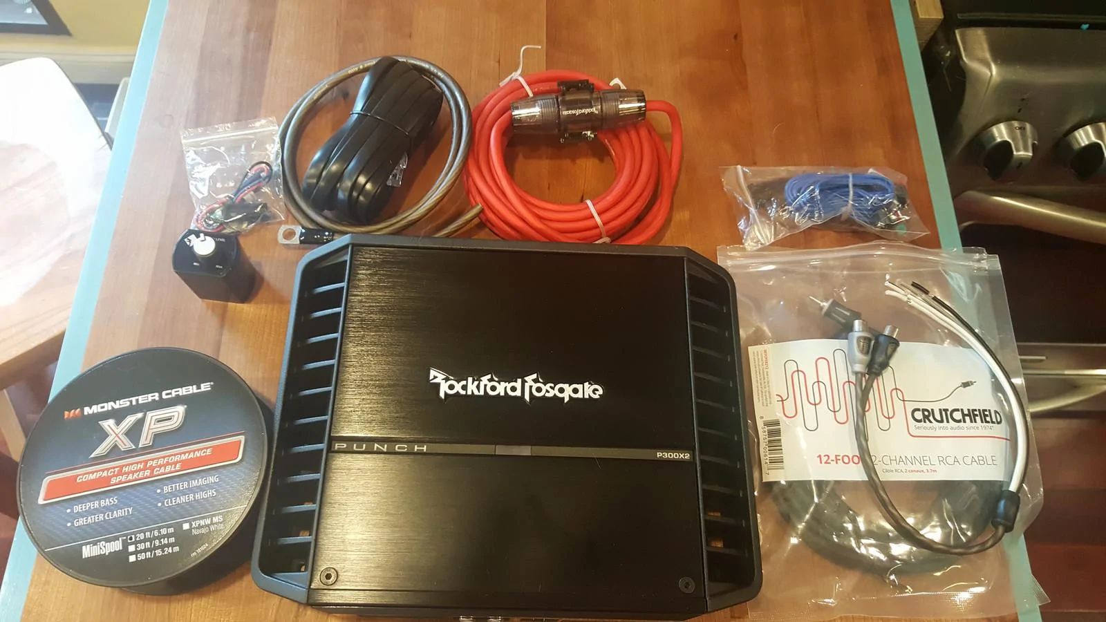

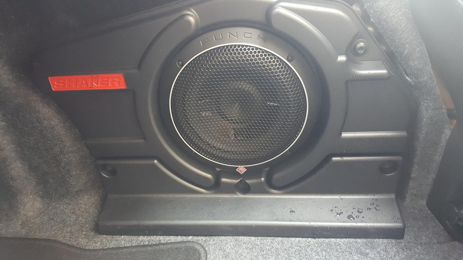

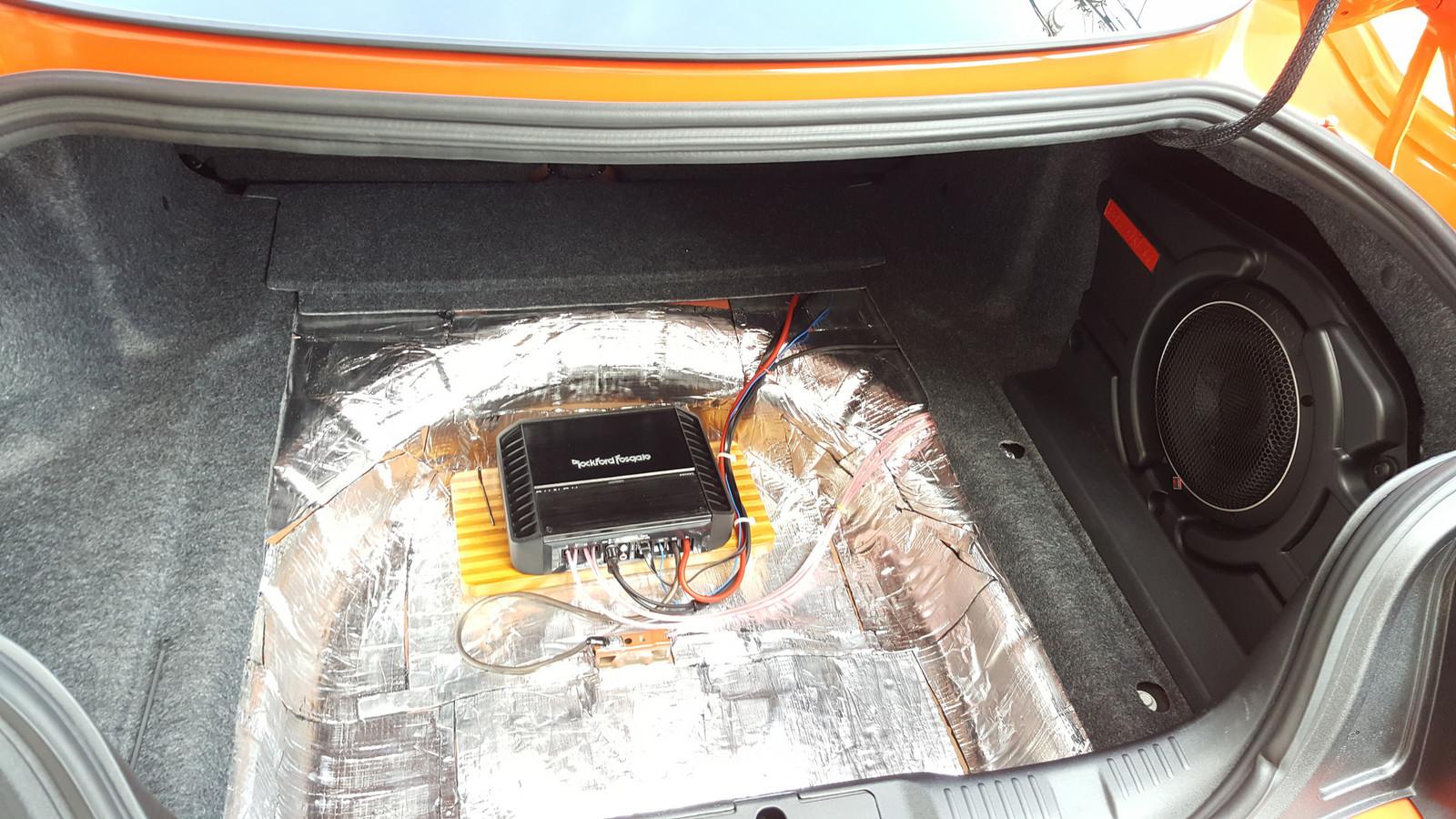

Cheapest and easiest upgrade for the pro system:
Replace the sub speaker, trash the factory sub amp.
Add a dedicated sub amp
Replace the pillar tweeters
Replace the center speaker
Huge difference in highs and lows, and unless you are a true aidiophile, it sounds great.
$600 max.
