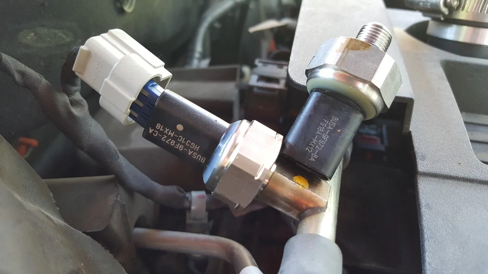

FWIW, the 18s are different from the 15-17 cars PCM wise and that's what's taking Cobb and some of the others longer to release their software. To my understanding, it was like starting over new. I'm curious as to whether Ford did anything different within the new calibrations to account for the failure. I'm going to try to do some digging on that and see what I can find out. When/if I do, I'll make sure to update everyone on here.

Ordered my sensor from eBay a few days ago. Didn't even look at my stock one to see if it's the old one. Nor did I try to monitor it to see if it's on its way out. Cheap piece of mind.

Hope? Don't take things so literally. We have mounting evidence that if/when the older sensors fail that they cause a disasterous set of operating conditions.

I'm data driven too. That's why I went to the trouble to retrieve my old sensor and test it. Multiple tuners have posted datalogs of exactly what happens when the sensor fails. I have my datalogs of what happens when the sensor fails showing both the hpfp dropping pressure and the car leaning out. What other data source is required when you have the data from the actual car itself?
I understand people wanting hard data. I don't act on opinions either, but I guess I fail to understand what more people want. We aren't going to get a letterhead from Ford confirming the issue, so all we have is what we've acquired. I can trust the evidence and data of what I've seen. Others can choose as they please. No hard feelings.
I don't mean that to sound harsh or like I'm being rude, but I just don't know what more people want. If the people tuning your car cannot be trusted, then why is anyone letting them?

For anyone following this with a UK/Export-model stang, I've got a 2016 EBM (RHD) it had the "old" sensor. I've bought the new one and i'll report back when it arrives (next week) - $42 all in (Inclusive of shipping and taxes).
FWIW - My current one wasn't failing, wasn't even close to it actually. never broke over 90psi (only when letting off after wot it spiked to 109, and lowed at 45)

My car is a 2017 EU spec EcoBoost. My sensor was not failing either, but it was the old type and I acted proactively by ordering the new version. $23 (20 euros) was all I paid, because I sent it to a friend of mine in the US who is coming to Europe in June. It's very easy to replace, so there is no second thoughts here. Better safe than sorry.

man screwing mine out totally chewed away the threads! it was completely bound and there was no going back, hopefully I can get a new fuel line fast..
used the 12mm and the 24mm as instructed.

Part number for the line?
law242
Nov 24, 2016
135
Arizona
2015 Mustang Ecoboost Premium
I am under the understanding that it is part # 9J280A
