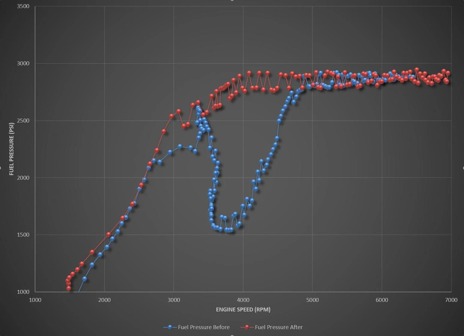

Just got an email from Cobb ... :cheers: "Must have been that low pressure fuel Sensor....:headbonk:"
COBB TUNING
2015-2017 FORD MUSTANG ECOBOOST MAP UPDATES
WHAT DID WE UPDATE?
Our Reverse Engineering team dove into the "Ford Matrix" and uncovered some issues within some of the factory ECU logic. The problem actually exists even within the stock calibration but becomes more prevalent when trying to increase power on all of the EcoBoost Mustangs.
We discovered a weakness in the OEM control strategy that reduced HPFP capacity at high fuel demand. After some code revisions and testing, we were able to sprinkle in some custom COBB magic and resolve the problem. This fix will allow the EcoBoost Mustang to maintain higher fuel rail pressure and deliver more fuel resulting in more available and reliable power on the stock fuel system.

The graph above shows two 3rd gear pulls of a 2015 Mustang AT with our Stage3 kit. The difference is obvious but the experience behind the wheel will vary from car to car based on a few factors. The blue data points represent fuel pressure behavior prior to the latest updates. Despite the big drop in fuel pressure, with quality 93 octane and the relatively low elevation here in Austin, the car would often still continue to accelerate without any immediately tangible signs of a problem based purely on feel. But of course, just because you can't always feel something wrong from behind the wheel, doesn't mean there isn't an issue. Which is why data like this is so important. Identical testing in other areas with higher elevation and lower fuel quality would produce misfires and general problems making consistent and safe power. The red data points show massive improvements that will be beneficial for all cars even if you have not personally experienced any issues to this point and is absolutely vital for those looking to push the car beyond the very basic bolt-on modifications.

I would say this is why the FP tune was updated to remove the dip in power around the same RPM...

The problem actually exists even within the stock calibration but becomes more prevalent when trying to increase power on all of the EcoBoost Mustangs.​
These cars have been around for long enough that I think Ford would know about this kind of problem. Makes me wonder if the behavior is intended.

Yeah I got the same e-mail we will have to see if COBB has taken the time to speak to Ford directly about this, and see if there is a stock strategy update by Ford as well as the power pack tunes from Ford Racing.
[MENTION=31737]TorqueMan[/MENTION] That is not always the case, there were shift issues with the 6R80 trans when first introduced into the Mustang lineup and its just one of those development things that gets found out later and patched like pretty much anything that runs software. It is possible that through Ford's attempt at torque management that it was intended, but it could be a contributing factor with some of the failures in the early models too which were not something that at first glance was an issue.
We will see. I am going to update later and see how the stage 3 93 runs from my AP compared to my Tune+ latest. Not sure if this is new, news thought.
