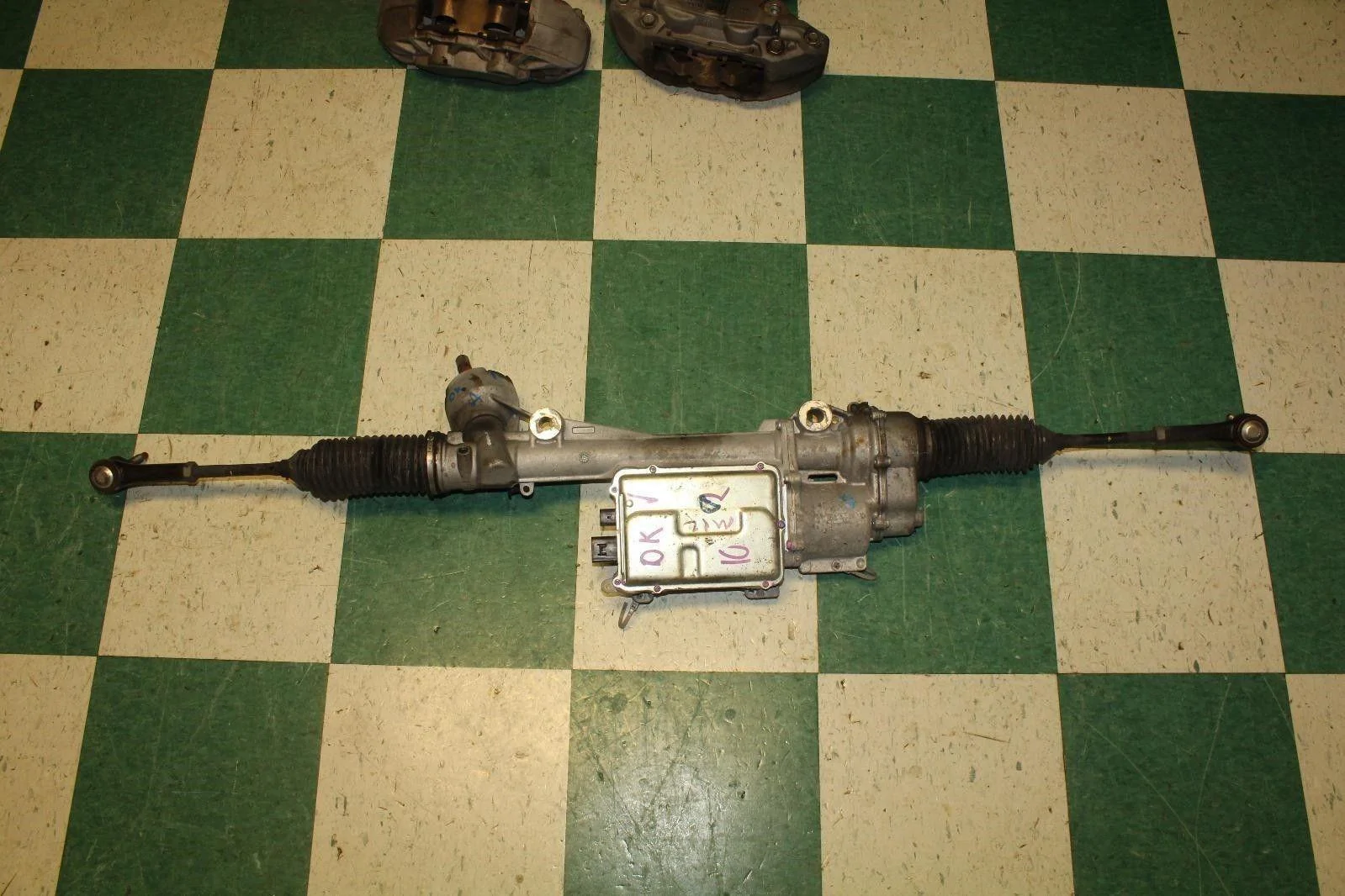

I just got a few pictures from the steering rack of the car. It seems that we do have a motor that could possibly control the steering wheel! I met another guy that is trying to do almost the same project with his car but he wants to remote controlling it (kinda like real R/C car). After talking together, it seems that we pretty much need to do the same thing and we are trying to work together to accomplish a little something. We've got some driving data that we are analyzing right now. (Many more to come lol).

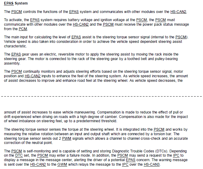

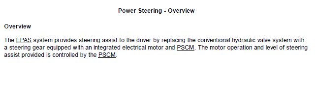

You're right. There's an electrical motor in the steering rack assembly. It's part of the power steering (EPAS).
