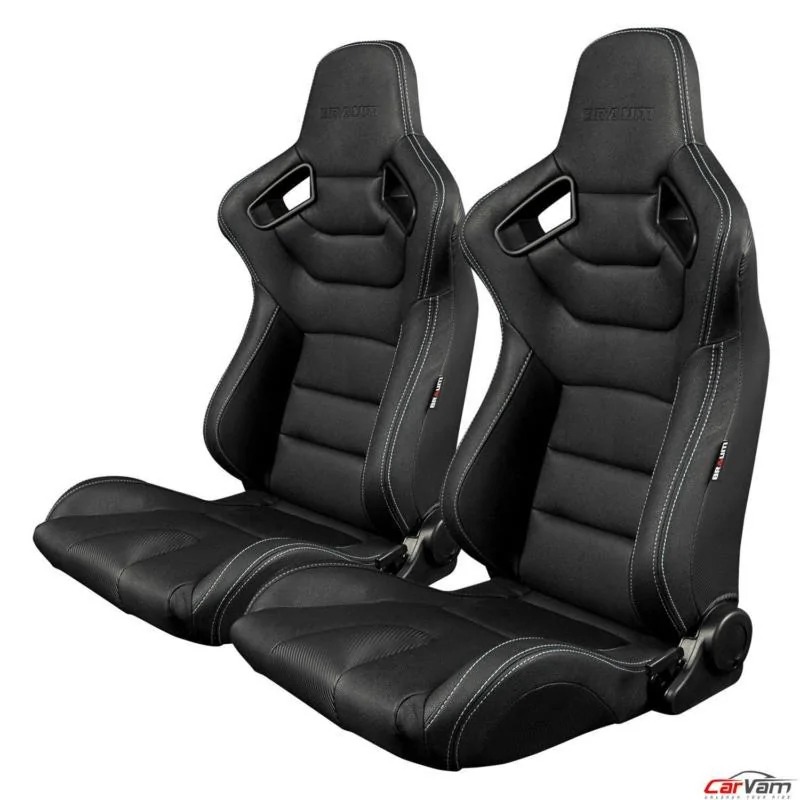

I have tried everything I can think of to find the best way to tolerate the discomfort. I have the lumbar inflated to a decent amount. I did that to keep my upper back from being dug into by the upper portion of the seat. I generally don't use lumbar because I like to be in the seat. With the lumbar I feel I'm angled out in a weird way.
Anyway, I've been researching seats and have found what I believe will be a good option.
https://www.carid.com/2016-ford-mustang-seats/braum-elite-seats-732671843.html
My question is, if I make this change, I read somewhere an airbag light or something will be lit on my dash? If so, is there any way to clear that?

I hate these seats too. Power seat should have power recline. I can never get it adjusted where I'm comfy, always too erect or too slouched. They get even worse on long trips.
Just my .02, but your airbag light will be on because there are airbags in the seats. Is it really worth sacrificing your safety? It's one thing to just delete an airbag, but since the other safety components are designed with that one, you may be worse off with one bag missing and the others still in place...these things are basically little bombs and engineers walk a very fine line to make them increase your safety vs. being even more dangerous. Maybe the OEM recaros would be better?

I knew I'd be missing the airbag but now that you put it that way, I will have to reconsider for the Recaro's. The cheapest set I found used is still a little under $2k. Stuff to think about now. Thanks for chiming in.

I have Braums in my 16 GT all you need is a 4 ohm resistor in the airbag wiring to trick the system into thinking nothing has been changed. and also transfer over the "bladder" from the passenger seat into the new passenger seat of the braums this is a bag looking thing underneath the factory seats filled with water its the sensor that tells the car someone is sitting in the passenger seat, this is the more important part. the light that you are worried about is just a light no big deal (you turn off the light with the resistor) driver side airbags are always on and will always deploy no matter what. it is the passenger airbag you need to worry about and this is fixed by transferring over the bladder.

3 or 4 ohm resister will work and on passenger you just short weight switch which tell system somebody is there, which means that bad will blow even when empty.
Those seat will need mounting plate and set of sliders. they will lower about 2 inchs
