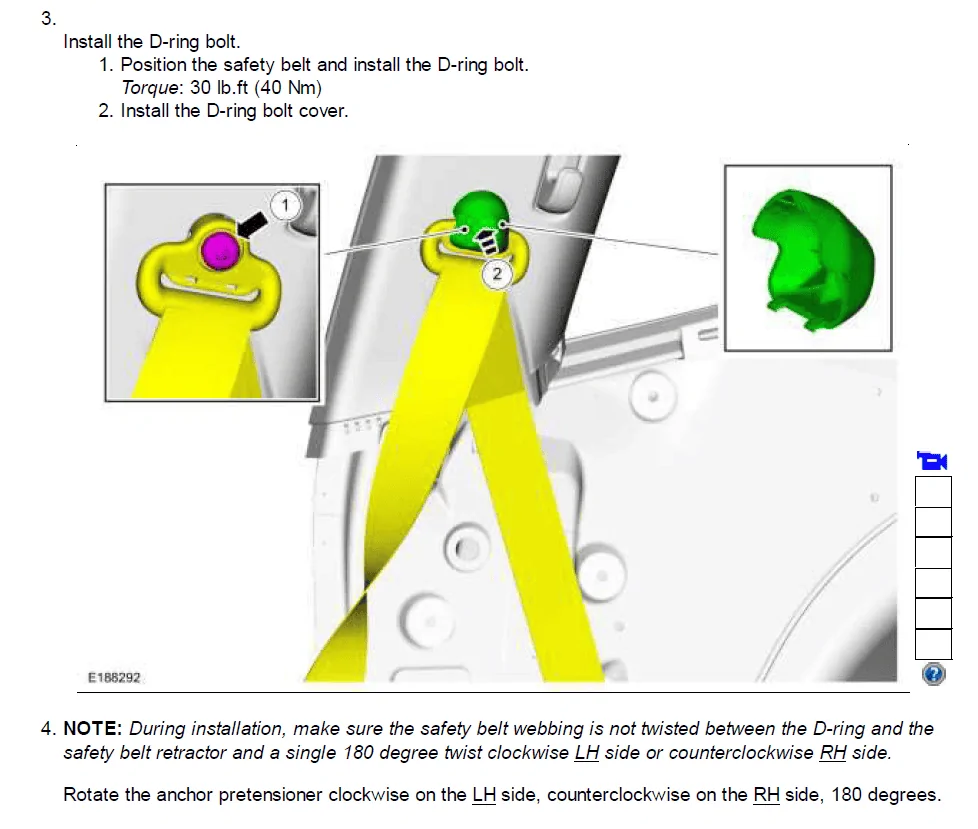

Sorry if this isn't related exactly, but I see a lot of torque specs shared here so I figured I'd ask.
I had to take off my passenger seatbelt at the upper mount to get at the airbag under the headliner, so I removed all the trim around the seatbelt/etc.
Can anyone tell me what I need to torque the seatbelt bolt back to? Thank you in advance.
StangTime
Apr 16, 2019
81
3,594
4,094
Ontario 🇨🇦
Todd
19' GT PP1 Manual

Thank you so very much!

@StangTime Where do you get these cut sheet service images from? Ford Service manual? I'm interested in having the entire car if possible. This seat belt one helped but I need the other 3 bolt torque specs that hold the seat belt in place too. Don't want to pester everyone if I can just buy the info for the S550.

@TonyNJ I got this info from the 2016 manual which is still quite relevant. Most of the info is still valid for later models. You can download it from my google drive here:

Wow. Thank you so much. I was immediately thinking of printing it.... then noticed almost 7000 pages. I have a 2016 R so that's great regardless. But yea, so much carried over through 2023. Thank you very much.
