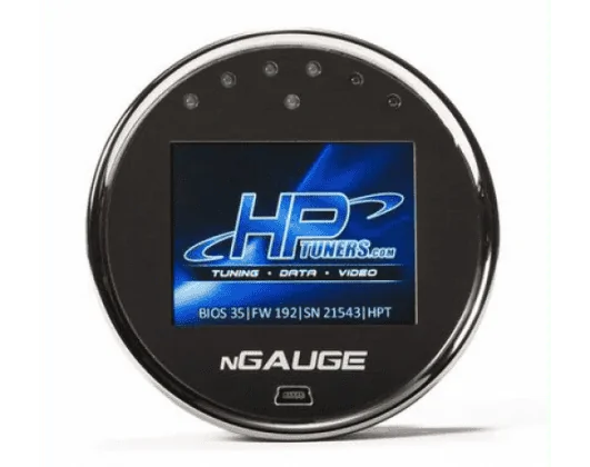

The X4 will indeed work on a 15-17 mustang with no issues. Have you looked into an Ngauge? We switched over to them on our last few project cars and never had a reason to go back to the X4. If you'd like more info on the Ngauge give us a shout and we'll be glad to assist you.
https://www.lethalperformance.com/e-motion-ngauge-tuning-and-monitoring-gauge.html
https://www.lethalperformance.com/p...d-custom-tuning-for-2011-2017-mustang-gt.html

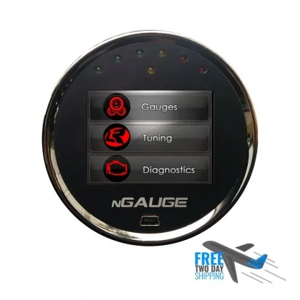

I get that you may be able to save some money by finding a used device however keep in mind you'll want to make sure that the device works and isn't locked to a vehicle. If it's broken or locked to a VIN then the money you think you were saving just cost you more in the end.
My recommendation again would be to go with a new Ngauge with custom tune from either Lund Racing or Palm Beach Dyno. Both of those guys will also recommend the Ngauge over anything else as it's smaller, easier to mount and easier to use for flashing/datalogging and monitoring diagnostics.
Let me know if you have any other questions.
Thanks!

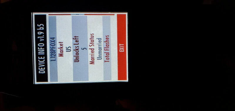

This is the device info. Is it a recent version?

You can update the firmware from your computer which you will have to more than likely. It states its unmarried which is what you want, meaning it's not locked to another vehicle. When you go to buy, plug it in quick to make sure it states unmarried and has at least 1 unlock left, and you should be good to go after a quick update and upload of your tune files. I had a 16 v6 with a x4, traded up to a 16 gt and the same x4 worked if that helps.
IMO if you can afford a ngauge get it. Its newer, faster, and easier to use. If your trying save a few bucks and are handy with tech than go for the x4.
