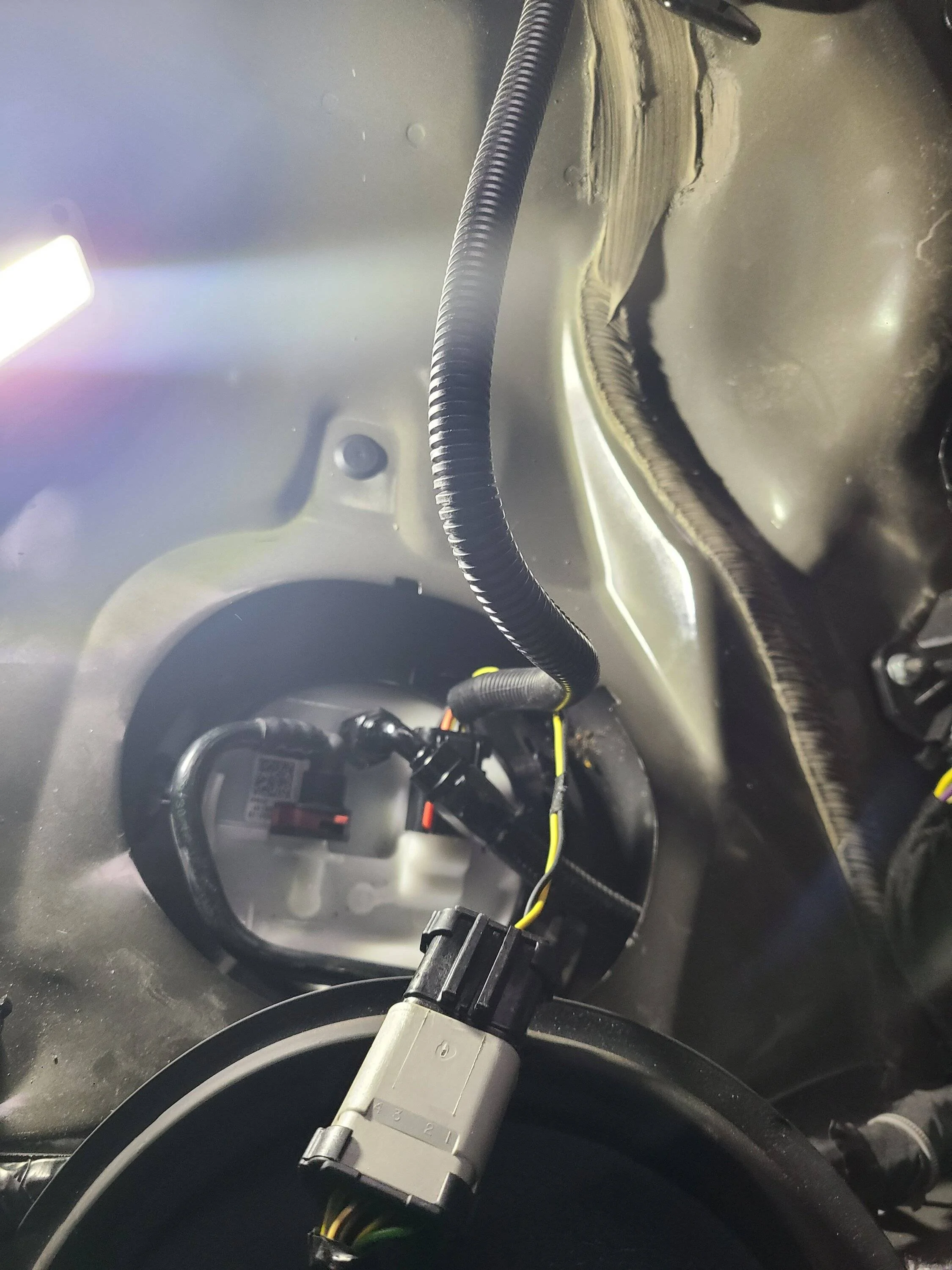

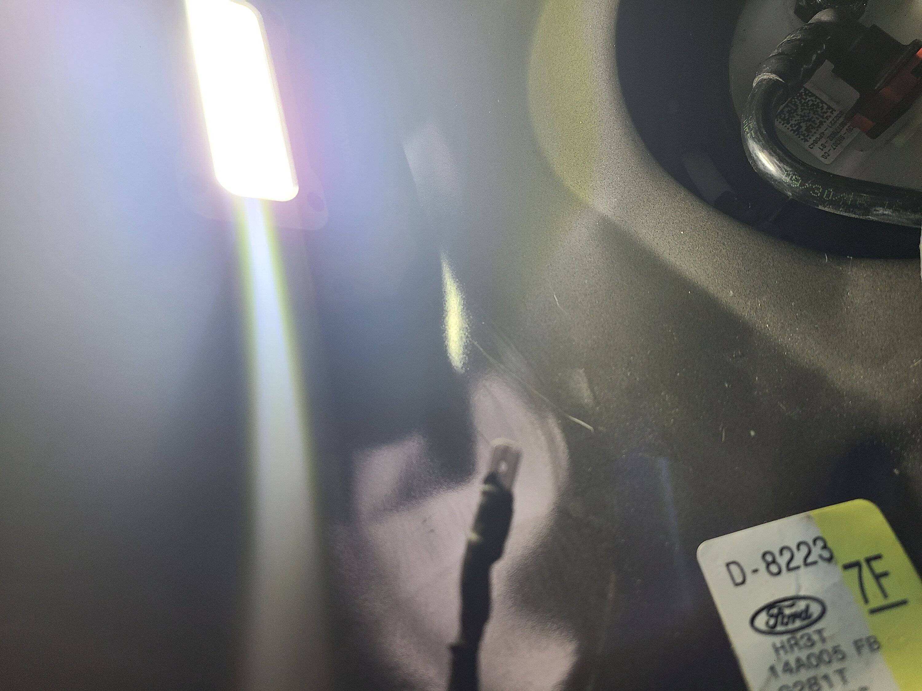

Was working on installing a sai li return on my 17gt. I bought it here used. I have everything together that was basically plug n play. Only thing left is those 2 blue wires. I know they say splice in but these two are connected together. Just wondering where those go and where I hook the vac line up to on the regulator

Not seeing any blue wires in your photos. The vacuum reference for the Pressure regulator needs to come from manifold vacuum. You will likely need to install a "T" fitting into one of the vacuum lines on top/behind the throttle body

That bottom pic has the 2 crimped together into that fitting
